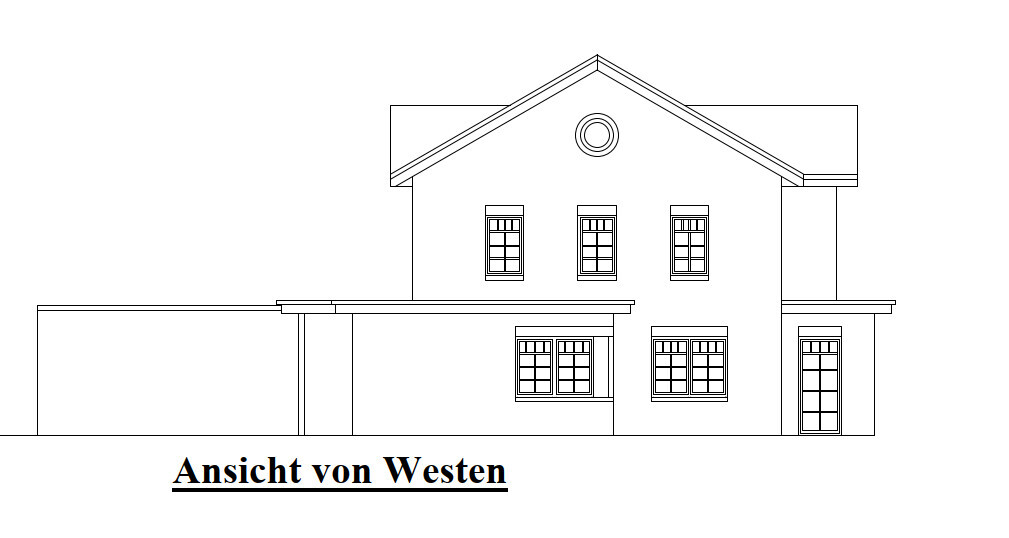

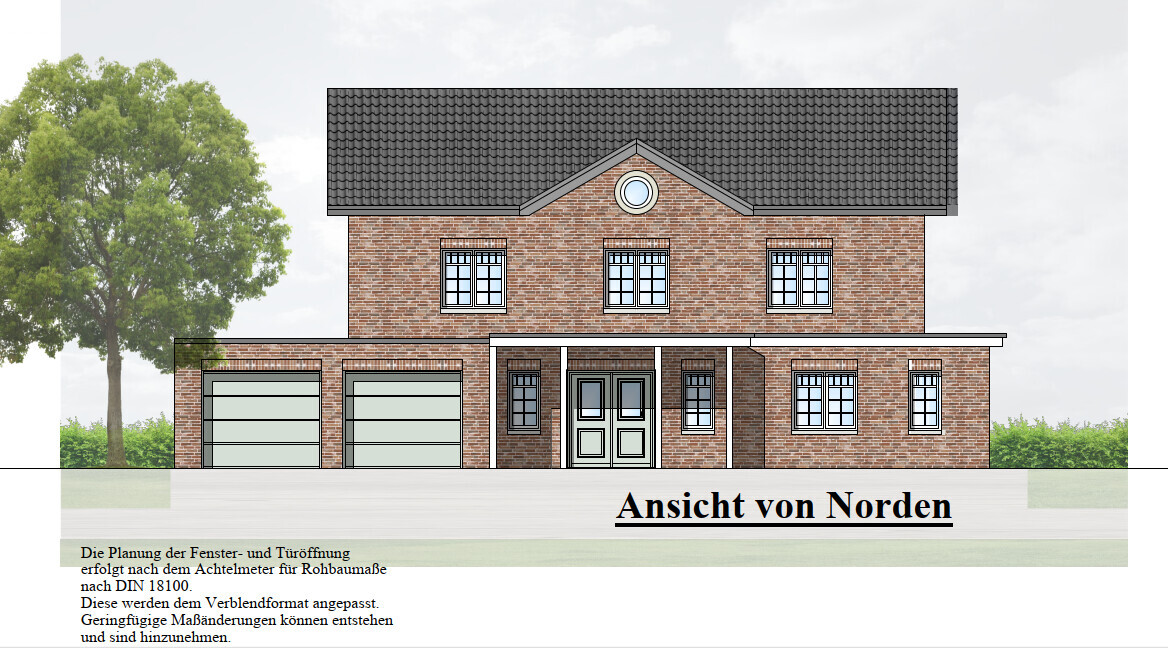

I consider this to be a two-story house... ah, you mean that all the increasingly expensive corners on the ground floor, which then require flat roofs, make it seem like a single-story.

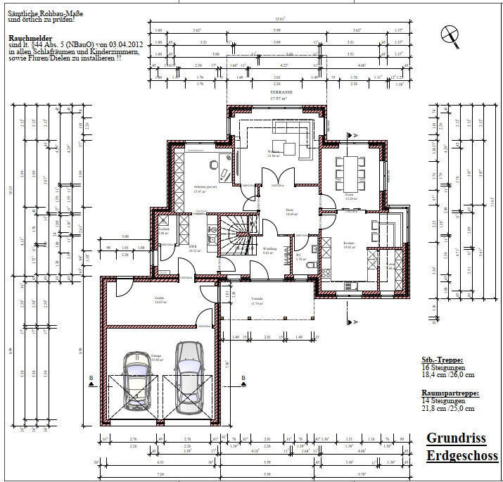

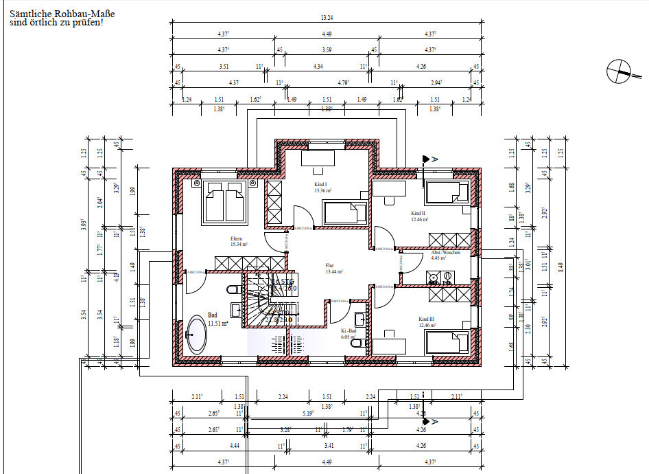

Unfortunately, the uploaded images are so low resolution that the numbers are barely legible.
But somehow, the floor plan of the ground floor looks very inefficiently used.
