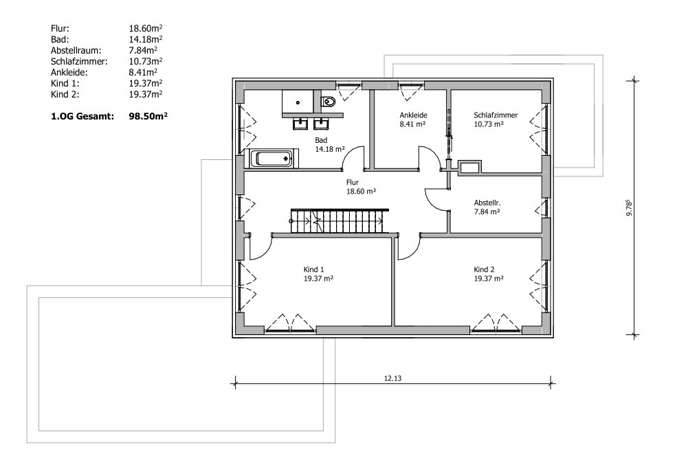

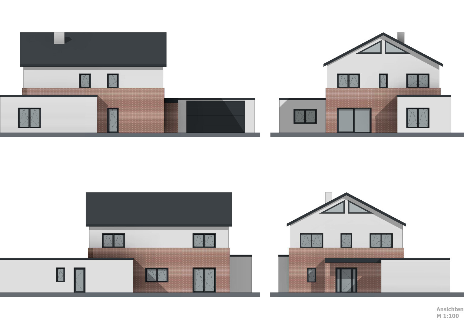

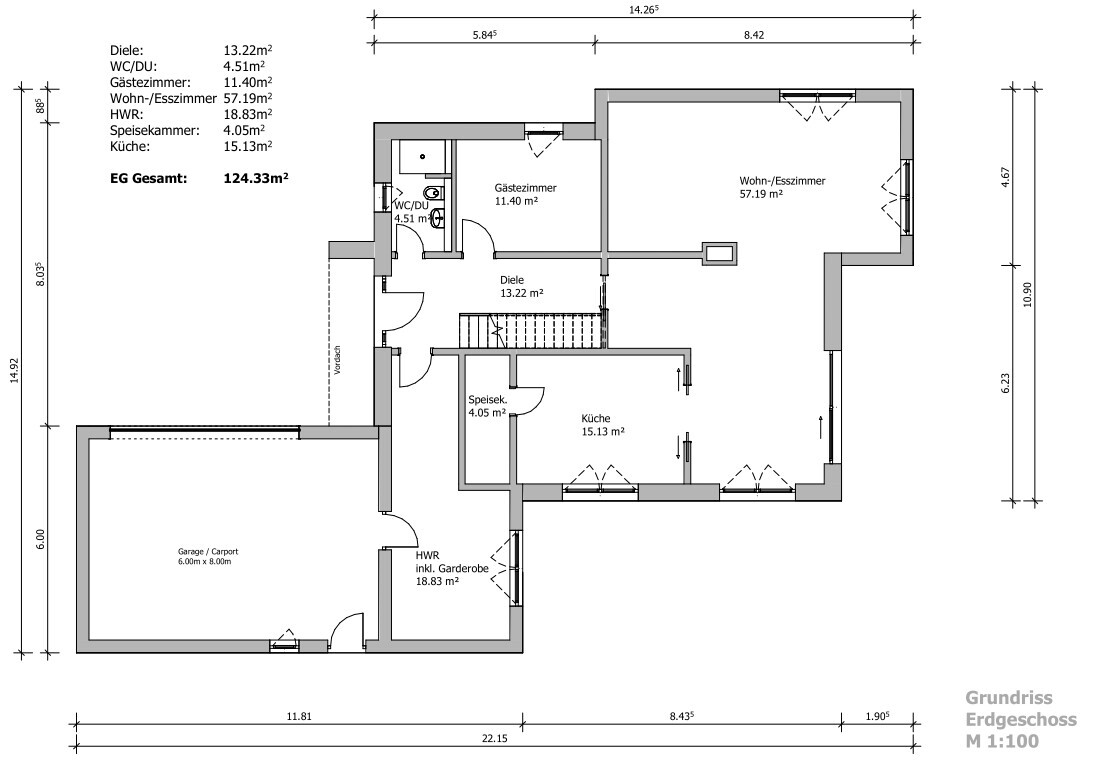

Dear housebuilding forum,
After much deliberation, we have decided to start our housebuilding project in the Hannover region. Following some disappointing discussions with various developers/general contractors, we tried to put our ideal plans on paper.
Development plan/restrictions
Plot size: approximately 1,800 m² (19,375 sq ft), not divisible or similar
Slope: no, flat
There is no formal development plan; after preliminary consultation with the permitting authority, §34 applies. Due to the surrounding buildings, approval for 2 full floors has been provisionally granted. The building must be aligned towards the street at the front.
Edge development: multi-family house
Number of parking spaces: 2 + trailer space
Number of floors: 2 full floors plus option to convert the attic later
Roof type: gable roof
Style: modern
Orientation: facing north
Homeowners’ requirements
Style, roof type, building type: simple, timeless, modern gable roof house
Basement, floors: no basement due to costs, 2 full floors
Number of occupants, age: 2 adults, 2 children
Space requirement: 180 m² - 200 m² (1,937 - 2,153 sq ft)
Office: occasional home office + family use as guest room
Guest stays per year: at least 10 - 15 nights
Open or closed architecture: ?
Kitchen type, island: prefer closed kitchen but with sliding door and small island
Number of dining seats: 6 seats
Fireplace: maybe, yes, as room divider to dining area
Music/sound wall: no
Garage, carport: garage preferred over design; could also be prefabricated garage or carport; implementation with later savings possible
Utility garden, greenhouse: utility garden for the family, but care might be an issue later due to size
Who planned it:
Do-it-yourself
Large utility/technical room, direct access to garage, L-shape in living-dining area, 2 large children's rooms, straight staircase
What don’t you like? Why?
Much wasted movement space on ground floor, want to optimize total area to approx. 180 m² (1,937 sq ft)
Price estimate from developer: 470,000 EUR without garage, painting, and flooring
Personal price limit for house including fittings: about 500,000 EUR without garage including additional construction costs, land already owned
Preferred heating system: air source heat pump
If you must give up on which details/extensions
Can you give up:
Smaller living-dining area, staircase form, reduce children's rooms to 16 m² (172 sq ft)
Cannot give up:
Large utility/technical room, large living and dining area including closed kitchen, partial brick cladding
Arrangement and orientation based on existing driveway and features we don’t like in our current rented townhouse (city villa 155 m² (1,668 sq ft))
What makes it particularly good or bad in your view?
It meets our wishes on paper, but we lack experience whether it can be built economically; possibly better ideas for layout of utility room including wardrobe and garage
What is the key/basic question regarding the floor plan in 130 characters?
How can I optimize living space for best cost savings? Is the floor plan feasible within our budget? Proceed with architect or builder?
I hope this information is sufficient; feel free to ask for further details.
Thank you very much for your support and honest, constructive feedback. And don’t hesitate to be straightforward.

The proposals received so far simply have not been satisfactory.We still cannot comment on that because it is not known. Normally, general contractor (GC) designs are discussed once the GC and their design already exist, so they can be optimized to fit the poster’s requirements. I assume the design is not necessarily bad and works; it just doesn’t fit your ideal vision.Jens 1985 schrieb:
Adjust your tone accordingly, start over completely from the beginning.But first, present the alternative(s) and explain what was found unsatisfactory about each one.https://www.instagram.com/11antgmxde/
And then try to implement the furnishing wishes in the intended rooms. The dimensions are missing in the floor plan, but for example, I don’t see an island in the kitchen area.
The pantry is a narrow corridor, where a freezer or something similar can only fit at the bottom or top of the plan, but not along the long wall.
There is a lot of square meters for the living/dining area, but furnishing always seems to be a bit of a challenge.
The children's room faces northeast.

Even if it’s just about the matter at hand, some comments have little to do with the actual topic.I completely agree with you. Unfortunately, the topic is often changed entirely without relating back to the original question.I would like to share a few fundamental considerations from me/us as suggestions for your upcoming, likely new planning phase.
A straight staircase requires the most space, especially concerning the hallway. You need to be able to fully walk around it on both the ground floor and the upper floor. With a quarter-turn or half-turn staircase, you might be able to optimize or reduce the hallway space somewhat. We even planned less than 4m² (43 sq ft) of hallway on the upper floor because I’m mostly just passing through to the bedroom 😉
Your bedroom should be approximately 3m x 4m (10ft x 13ft) to comfortably fit a bed with bedside tables including circulation space.
Cooking, dining, and living areas work starting from 30m² (320 sq ft), feel spacious at around 40m² (430 sq ft), and become luxurious from about 50m² (540 sq ft), depending on the individual walls and room layouts, but this serves as a rough guideline.
Wet rooms become exponentially more expensive as they get larger, so it makes sense to question every square meter carefully (this applies to kitchens and bathrooms).
And last but not least…
Don’t plan your house first and then look at the plot; do it the other way around.
What view do you want from the kitchen/living room windows? Where should the terrace be, and from which room do you want to access it? Is there a slope on the plot, attractive neighboring buildings, or a noisy street or industrial area on one side?
These considerations can shape a lot before the first line of the floor plan is even drawn.
