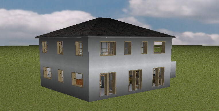

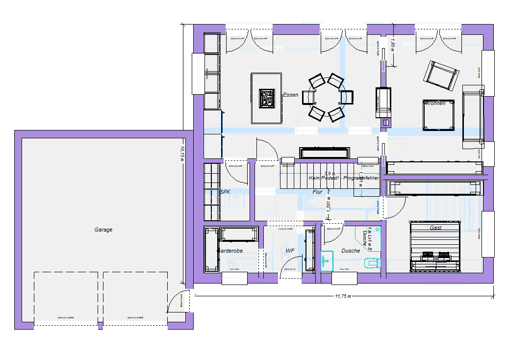

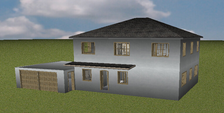

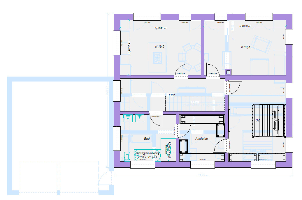

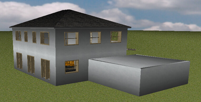

Here is the latest design as an urban villa, although it pains me a bit. The size of the children's rooms is slightly smaller than in the original plan. However, I still consider over 19m² (205 sq ft) quite generous.
The fireplace and partition wall between the kitchen and living area could also be made more open. I would leave that out myself. With the insulation levels in houses today, there is no real need for extra heating in winter. An electric imitation would probably be enough.
