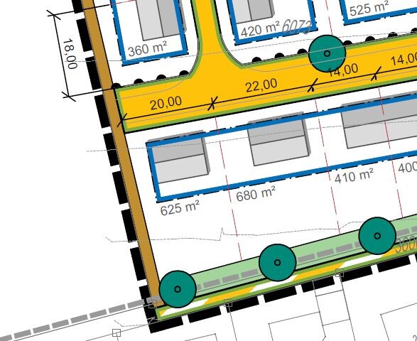

Plot size: 680m2 (7316 ft2)
Slope: no – the plot slopes about 2–2.5m (6.6–8.2 ft) over the length of 30m (98 ft)
Floor area ratio: 0.4
Gross floor area ratio: -
Building line, construction limits: visible in the attachments
Edge development: yes according to building regulations – max. length 9m (30 ft) (The garage is planned on the boundary)

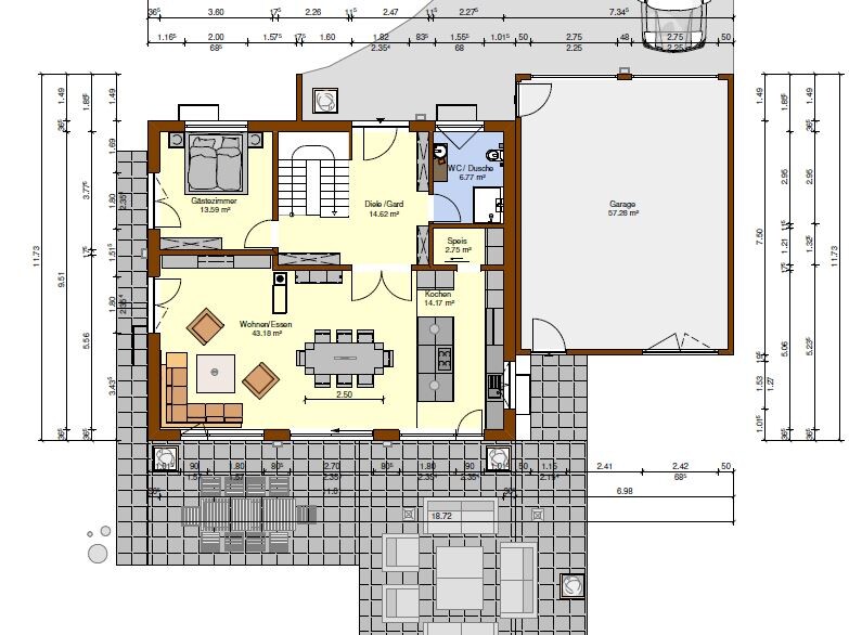

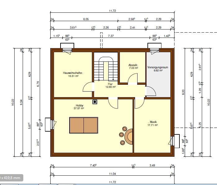

What do you particularly like? Why? – The open living area including access to the south-facing terrace – especially the arrangement/layout of the kitchen plus access to the pantry. We would adopt the basement exactly as planned. Possibly add a direct external access via stairs. We also like the size of the children’s rooms on the upper floor. The children’s rooms should face south here.
What do you not like? Why? – Entrance area on the ground floor – we would like a niche or similar for shoes, coats, etc., so you don’t “stumble” over these or see everything immediately. Possibly a “mudroom” would be very practical.

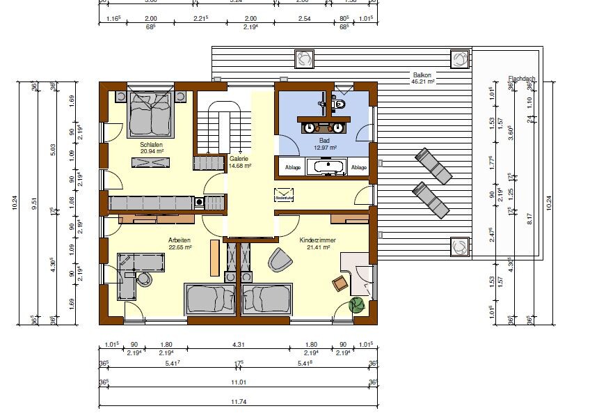

Regarding the upper floor, the biggest change from today’s perspective would be: the access to the bedroom through the “walk-in closet” is not ideal for us. The roof terrace overlooking the bathroom is, in our opinion, only a suboptimal solution. The roof terrace is not a must, and if it exists, it will not be over the main entrance.

As mentioned before, the draft is already very much in line with what we like. We are currently considering rotating the house and possibly placing the entrance between the garage and the house. However, this would shift everything completely.

kaho67423 Jun 2019 22:26
I really like the layout on the ground floor. If I were to build again, it would be very similar.
The request for a shoe nook will be difficult. I don’t see any space that seems wasted. If you don’t want to give up the pantry, in my opinion, you would have to add a small porch or vestibule for that. Would it be worth it?
The upper floor isn’t exactly smooth in design. How exactly is the walk-in closet supposed to be arranged? Should it be separate next to the bedroom? Or only accessible through the bedroom? The latter is often debated here as a disadvantage, especially if one person gets up while the other still wants to sleep.

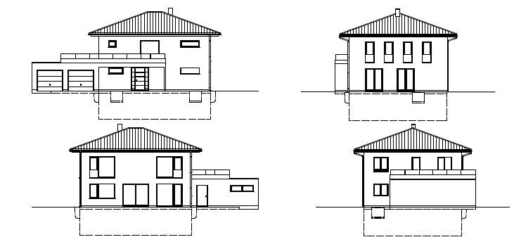

The plot slopes about 2 to 2.5 meters (6.5 to 8 feet) over a length of 30 meters (100 feet)
So more than half a meter (around 20 inches) over the length of the garage, and the terrace would also need to be raised.

The request for a niche for shoes will be difficult. I don’t see any space that would be wasted. If you don’t give up the pantry, in my opinion, a small porch would have to be added for that. Would it be worth it?
That’s why we’re considering rotating the house to accommodate the niche. Giving up the pantry is not an option, and I don’t think a small porch fits the overall design of the house, as it is otherwise very streamlined. Possibly, we would consider a projection for the kitchen if we rotate the house...
kaho674 schrieb:
The upper floor is not exactly smooth in design. How exactly is the walk-in closet supposed to be arranged? Should it be separate next to the bedroom? Or only accessible through the bedroom? The latter is a frequently discussed disadvantage here when one person gets up and the other still wants to sleep.
I don’t see an immediate advantage to moving the entrance. What do you expect from that?
We don’t want the walk-in closet to be directly accessible when entering the bedroom — this way, it might also be possible to leave some worn clothes “lying around.” Fortunately, we don’t have the problem of different schedules, and even if we did, it wouldn’t bother us too much. Overall, the upper floor is okay but not particularly “great.” Do you have any good ideas or suggestions?

So more than half a meter (over 1.5 feet) beyond the length of the garage, and the terrace would also be raised.
Yes, the terrace would likely be elevated; we might secure it with a stone retaining wall. Unfortunately, we cannot change the existing conditions.

Yes, the terrace would probably be elevated, and we might secure it with a stone retaining wall.
Here too: just a note, as not everyone will read this consequence from the plan. At that height, terrain grading is not problematic.
