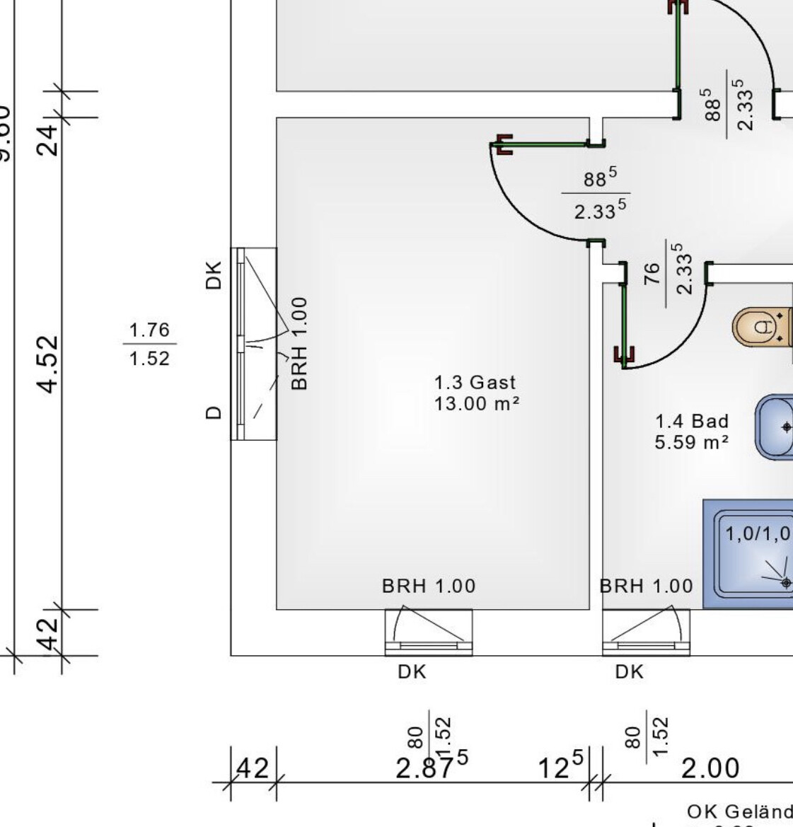

We are currently working on the floor plan design. Attached is the architect’s proposal. Overall, we like the layout very much, but I feel there is unnecessarily large living space lost to the hallway/entrance area/staircase. Does anyone have suggestions for improvement?

Myrna_Loy schrieb:
As often as the original poster emphasized that divisibility is important, it is pointless to criticize this point. Unfortunately, that is not true! It is divisible with a caveat, but it is not convertible!
Dizzy05 schrieb:
What do you particularly like? Why? Flexible and convertible floor plan, it could later be divided into two units. Dizzy05 schrieb:
You can’t do without: the floor plan should remain convertible. It is now split into two residential units. That is not convertibility.
Dizzy05 schrieb:
It is important to us that the single-family home can be divided into two residential units. Dizzy05 schrieb:
What do you dislike? Why? Too much living space is wasted on hallway/foyer/stairs. Because divisibility is the top priority, resulting in three hallways.
Dizzy05 schrieb:
Can the hallway/foyer/stairs be reduced in size? Yes, for example with a more open and spacious single-family house design.
The caveat is something like this:
Who wants—or can use this kind of main bathroom “in old age” or after division, having had over 10 sqm (over 100 sq ft) before?
Or this: who can reasonably furnish the bedroom with a wardrobe and double bed (“age-appropriate”) or at all, with a width of 2.85 m (9.35 ft), when they previously had a dressing room?
-> The bedroom width is generally a problem here for both bedrooms.
Of course, one could stay on the upper floor and offer renters the ground floor including garden. … but is that desirable?
I can only speak for myself: I don’t want that, neither today nor in 20 years. I wouldn’t spend money on that. Not even rent.
And from reading a lot in this forum, the first mistake in house planning is to prioritize only what is needed later.
I recommend planning for your first 20 years. What happens after that is unknown.
By the way, I find the reasoning for “convertibility” missing. With two small children already in the household, it’s reasonable to expect to use the house as a single-family home for about 20 years anyway.
I strongly recommend drawing the furniture to scale and considering the clearance space.
The table by the seating window – aside from the fact that benches are impractical – extends the dining area into the path between dining and living.
A wardrobe for 4-5 people is missing.
The utility room for technical equipment, laundry, and storage is far too small.
The ground floor feels cramped due to the desired division and the conservative layout.
Upstairs, room 2.3 is presumably the master bedroom.
The bed is placed in front of a window – making cleaning difficult.
The room is very narrow. Depending on the bed frame, you might only have about 50cm (20 inches) between the bed and the wall.
The dressing room door, as it stands, can only open toward one wall-mounted wardrobe, and you desperately need the storage room.
I would integrate the dressing room into the bedroom to create a functional and spacious area.
I would convert the WC into a storage room or add it to the bathroom.
The bathroom lacks space for a second washbasin—which is not a luxury with 4-5 people—as well as room for cabinets.
The room layout is ambitious given the size. I would avoid dividing the space to visually create a more open feel throughout the house. Also, consider whether you want to keep two separate rooms for one guest per month and possibly an additional child.
