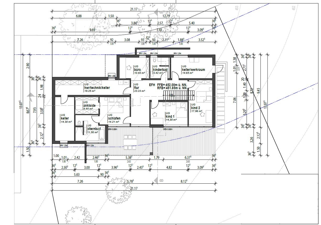

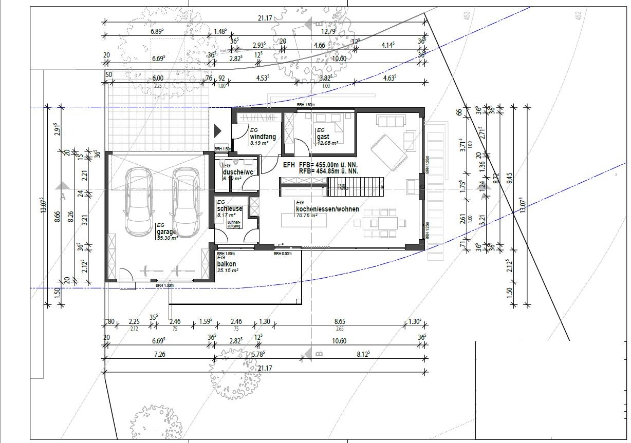

we are in the process of building our single-family home.
After almost a year, this design has become our final version.
Do you have any tips, suggestions, or improvements for us?
Probably, after such a long planning phase, we have lost some necessary perspective.
Therefore, we would really appreciate your feedback.
Thank you very much!

kaho674 schrieb:
For sitting outside and having coffee, you’d probably need a dumbwaiter from the kitchen to the basement. That would actually be doable – I don’t think we’ve ever had that here before.ndooooch, da: https://www.hausbau-forum.de/threads/WDVS-mit-betonbau-oder-sichtbeton.24121/https://www.instagram.com/11antgmxde/
Wow, there are many issues with this floor plan; it’s hard to believe it’s considered final, but okay:
1. Room sizes on the upper floor: The walk-in closet and master bathroom are very small. Not practical.
2. Room shapes: many narrow, corridor-like spaces.
3. Stair placement: I could never live with this, but I hope you are aware. All noise travels through the house from top to bottom. Please plan for soundproof doors throughout the house.
4. Kitchen: In my opinion, far too small, no storage space, no work surfaces. Absolutely impractical.
5. No garden or terrace access from the dining area is a dealbreaker.
I secretly hope the architect wasn’t paid too much, as I would rate this work as poor, around a grade D-.
Bookstar schrieb:
I can hardly believe that something like this is called final.Five years ago, there was supposedly a "final" on this planet, which was won by Conchita Wurst.Bookstar schrieb:
I secretly hope the architect wasn’t paid too much, because I would rate this work as a grade of D+.I often get the impression that young architects nowadays spend too little time—or perhaps hardly any at all—as apprentices before reaching their senior years; that is, they don’t serve as deputies under an experienced professional before starting on their own. Learning from an architecture magazine cannot replace that experience.https://www.instagram.com/11antgmxde/
dab_dab schrieb:
I’m less concerned about the floor plan and more about the estimated total of 500k including additional construction costs.
The double garage, glass facades, earthworks on a slope, retaining walls, photovoltaics and solar panels, glass railings, etc. — I would intuitively expect those to be significantly higher.
How many square meters of living space is it in total? True. I thought the same but forgot to ask: how many sqm (square meters) does the house have?
Bookstar schrieb:
2. Room shapes: many narrow corridors Yes, that’s right. Remaining areas that result
Bookstar schrieb:
1. Room sizes upstairs: walk-in closet and master bathroom are very small. Not practical. I don’t really agree with that.
I don’t think the design is that bad. The main issue is indeed the staircase. You have to walk all the way around the staircase to reach the sleeping area. Personally, that wouldn’t bother me. In the basement, I find the ratio between the children’s rooms and the hallway space unsatisfactory. Also, the fact that the staircase extends into one of the children’s rooms is problematic. Has this detail already been resolved? I find the kitchen sufficient with a 3m (10 feet) island and wall units. I like that you’re not building upwards but instead incorporating the slope into the design; we approached it similarly. However, I would have concerns about construction costs—just mentioning the slope, right now it’s simply brutal!!!
