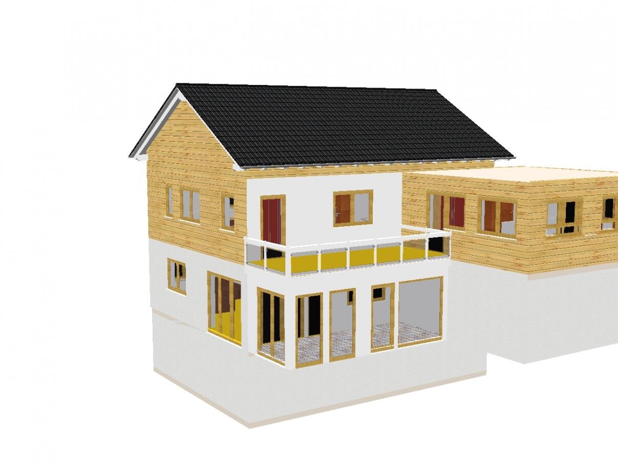

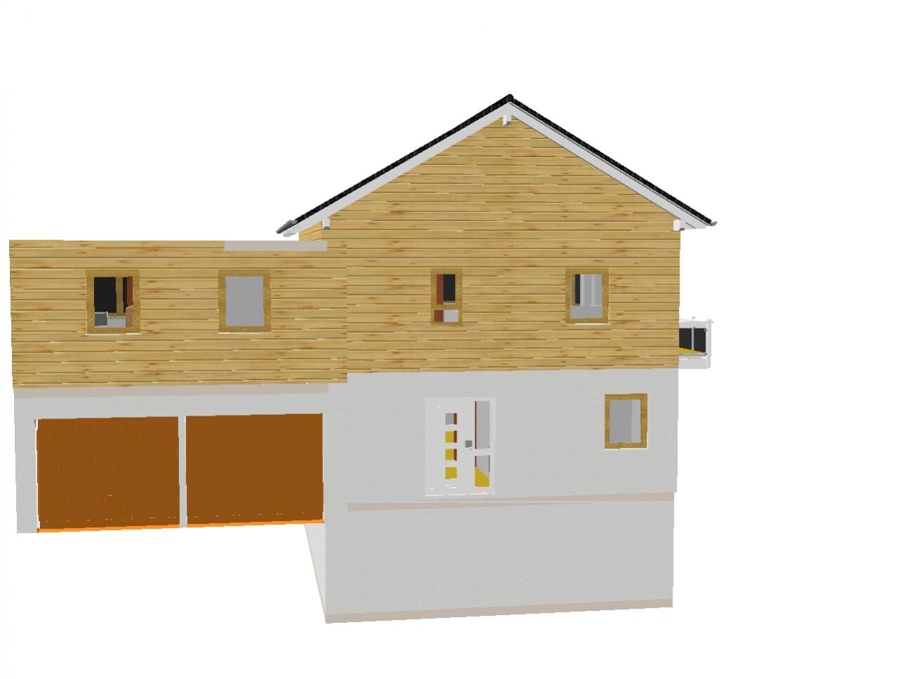

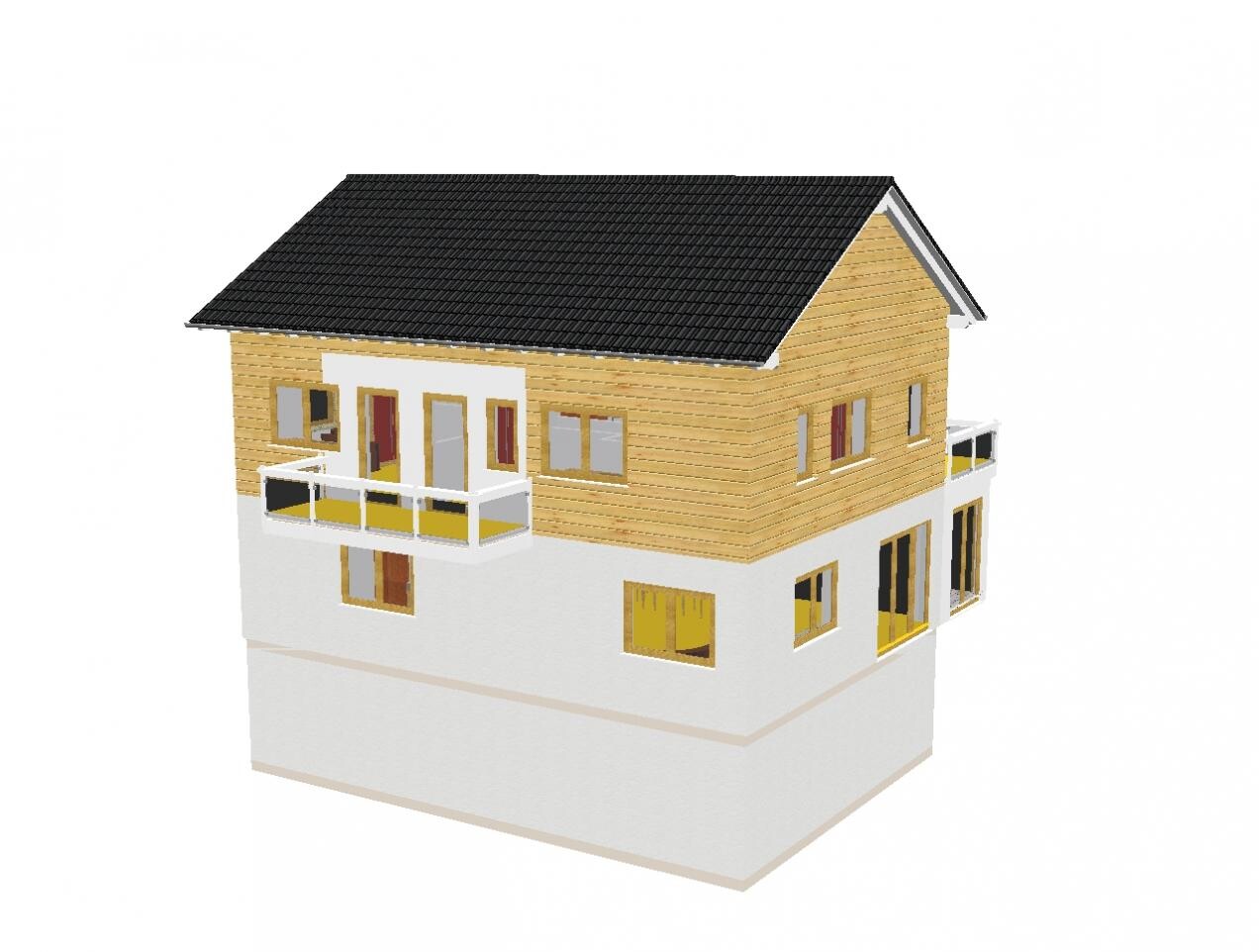

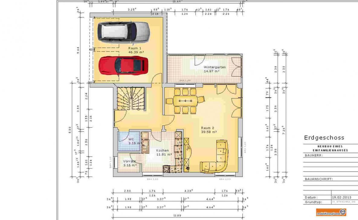

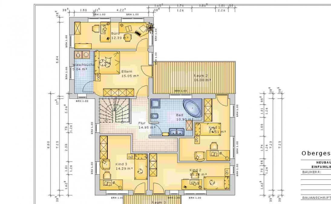

Here are the floor plans and elevations:
There should also be a roof over the garage, but I haven’t quite figured that out yet.
I look forward to your comments and feedback.

8x11 meters (approximately). This is how we are building, roughly. Also with a basement / pellet heating, etc. We pay about 325,000 euros for the house. In addition, there are costs for the kitchen, ancillary expenses, etc. Take a look at the breakdown of ancillary costs by Bauexperte.
Too much when you look at the room layout!
Take a look at the children's rooms—none of them really have practical living value. The upper floor is completely cramped.
I wouldn't feel comfortable in this house, neither as a child nor as an adult (considering the layout, including the ground floor).
Well, that wasn't your question...
But I think this is the wrong approach—planning all the various building details without a budget in mind before consulting the architect. There should be a cost limit set beforehand, and then you take that to the architect. Because an architect is definitely needed here, since this won't be a standard build.
I also imagine that having the garage below the living area with proper insulation will be quite expensive.
Then balconies, conservatory... is this going to be a KfW-certified house?
But the professional answer regarding costs will surely come here soon.

@ypg: The layout of the upper floor was deliberately designed so that each child’s bedroom receives natural daylight (which is especially useful in the afternoon when doing homework).
Additionally, each room is just under 15m² (160 ft²). At the moment, my daughter has only 11.5m² (124 ft²) with a window facing east. So that’s not really ideal.
Regarding the ground floor, I have to say the kitchen/pantry was planned by my wife (I’m not particularly interested since I’m working most of the time --> please don’t take it the wrong way, but that’s how it is in some families...). The living/dining area is actually the main space for us, as we often have guests and spend most of our time there. For size comparison: our current living room is 26m² (280 ft²) and L-shaped.

my amateur opinion: Put your wishes in writing first (3 children’s bedrooms, office, large living-dining area, etc.) and then take them to the architect!
As you’ve planned it, it will be expensive! As ypg already said, having the garage under the living area is almost the most costly option. The children’s bedrooms are very narrow and long. Have you ever been in a room like that? There’s only a small passage beside the beds. That won’t work; it’s far from comfortable. Sunlight while doing homework is overrated.
Are you aware that the drains for the bathroom would run under your dining room? The bathroom would be better located above the guest toilet / kitchen. I would place the laundry room directly next to or inside the bathroom. You don’t really want it behind your bedroom, do you?
The house can be planned differently while keeping the size. We are building 8.84 x 10.60 m (29 x 35 ft), also with three children’s bedrooms (but without a basement and office, and with a larger utility room), and the children’s rooms are between 13 and 16 sqm (140 and 170 sq ft) in a more practical shape, not narrow and long.
You can roughly budget 30,000 to 50,000 € (depending on ground conditions) for a basement.
If you are going for a basement, couldn’t you plan the office there? That would also free up space for the garage without having living rooms above it.
