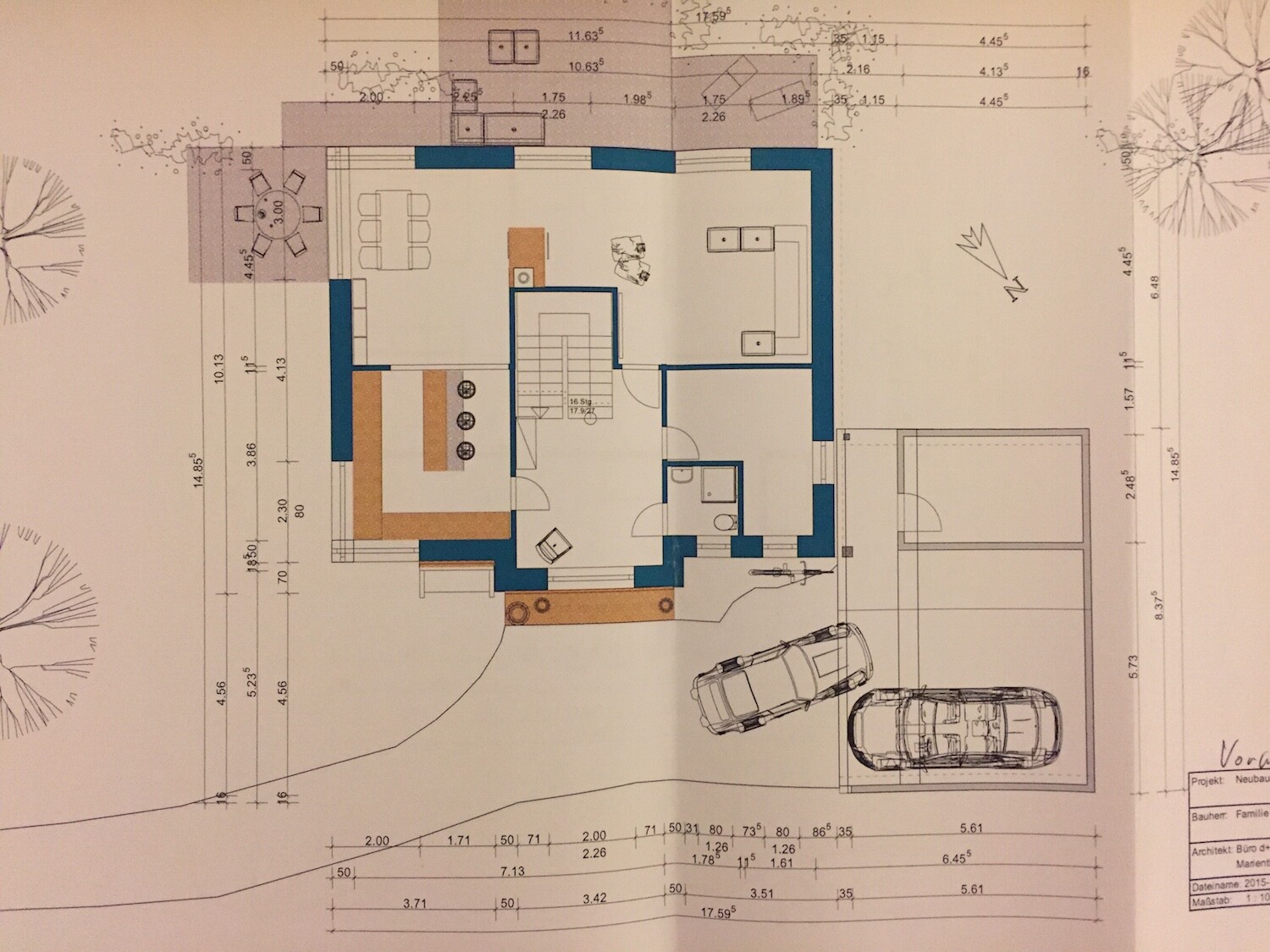

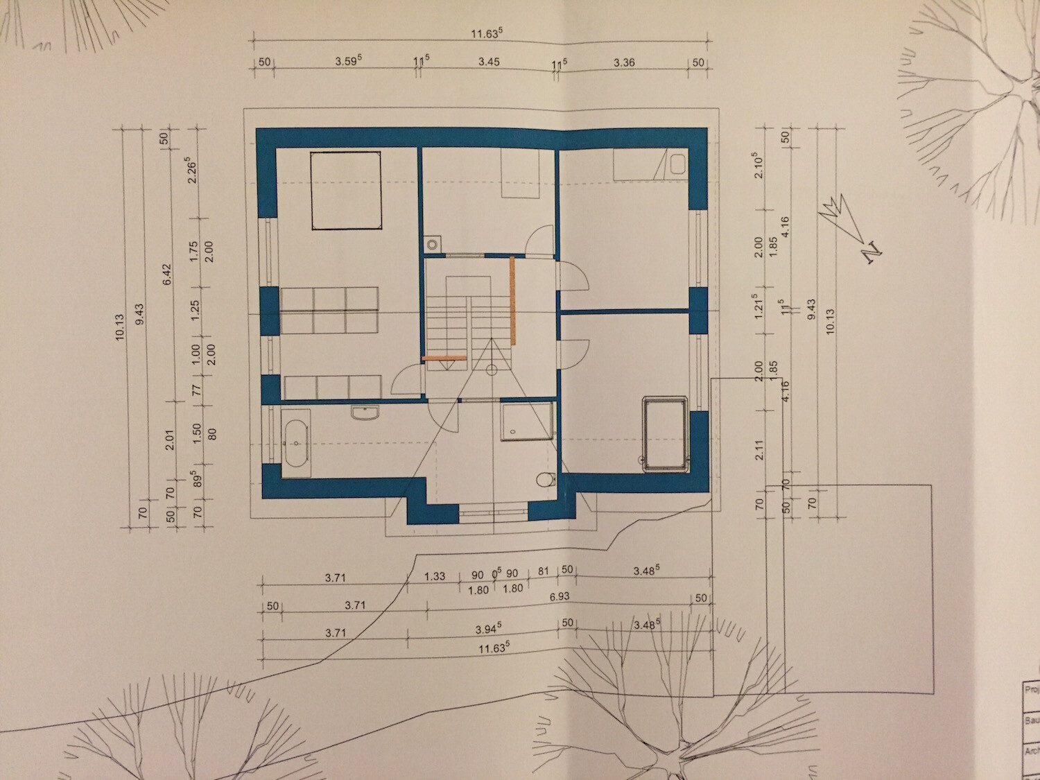

Our house construction is now slowly but surely progressing – as some of you may have already read. We originally sketched a floor plan according to our ideas and then optimized it with our architect.
The most important thing is that we currently really like it, but I would still appreciate comments from "outsiders." Sorry for the poor quality of the photos; I don’t yet have the digital file, so these are photos of a printout. Please keep in mind that the shown floor plan is just a preliminary draft. The window positions are not yet 100% accurate, the drawn-in furniture is still flexible, as are the sanitary fittings.

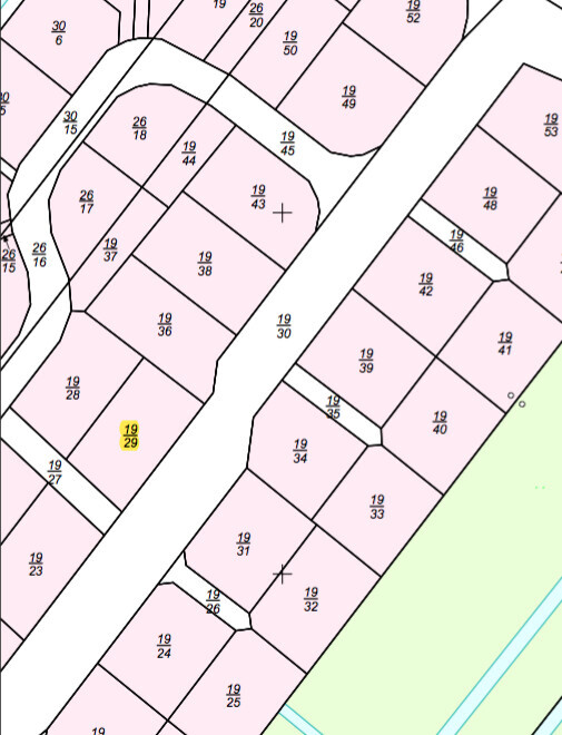

Edge development: see attached cadastral map (the path at the southern end of the property is only a pedestrian path, not a road)

What do we particularly like? Open kitchen, large living and dining area (45 sqm (484 sq ft)), fireplace, large bathroom on the upper floor, subtle spatial separation of parents’ and children’s areas. Children’s rooms extend up to the roof, allowing for a mezzanine level. Interior staircase for short distances (there will be frosted glass doors leading to the office, letting some light into the stairwell)
What don’t we like? How do you find the elongated bathroom? What do you think of the bedroom with the adjacent dressing area and the sleeping area behind it?

Well, if you position the dining table in a way that allows easy access to the terrace door on the left, the table will end up quite close to the fireplace.
Why wouldn’t swapping the living and kitchen areas be an option?
Especially for the purpose you mentioned—using the space @BeHaElJa referred to as “dead living space,” for a playpen, etc.—it would be much better to have the kitchen overlook that area.
Rotating the staircase doesn’t really solve the problem that a staircase of this size basically ends right against the wall upstairs. It can’t be more than a meter (3 feet) away.
And a bathroom with frosted glass doors? Are you serious? Right in the exit area of the shower? Well-lit bathroom or not, that doesn’t seem practical.
Regarding the washbasin/roof slope and the 2 m (6 ft 7 in) line, the issue isn’t so much about someone going to the bathtub while another is at the washbasin, but rather the confined and oppressive feeling you get standing at the washbasin (I would feel it at 180 cm (5 ft 11 in) tall). Take one step back and you risk hitting your head.
What about cloakroom space on the ground floor? With the staircase mirrored now, the only designated spot for a wardrobe cabinet is eliminated.
BeHaElJa schrieb:
Drainage cannot be finalized if you don’t know where everything will be placed… The drainage has been finalized for the current condition.
BeHaElJa schrieb:
Even if you mirror the staircase, it won’t work… the exit is too short. Ah, now I understand. Off the top of my head, instead of splitting the staircase into 8 steps before and 8 steps after the landing, it might help to raise the landing higher, which would gain space on the upper floor.
BeHaElJa schrieb:
If it’s an 80 cm (31 inch) shower, it might fit on the ground floor. That was the plan; only a "small" shower should be installed in the guest toilet.
kbt09 schrieb:
Why wouldn’t swapping living and kitchen spaces be an option? That has other drawbacks. Groceries would have to be carried through the entire house after shopping, and after meals you always have to pass through the kitchen to get from the dining to the living area. We preferred to have the dining area facing south rather than the kitchen… so we decided on the kitchen towards the front.
kbt09 schrieb:
Turning the staircase… doesn’t really solve the problem that a staircase of this size ends almost directly at the wall upstairs. That can’t be more than a meter, right? See above, the issue is acknowledged.
kbt09 schrieb:
…standing at the washbasin quickly causes a cramped feeling (I would feel that at 180 cm (5 ft 11 in) height). Taking a step back you’d bump your head. The 2 m (6 ft 7 in) line is approximately 1 m (3 ft 3 in) away from the wall. I will revisit this matter, as I’m not yet fully satisfied with the bathroom layout.

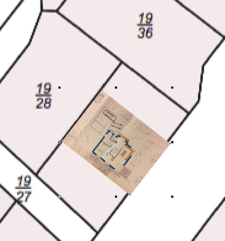

Regarding your drawing: Correct, that’s how the house should be positioned. The plot measures 21 m x 37 m (69 ft x 121 ft). Accordingly, the carport will not be built as originally planned, but the general location should follow that layout.
I only suggested swapping the living and cooking areas. The dining area should remain where you originally planned it. I don’t understand why, after swapping, you would have to go through the kitchen to get from the dining area to the living area. The distance from the entrance to the kitchen would be slightly longer, but the routes between the kitchen and terrace, etc., especially in summer, are used much more frequently than the path from the entrance to the kitchen.
