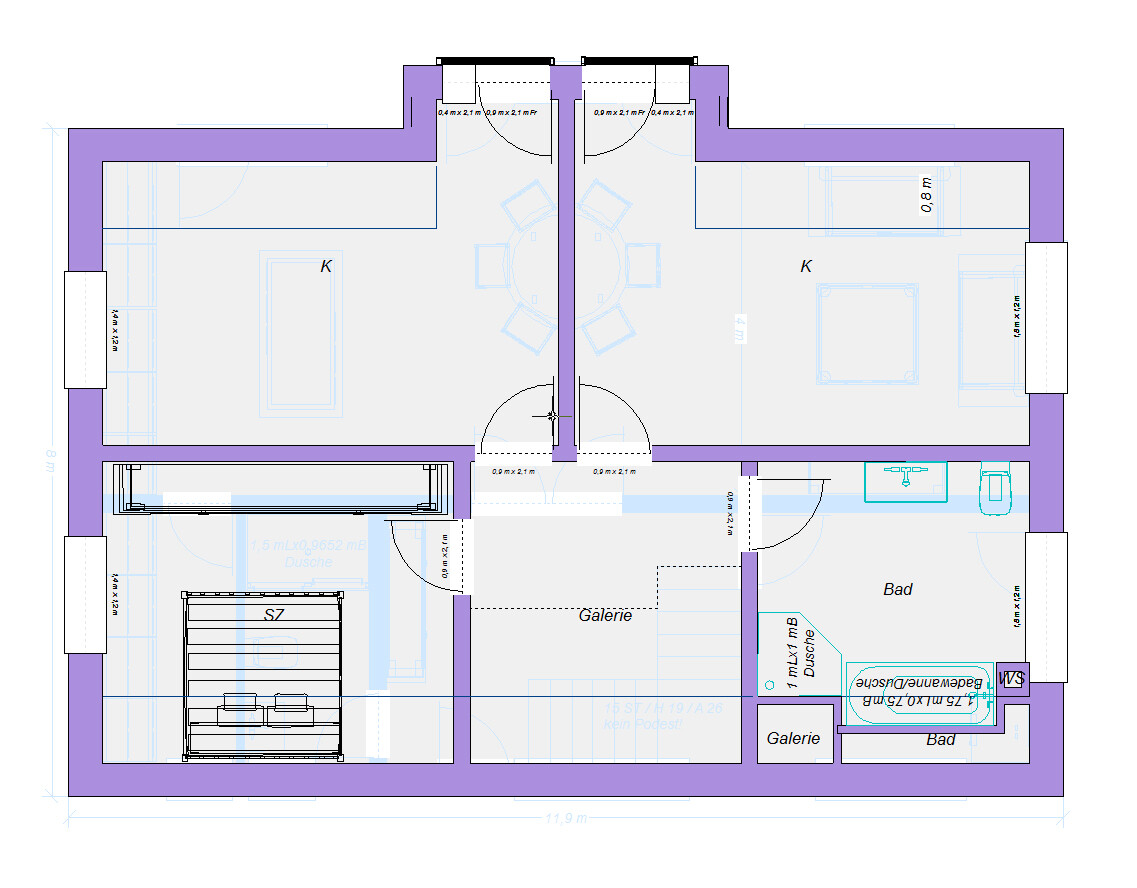

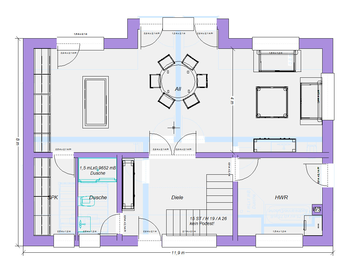

Erisa2010 schrieb:
Thank you, we tried to narrow it down more and concluded that basically the four of us can always eat at the large dining table (as long as the distance isn’t as far as in the first design!) and having a counter area for a quick breakfast would definitely be nice, so three seats would be enough. I’m actually referring to the concept without looking at this specific design. Only once you know what you want should you plan the kitchen, dining, and living areas accordingly. After all, there is also the option of an open-plan kitchen-living area versus a separate living room.
I would also consider moving the dining table slightly closer to the kitchen and/or designing the counter as an extension of the island, for example as an 80cm x 80cm (32in x 32in) high table or at about 72cm (28in) height. There are far more possibilities than just a bar-type counter.
Usually, the high stools are hardly used in everyday life.
Two utility room doors are unnecessary; it would be better to use the sloped ceiling space under the stairs more effectively for dressers and cupboards.
Erisa2010 schrieb:
Oh, we don’t spend long mornings sitting in bed anyway. Currently, there is 77cm (30 inches) between the bed and the wardrobe, and I find it perfect that I can get up in the morning… I’m actually talking about the knee wall height. I’m sitting in bed as I write this—comfortable bed at box spring height with a slightly curved back—and I feel about 15cm (6 inches) shorter than the knee wall, which is around 125cm (49 inches). With your knee wall, I would a) need a different bed and b) wouldn’t be able to sit up comfortably in the morning.
kaho674 schrieb:
Here, I’m treating myself to French balconies for my darlings. View for the knees under the desk?
View for the knees under the desk? Desk?
Don’t you have any pictures in #12? There is no desk by the captain’s area. It’s not furnished yet. But of course, I wouldn’t place the desk in front of the French balcony.
kaho674 schrieb:
But of course, I don’t place the desk in front of the French balcony.With kids who are half-captains, it ends up there so often that I already suspect a special kind of magnetism behind it.https://www.instagram.com/11antgmxde/

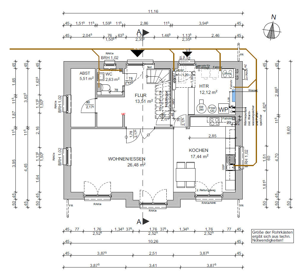

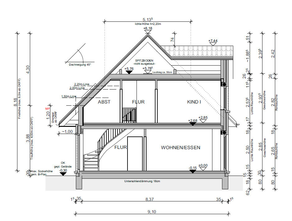

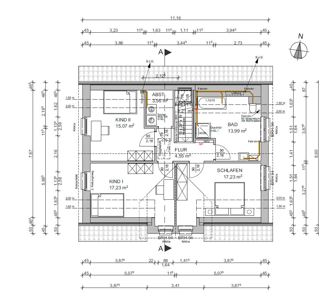

Erisa201018 Oct 2019 09:53Hello,
sorry for not getting back to you for a few days, I’ve been on the phone with the architect every day this week working on the floor plan.
We need to finalize it by Wednesday.
Thanks very much for the suggestion! It looks very good. Unfortunately, the architect resists making the living room wider because she fears the ceiling would have to be considerably thickened due to structural reasons. Does anyone have expertise on this, especially regarding possible extra costs? We haven’t received any statements from the builder without the structural engineer reviewing it first.
If this was misunderstood, we do want to put shelves in the utility room that will also hold food. You can see that in the new floor plan (original dimensions). The adjacent “corridor” is wide enough for us; it’s about the same space as we have now in the apartment and it’s sufficient.
We would prefer to have the washing machine and dryer side by side upstairs on a pedestal.
We took the tip about sharing the roof dormer upstairs into account.
The architect mentioned that with a heat pump, the distribution manifold might need to be 1.10 m (3 ft 7 in) wide!?
Currently, we usually eat breakfast at our bar table. I will get advice from the kitchen studio tomorrow about what options are possible.
We thought about that too, but I want to keep the passage to the kitchen since the utility room is also acting as a pantry replacement. And if I imagine the utility room being used as a side entrance for dirty shoes etc., people usually still wear a jacket which needs to go to the cloakroom or they want to wash their hands in the bathroom.
I don’t quite understand the height issue, but maybe it’s already resolved in the new plan? I can’t remember ever sitting in bed with a laptop in my current apartment—I prefer the couch for that.
Regarding the new draft:
As mentioned, making the living room wider seems difficult because of structural reasons.
The furniture in the living/dining and kitchen areas doesn’t match.
I initially rearranged the storage/WC/cloakroom square to make the storage room (potentially a guest room) wider (WC in the corner, cloakroom in front, storage between living room and the WC/cloakroom corridor), but that doesn’t work with the pipes upstairs. Then the ventilation pipe would either be in the middle of the exterior wall of Child Room II, or if the waste pipe/WC is in the corner, a full duct would have to run along Child Room II’s wall because the washing machine still needs a drain going down. An extra drain pipe running down from the washing machine with the guest WC in the corner would run through the anteroom, making the corridor wider again and the storage smaller.
The upper floor looks okay to me so far. However, there is also a problem with the waste pipe in the bathroom. The pipe from the washbasin can only be routed—without an obvious casing—up to the window area, which would end up in the corner of the kitchen downstairs. Routing it to the toilet side would be too far and would result in a pipe casing along the window.
The furniture placement in Child I and Child II rooms isn’t optimal in the drawing. We don’t need to discuss this now; I’m sure it can be improved.
The problem is, we are running out of time because we are leaving for a 3.5-week vacation on Wednesday and would like to have the floor plan fixed before then to avoid losing too much time.
Thank you very much for your help!

kaho674 schrieb:
I find this house width somehow neither here nor there. It’s too narrow to align the living room properly but also too wide because there’s a lot of wasted space in the middle that’s missing for the living room. The layout of the children’s rooms upstairs is chaotic and that hallway just doesn’t work at all.
If it were mine, I would go for a wider design and bring all living spaces on the ground floor onto the terrace side (same floor area = cost-neutral). Plus a proper pantry, a bathroom with an extra shower for the dog or dad ( ), and a utility room.
Upstairs decent kids’ rooms sharing the roof dormer, bringing southern sunlight into the rooms. I’d treat myself to French balconies for my darlings.
Since there’s no room for the washing machine anymore, there is a laundry chute down to the utility room as compensation. From there, a door leads directly to the drying area.
Four meters (13 feet) of closet space in the bedroom provide enough room for suit and ball gown.
The narrower house also enlarges the garden at the same time.
I would also suggest moving the dining table a bit towards the kitchen and/or extending the counter to the island, for example as an 80x80cm (31x31 inches) table in bar height or 72cm (28 inches) height. That offers many more possibilities than this bar variant.
Most of the time, the bar stool hardly gets used in everyday life.
Two utility room doors are unnecessary: you should look into better using the sloped area under the stairs for drawers and cupboards.
I’m actually talking about the refrigerator height. I’m writing this from bed right now: sitting in a comfortable bed with box spring height and a somewhat curved back. I feel about 15cm (6 inches) shorter than the refrigerator, which is about 125cm (49 inches). With your fridge, I would either need a different bed or I couldn’t sit comfortably in the morning.
