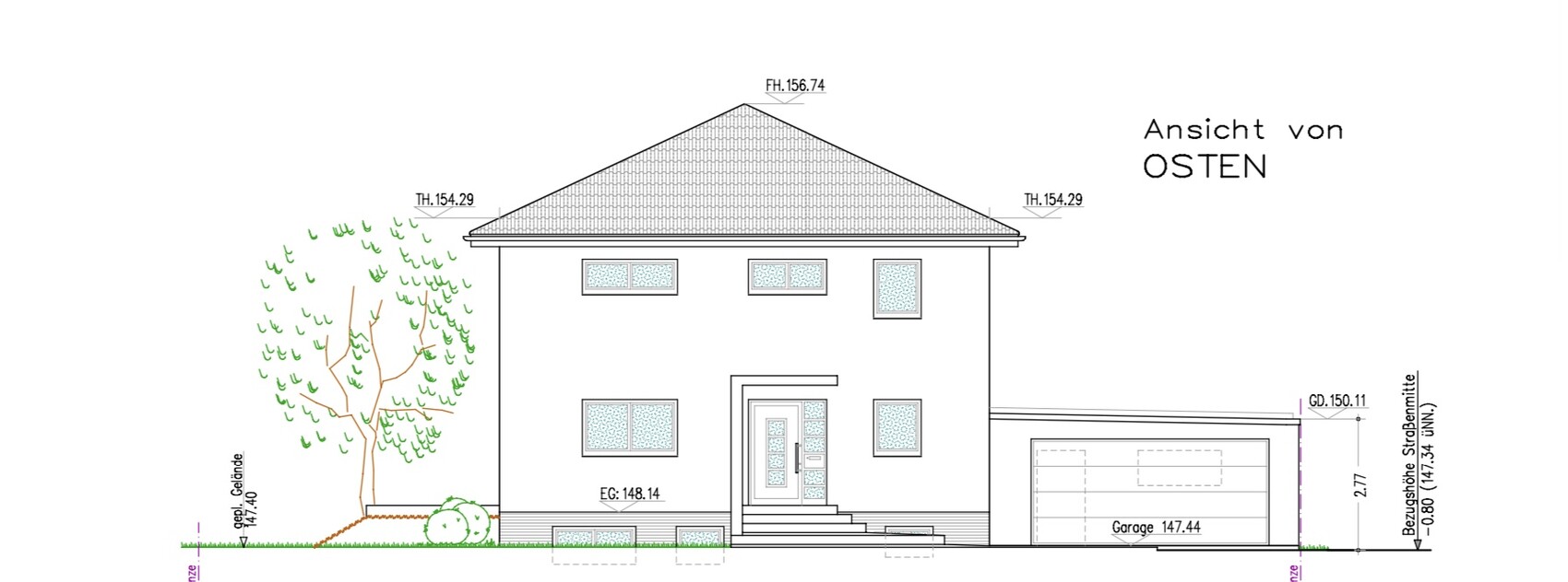

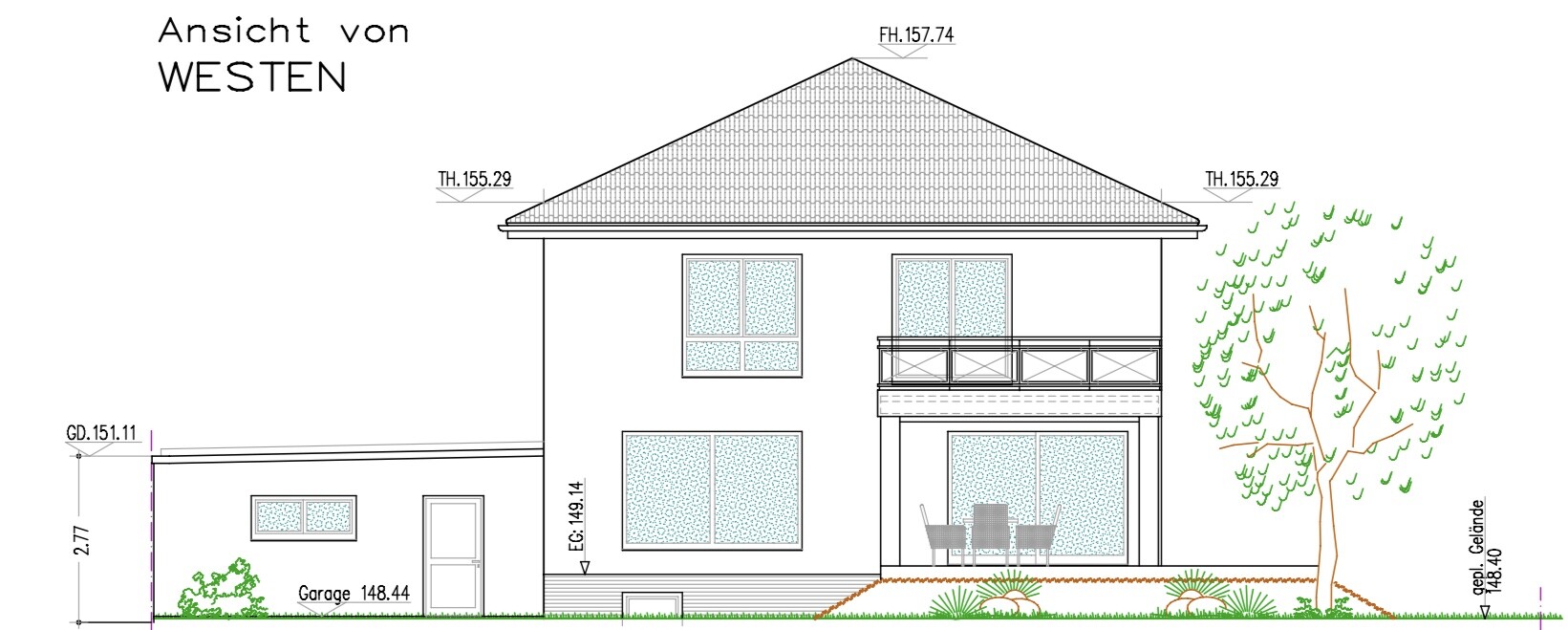

Views and windows -> Here we are a bit uninspired I’m not really happy with the south and north sides, but I find the other two facades quite acceptable. I just dug around a bit: I had given you the "reading tip" @RobsonMKK – who has, however, restricted his profile; so I had to dig for a while. Here are his floor plan and elevations: https://www.hausbau-forum.de/threads/vorschlaege-zum-Grundriss.15130/page-13#post-173659 (post #74) and https://www.hausbau-forum.de/threads/vorschlaege-zum-Grundriss.15130/page-14#post-173688 (post #79).
Thanks for searching and finding this, @11ant

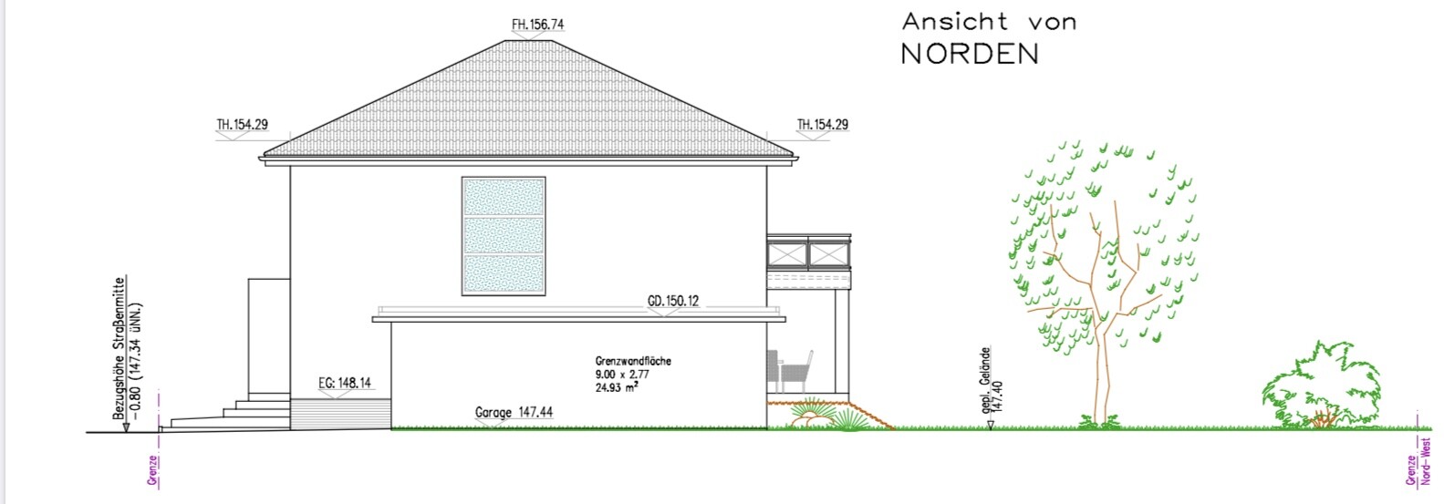

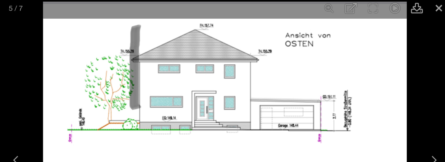

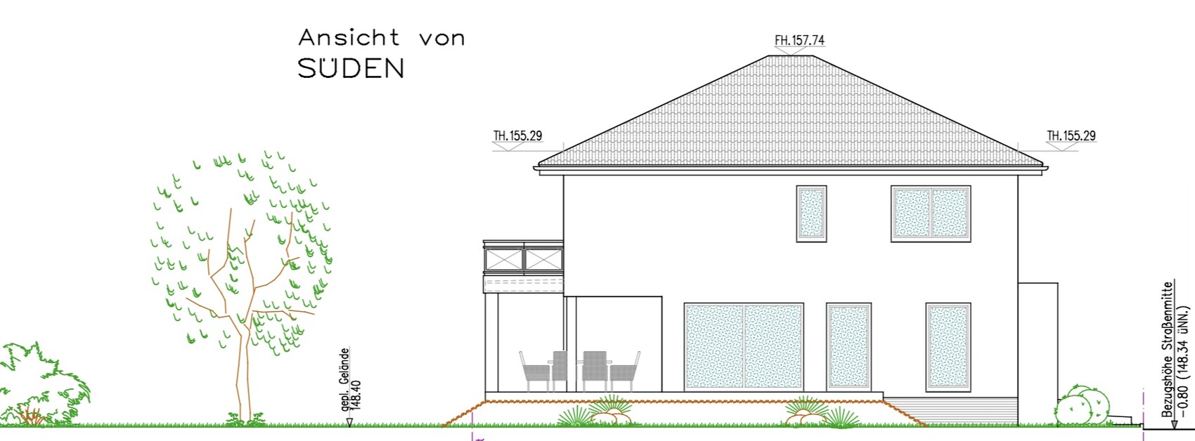

Attached are the elevations again along with our questions.
East: All good.
North: All good.
West: The window at the bottom left in the living room – is a window that size suitable for a living room (3x1.98m (10x6.5 ft))?
South: It seems a bit untidy to us. We’re wondering if we should omit one of the two balcony doors (possibly the one in the middle). The problem is my wife would like an access from the kitchen to the terrace. If we remove the door next to the lift-and-slide element, we would always have to open the blinds or enter the terrace via the kitchen. The left area (children’s room) looks empty to us. However, if we plan a new window here, the children’s room would have two windows (south + west). That probably isn’t a problem at first, but compared to the north elevation, it might look even more asymmetrical, right? Furthermore, the architect pointed out that the children’s room serves as a retreat, living room, bedroom, etc., for the child, so we should carefully consider the number of windows in this context. Could too much light be a disadvantage here?
East: All good.
North: All good.
