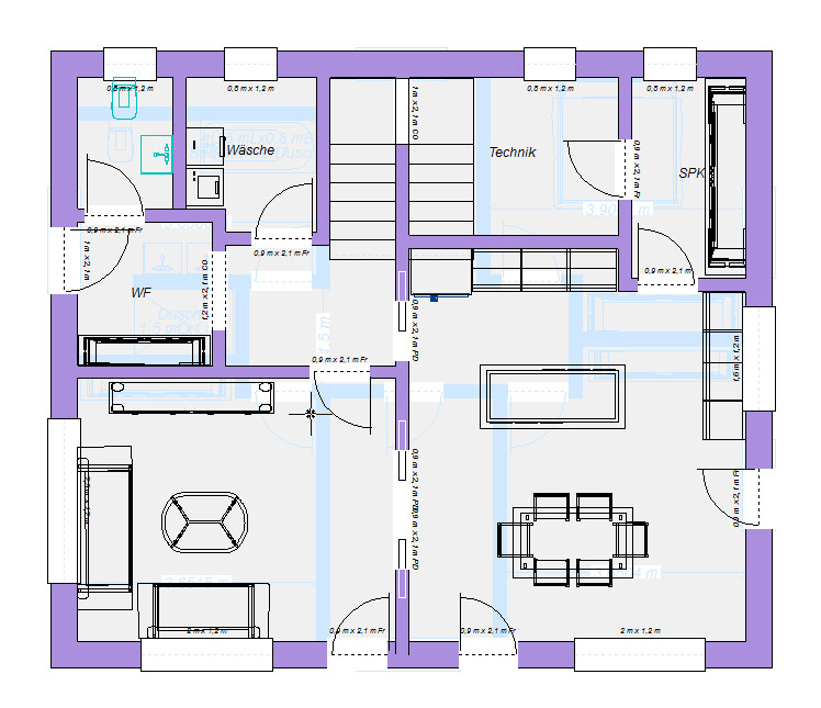

we have been offered a plot of land by a developer and would like to build our future home there. The plot is located at the end of a cul-de-sac in a traffic-calmed residential area (infilling development).
I should mention upfront that we have not yet received much information from the developer. We shared our rough requirements with him, and he has created a first draft, so far only for the ground floor.
It would be great if you could help us evaluate this early on before we progress too far in the planning and have to make major changes later.
The positioning of the house on the plot is due to the fact that all other options we considered would cast too much shadow on the rest of the plot.
The plot shown as undeveloped on the site plan has meanwhile been built on with a bungalow (marked). A carport will be constructed between the bungalow and our plot.

Noticeable is the missing entrance area, i.e. the actual front door. Initially, this seemed strange to us, but it provides many opportunities for the interior layout, so after some consideration we don’t find it so bad.

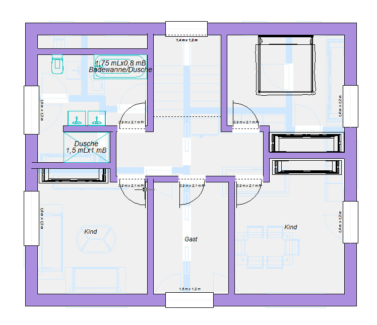

kbt09 schrieb:
The T-shaped bathroom doesn’t work properly like this:
Room width:
338 cm (133 inches) - 90 cm (35 inches) shower - 18 cm (7 inches) wall - 85 cm (33 inches) bathtub - 10 cm (4 inches) plaster and tiles on the many walls - 55 cm (22 inches) for a realistically deep washbasin.
That leaves 80 cm (31 inches) of passage... okay, it might be enough, but it’s less generous than the drawing suggests.

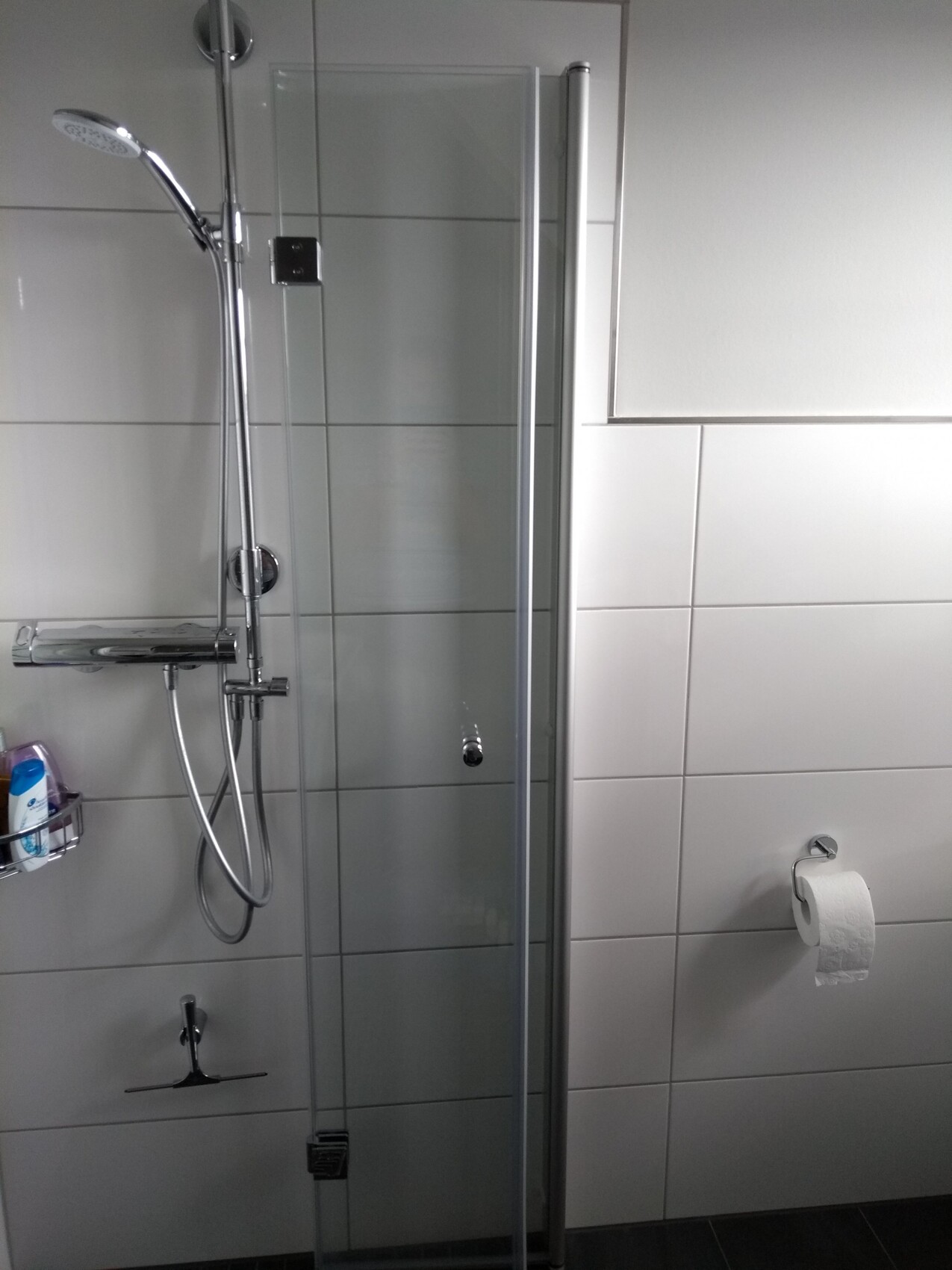

However, the T-shower is pointless if the shower door opens as shown. If the door is in the passageway, then it overlaps the window, and the window would have to be significantly narrower. Then it could be at most about 126 cm (50 inches).
@Stege90 ... It would be great if the house could be redrawn to scale in the site plan.Yes, the shower wall will definitely open inward, see example:The 80 cm (31 inches) is a good indication and is sufficient for us so far.
We will request the site plan again and then I will update it.
Let’s just take this: the pantry is not really usable as such because of the south-facing window. After three days of sun, the heat won’t get out of this narrow room, and it becomes uncomfortable there for anyone staying inside. Food will spoil quickly.We will have external blinds to mitigate this problem somewhat, but not completely, that’s true. So far, we have kept it in because of the blinds and the external appearance. What about ventilation if the pantry window is removed? Will the ventilation system be installed in every room, including the pantry?Also, the symmetrical window arrangement on that side would be lost.
The design is getting worse.
The pantry still has its south window. Everything revolves around the impossible entrance under the carport... as if you wanted to deliberately create a bottleneck with a maze here.
Could it be that you cannot follow our well-meant and sensible advice?We are trying to understand the advice and are definitely taking conclusions from it.I have already commented on the hallway issue in post no. 37.
Obstlerbaum schrieb:
Maybe shift the house 2.5 m (8 feet) east within the building boundary and you’ll get space in front of the entrance door to move it to the north.
Having the pantry next to the kitchen makes sense, but just swap the living room and kitchen. Then you solve three issues at once:
- Living room with southern exposure
- Dining room with southern exposure
- Pantry directly next to the kitchen and cool on the north sideThat suggestion could really work, but first we need the updated site plan. It could get quite tight—or even impossible. But we will take care of it!
Stege90 schrieb:
And the symmetry of the windows on that side would be lost. Secondly, there is no symmetry there, and firstly, it is not necessary. You don't go into the pantry to get fresh air – it requires a as constant climate as possible, which means no heating from a window. A blind there would just be a joke.
You don't go to the pantry to get fresh air – it needs the most stable climate possible, which means no heating up caused by a window. That tops off the absurdity of the design when I use the sunny side of the house for windowless storage rooms to prevent them from heating up.
kaho674 schrieb:
This tops the absurdity of the planning when I install windowless storage rooms on the sunny side of the house to prevent them from overheating.No one ever suggested placing the pantry on the south side.
This absurdity arises when the pantry absolutely must be accessible from the south-facing kitchen... plus the two towers as tall cabinets in the kitchen to allow the kitchen door to swing more easily.
Instead of considering removing the pantry altogether and planning the kitchen door directly from the entrance.
