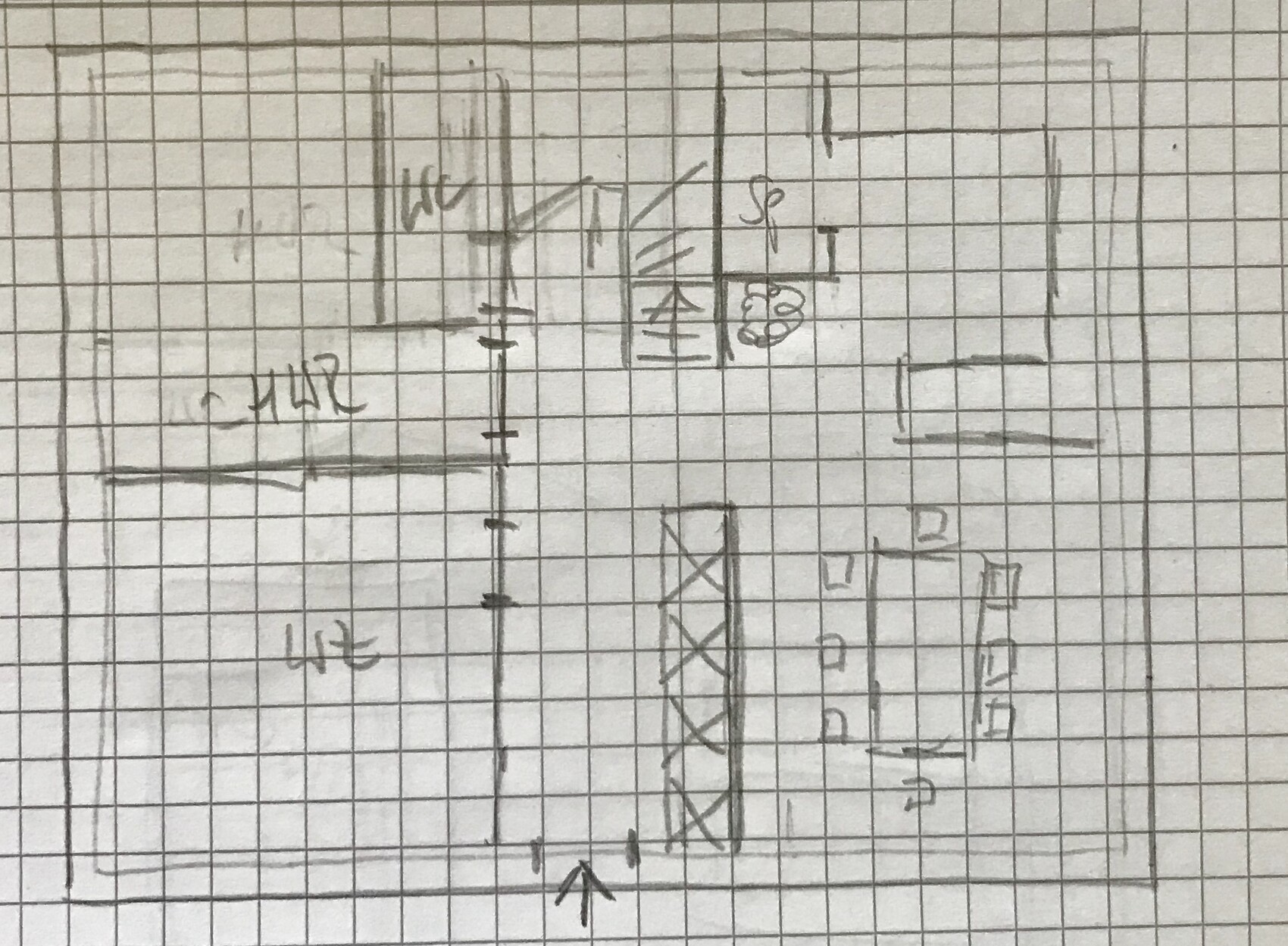

6 Sep 2018 10:07
Clear, functional, and no wasted space
Hand-drawn floor plan sketch of a house with living room, kitchen, hallway, and staircase
6 Sep 2018 10:11
niri09 schrieb:
Yes, it’s clear in the forum. You don’t know the people, and I wouldn’t do everything suggested here either. But you should definitely listen carefully to an architect you trust, as you chose them for a reason. I’m sure the original poster also sees it as logical and will ask the planner directly.
But because of anonymity, you get to read the honest truth here.
An architect is still a service provider who relies on the client’s money. And before the client leaves feeling offended because the architect doesn’t “understand” them or doesn’t look at their amateur drawings, the architect incorporates those amateur ideas into the design.

6 Sep 2018 10:46
There is a lot of confusion here. The ideas can and should be adopted as they are; the architect doesn’t have to like my townhouse, that’s a matter of personal taste. This is about planning errors, such as having the pantry on the south side. That is no longer a matter of taste, and this is exactly where feedback should be taken seriously. Whether the living room is separate or open, or whether the hallway is a narrow corridor with a bend, these are matters of personal preference and can be lived with. But in this case, I can no longer use the pantry as I originally intended, as in the example from Climbee. The original poster can still decide to use the “pantry” as a storage room instead of for food storage, which is consciously their choice.

6 Sep 2018 10:52
niri09 schrieb:
There is quite a bit of confusion here. The ideas can and should be adopted as they are; the architect doesn’t have to like my city villa—that’s a matter of taste. This is about poor planning, like having the pantry in the south, which has nothing to do with taste, and this is exactly where one should listen. Whether the living room is separate or open, or the hallway is a narrow corridor with a bend, that’s all a matter of taste and manageable. But in this case, I can no longer use the pantry as I had planned, as in Climbee’s example. The original poster can still decide to use the "pantry" as a storage room and not for storing food, but then that is consciously their choice.
Mostly yes, but there are also answers that try to impose their own taste.
I also criticized the pantry in the south.
Also the hallway and the entrance under the carport.
It is not functional at all – it annoys me as well.
