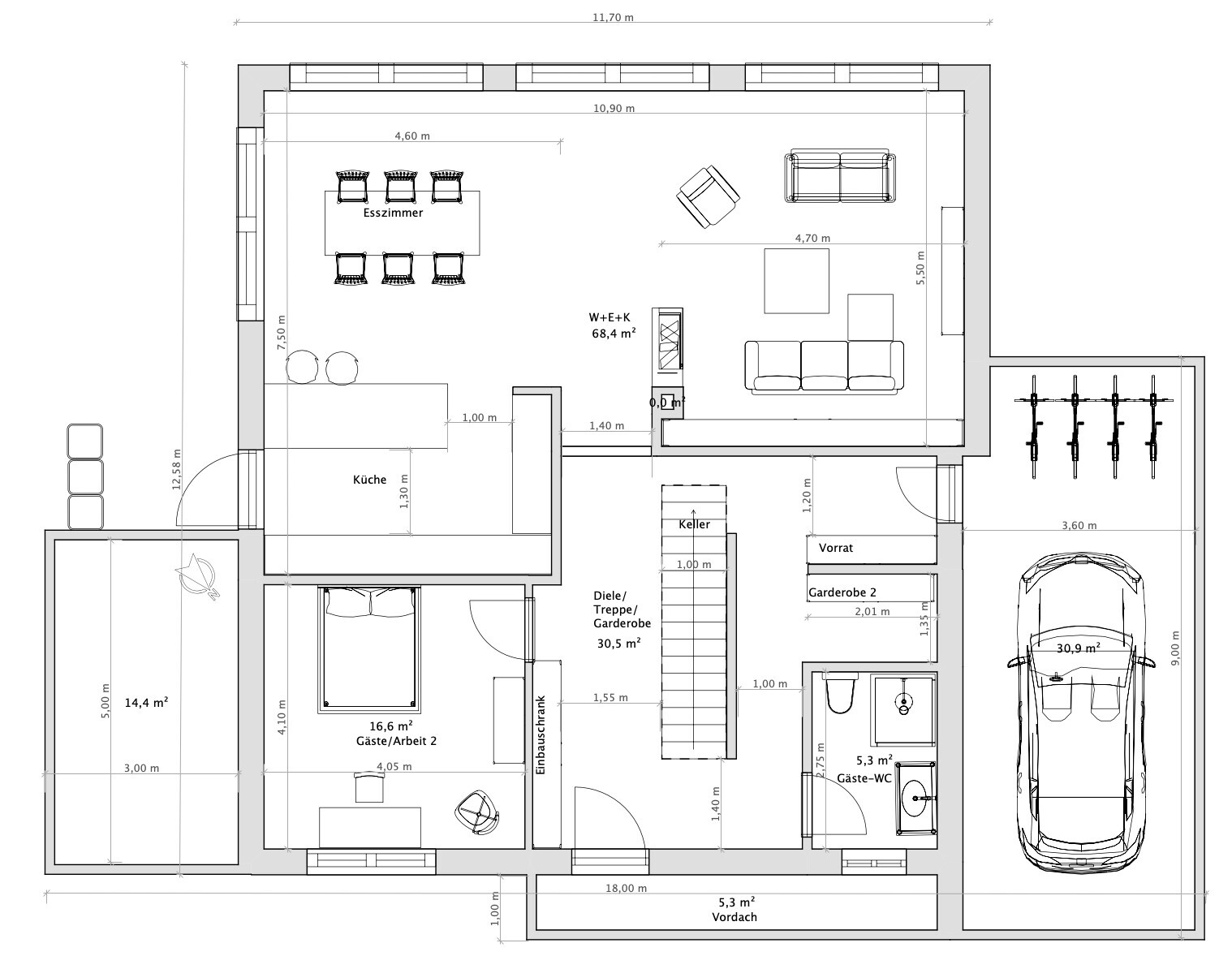

Ground Floor:
Two main questions still concern us:
1) Should the kitchen/dining area be on the left, or should the living room be located there instead?
The recessed kitchen on the left works well for natural light and especially because otherwise, we can't properly fit the staircase. Having the living room on the left would be nice since there is sun there until about 9:30 pm in summer, while the right side is in the shade by 6:30 pm. It’s a matter of preference when and where you want sunlight, but we’d be interested in your opinions.
2) Where should the staircase be placed, and how can we avoid losing much space on the upper floor?
So far, we have only found one solution. We prefer a 180-degree staircase; a 90-degree staircase would also work, ideally with a landing, as we want to avoid angled stair treads.
Other notes:
The plan lacks a pantry. We initially considered placing it in the passageway from the garage to the hallway, but there isn’t enough space for that. So the pantry will now go into the basement. Additionally, the hallway doesn’t have a particularly large cloakroom, so we are considering taking some space from the kitchen/guest room. The guest bathroom on the ground floor could be a bit larger.

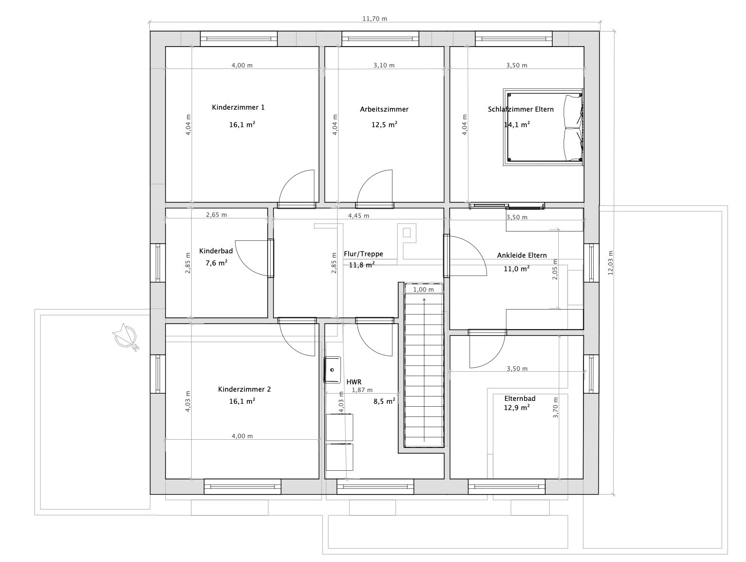

Upper Floor:
We need the space upstairs for two children’s bedrooms, a study, two bathrooms, a master suite, and a utility room. With the current staircase placement and some restrictions regarding the master dressing room and bathroom, everything fits well, and we like the room sizes and their layouts.

I almost think it’s too early,I don’t think so. Details like the row spacing can’t be changed later and can make a proper kitchen layout impossible.The kitchen is one of the first things to consider when planning a house.
Because, as in this example, if the garage has to stay and the kitchen needs to shift toward the top of the plan, you can no longer access the kitchen from the hallway, and the entire ground floor layout stops working.
Often, it comes down to just 10cm (4 inches) that prevent the kitchen from becoming the dream kitchen you hoped for.
Because, as in the example, if the garage must remain and the kitchen has to be shifted accordingly towards the top of the plan, you can no longer access the kitchen from the hallway and the entire ground floor layout no longer works.
Often, it’s just about 10cm (4 inches) making the difference between having the dream kitchen you hoped for or not. I find such advice quite helpful; otherwise, you might redesign everything just for a few centimeters.
Are there any comments or ideas on where the stairs could be placed or what your preferences are regarding the orientation of the living room and kitchen?

The kitchen is one of the first things you should consider when planning a house.
Because, as in the example, if the garage must remain and the kitchen needs to be shifted towards the top of the plan, you can no longer access the kitchen from the hallway, and the entire ground floor layout no longer works.
Often, it is just about 10cm (4 inches) that prevent the kitchen from becoming the dream kitchen you hoped for. Of course, it is best if you already know your individual preferences. Therefore, the location, certain standard dimensions, etc. should definitely be taken into account to ensure that the basic layout of the desired kitchen is possible.
However, I also believe that there is not just ONE dream kitchen; the kitchen will usually change anyway after several kitchen plans, especially due to increasingly limited budgets, technical requirements, but also personal adjustments or innovations. The same goes for a dream bathroom and other aspirations for nearly every other room.
Precisely for this reason, it often makes sense to involve a well-chosen architect from the very beginning in order to realize these dreams in all areas right from the start.
What advantage is there in having the wall layouts ignore those of the other floor? – the chimney stands quite awkwardly in the hallway upstairs. I can’t really see a clear design concept here.
