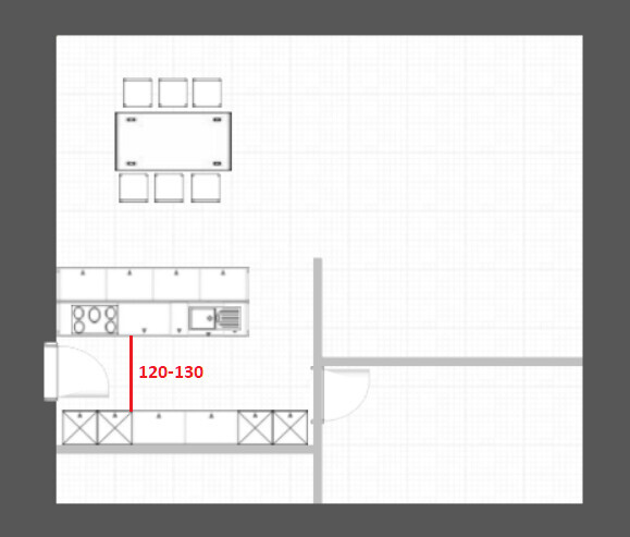

In the kitchen, there is a "mistake": the distance to the island is too large because the door to the outside is placed too far toward the top of the plan. If the garage is to remain in place, the kitchen/guest wall would need to be moved at least 60cm (24 inches) toward the top of the plan. It is common to see that the wall unit and island do not match well due to the incorrect door position.
It is better if the door starts 75cm (30 inches) from the bottom of the plan.
This mini pantry is not really a pantry and will probably not look very attractive. Take a look at some finished kitchens for inspiration, for example those by spexs.

10 Jul 2020 14:14
Floor plan of a kitchen and dining area with sink, stove, base cabinets, dining table with chairs.
More is too much

There is a "mistake" in the kitchen: the distance to the island is too large because the door to the outside is positioned too far toward the top of the plan. If the garage is to remain there, the kitchen/guest wall would need to be shifted at least 60cm (24 inches) toward the top of the plan. It is common to see that the wall run and island do not align properly due to the incorrect door placement.
A good guideline is for the door to start 75cm (30 inches) from the bottom of the plan.
This tiny pantry is not really a pantry and will probably not look very appealing. Take a look at some "finished kitchens" for inspiration, for example those by spexs.
Very helpful tip, thank you!

I almost believe it is too early to accurately place such kitchen details as long as the entire floor plan is not yet finalized; at this stage, we are still at the very beginning.
Certainly, there should be space for a pantry; right now we have 1.4 x 1.2 meters (4.6 x 3.9 feet) and a generous kitchen, which is completely sufficient, possibly even more space than needed.
As @Alessandro says, there should definitely be a spacious wardrobe or area for shoes and so on.
By the way, I took a look at "spexs"’ kitchen... very stylish and elaborate; still, when cooking, you face a wall and the central island feels rather cramped and like a passageway to me. Considering the budget used, I would expect something different.
Therefore, I think it’s best to first establish the floor plan with a suitable basic shape for the kitchen area; after that, these details will fall into place.
