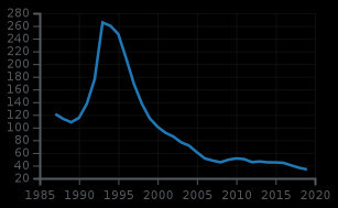

pagoni20209 Jul 2020 22:50Fuchur schrieb:
No need to bet or Google it I didn’t have to, I just knew. Such a shame about the champagne, a bit of construction chat by the campfire.......
Fuchur schrieb:
I’m the one who compiles these statistics That’s what I thought; exactly the same here.
Car theft numbers have dropped almost unnoticed by the public since 1994 by about 85%, from 105,000 to only 15,000 in 2018.
However, our personal sense of security has become much more sensitive, unfortunately so has the severity and criminal intent of the offenders—even though the number of cases has decreased so significantly. THAT has completely changed, which is not necessarily good news.
Oh yes, the garage... somehow it seems nice, but would it be more efficient and cost-effective to go with a double garage? Electricity, possibly water, lighting, belongings… everything installed twice, where one setup would otherwise suffice, including various accessories. Personally, the look would probably seem too car-focused to me, and especially the already mentioned lack of access to the property for pending and recurring tasks, firewood, plants, etc., would be something I would miss.
