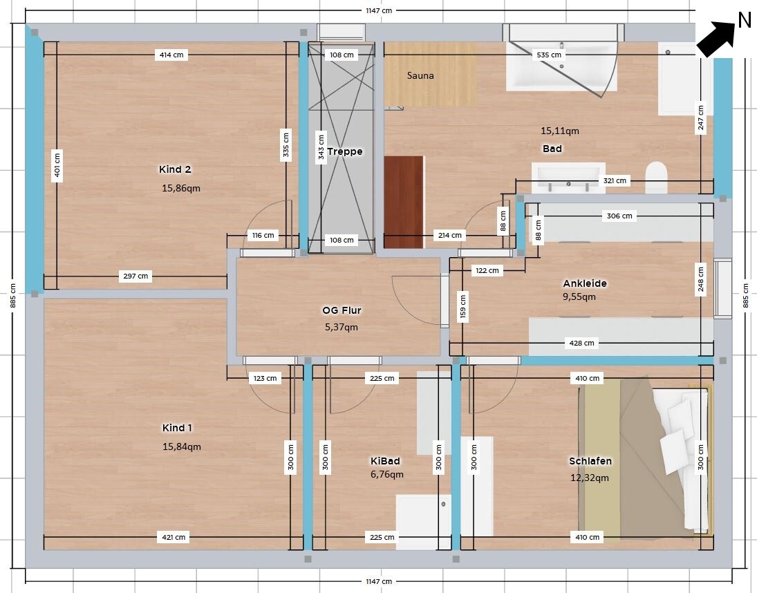

After reading quietly for some time, things are now getting serious for us. We recently purchased a plot of land and are ready to start building our own home.
We had been interested in this plot for a while and have already spent some time trying to find a floor plan that “fits.” We picked up a few ideas here in the forum. Now that we have secured the land, we need to focus seriously on the floor plan.
Since I have been reading here for a while and am often amazed by the great and helpful ideas from other forum members, I thought it might be useful to share our floor plan draft here for discussion. So please feel free to share your comments – many thanks in advance!
A few explanations about the sketches:
- The development plan is oriented to true north; on the floor plans, the top of the plan is approximately northwest.
- Since we already know which builder we will use, the wall thicknesses correspond to their specifications.
- The window locations are still completely open, so they are barely drawn in on the upper floor.
- Our existing furniture in the living and dining rooms is accurately scaled and included.
- The furniture in the kitchen and bathroom are just placeholders so far – the “cabinet” in the bathroom is ideally meant to house the washing machine and dryer later.

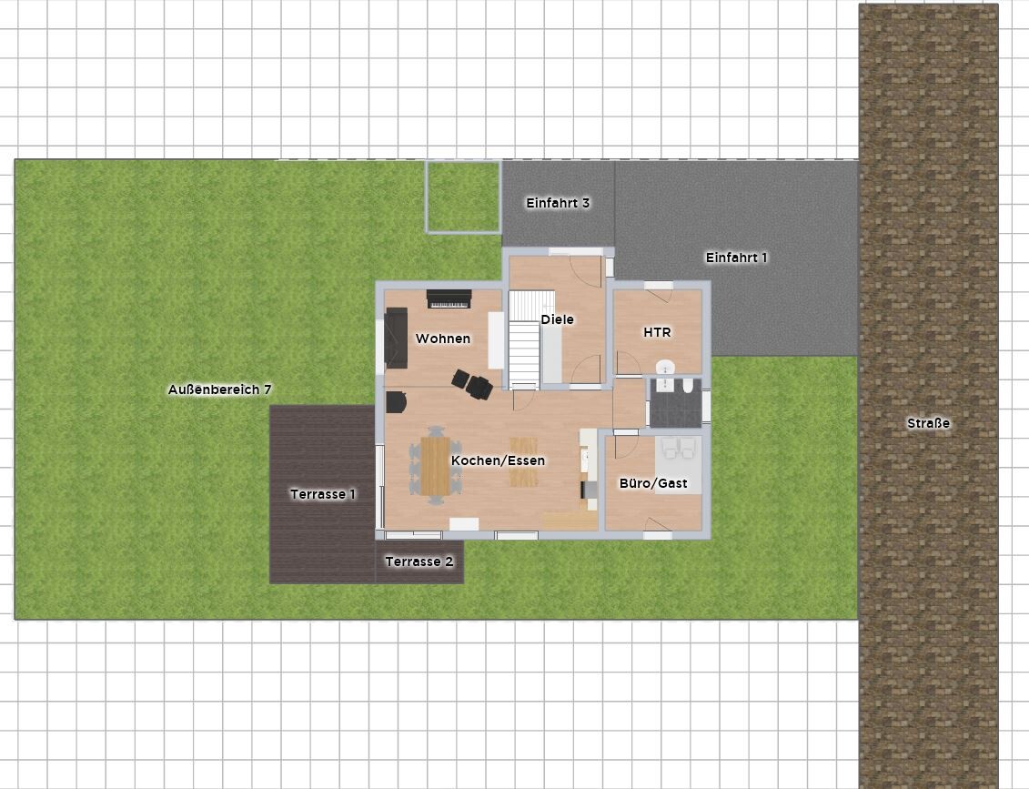

- The terrace, driveway, etc., are currently placeholders as well. In particular, we have not yet checked if everything complies with the site coverage ratio.
Plot size 472 sqm (16x29.5 m) (170 x 97 feet)
Slope none
Site coverage ratio 0.4
Floor area ratio 0.8
Building envelope, building line and boundary building envelope 10x20 m (33 x 66 feet)
Edge development no
Number of parking spaces 2
Number of storeys max. 2 full storeys

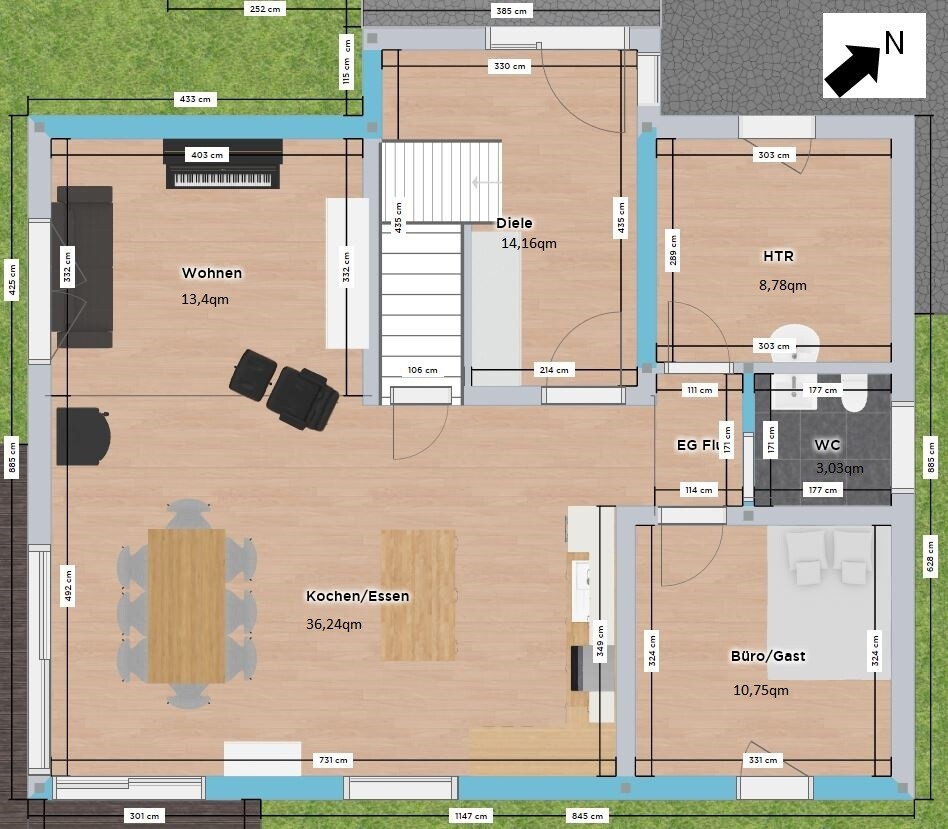

What do you particularly like? Why? Area between hallway and kitchen
What do you dislike? Why? Entrance area/hallway; living area possibly too small?

Phinitho schrieb:
You’re not allowed to post links here, but if you search for it using a major search engine,However, you are allowed to mention the name of the program.
Phinitho schrieb:
Well then: Home by meOh no, you were faster ... sounds familiar, my favorite software company: 3DS ... Home by MeHmm.
I would be quite bothered that almost all rooms on the ground floor branch off from the open living area. If a guest needs to use the restroom, everyone else can hear it. Do you really want it like that?
The entrance area doesn’t feel balanced. The bathroom upstairs seems kind of unsettling, and having the washing machine in the bathroom is not ideal. I would start over again.
I’m not completely sure about the location. You say you want the parents’ area in the north. But actually, the bedroom is located in the southeast—more south than east. Or did I misunderstand something?
Overall, there are a lot of wishes for a very limited space. 400K is not a bad budget, but you also want a lot. 11.5 x 8.85m (38 x 29 feet) seems quite tight to fulfill everything. Better to drop the expensive bay window and instead slightly increase the overall size.
Yes, having the ground floor with only an entrance area but no hallway is a bad idea, and I fully agree with starting over. However, the placement seems to have been correctly incorporated into the plan.
