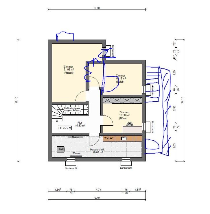

On the ground floor, I don’t think a large double door is necessary, which would give me enough wall space in the hallway and a bit more wall space for the kitchen, possibly for a side-by-side refrigerator.

I thought the bottom side faces almost west? So, northwest by west? Then there should be nice evening sun. Children are usually much less bothered by noise than adults, but of course, that depends on individual preferences.
Why do you actually need the storage room on the ground floor? It would make a great cloakroom. But if it’s only for storage, I would consider removing it. After all, you have a basement.
The utility room in the basement is almost 20 sqm (215 sq ft), which is quite spacious, but you can definitely add shelves and cabinets for storage there. Although I would arrange it differently. The room in the top right (playroom, but probably a second office?) should be aligned with the office. Extend the hallway a bit if there is no direct access.
And if you want to place the terrace in the corner to the right as shown, I would definitely move the light well of the fitness room upwards on the plan.
Please show the facade so we can see how these changes would affect it.

The utility/housekeeping room in the basement with almost 20 sqm (215 sq ft) is already quite spacious, but you can certainly add shelves and cabinets for storage there as well. Although I would organize it differently. The room on the top right (playroom, but probably second office?) aligned with the office. Extend the hallway a bit longer if there is no direct access.
And if you want to place the terrace in the corner on the right as shown, I would definitely relocate the light well of the fitness room upwards according to the plan.
Show us the facade so we can see how changes would affect it.
The ground floor storage room can also partly serve as a cloakroom, that’s true.
I don’t quite understand your basement layout, do you mean this?
