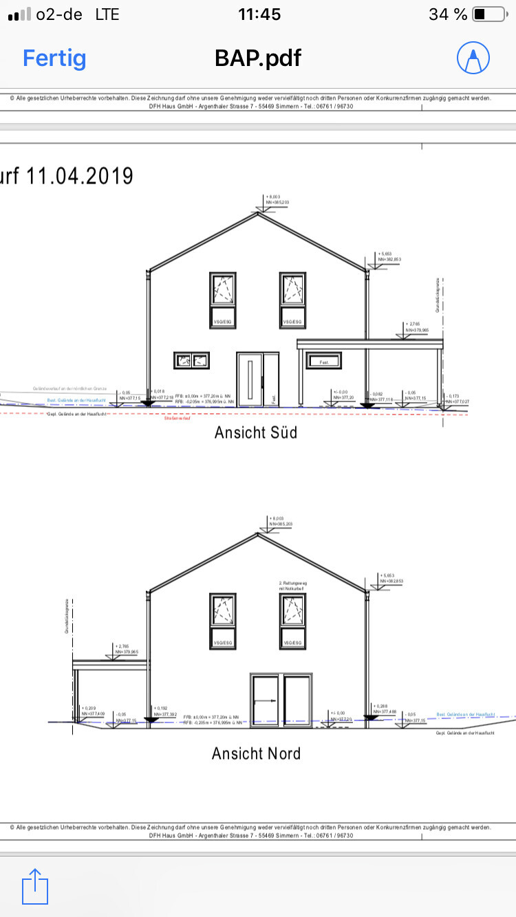

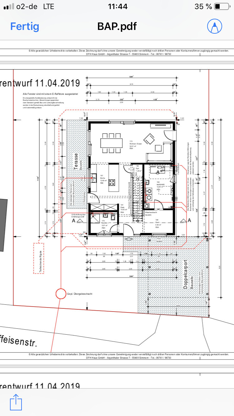

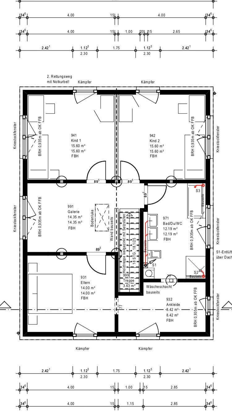

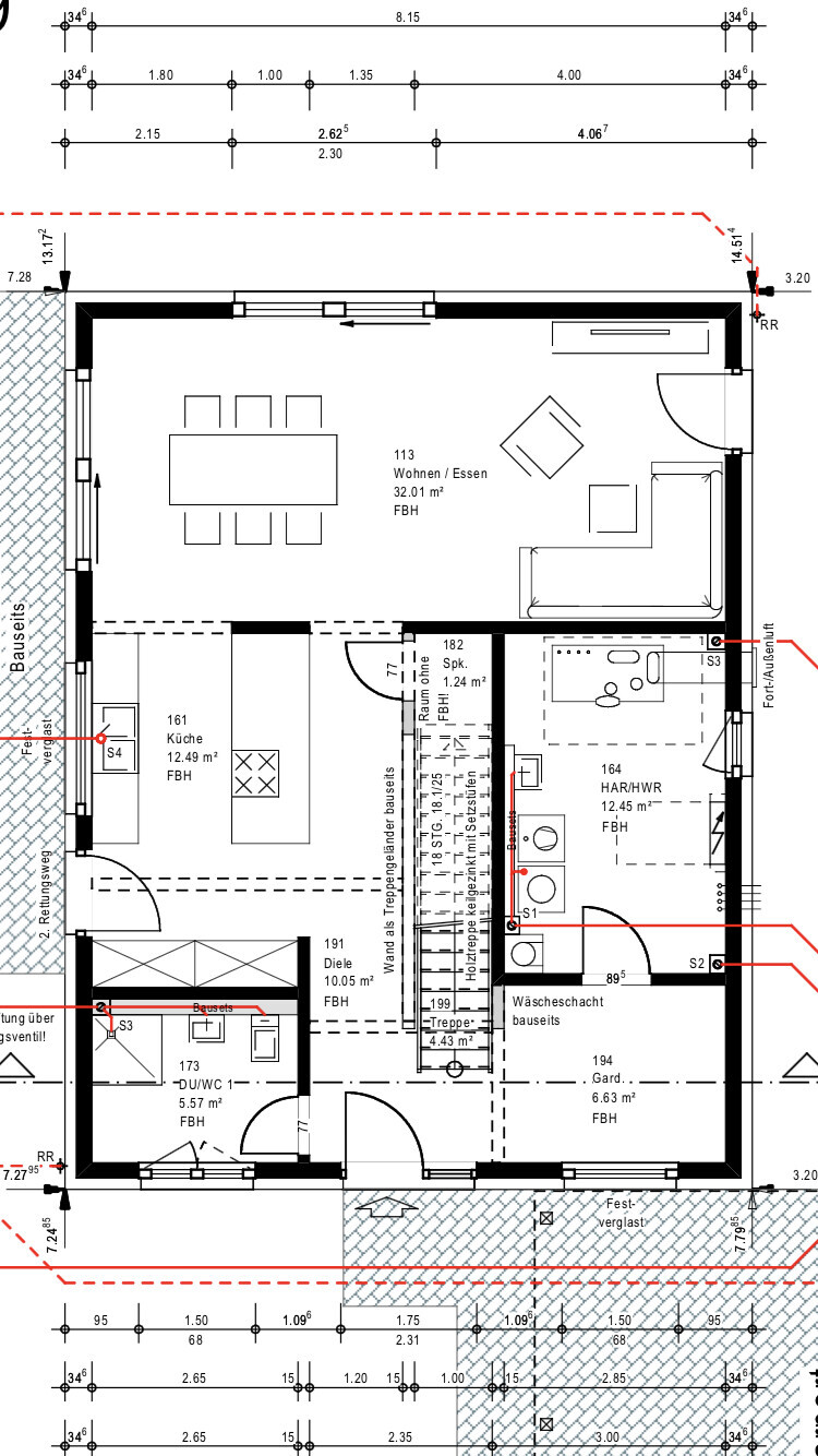

ManClaLen12 Apr 2019 15:15We liked every show home. That is why we decided on it.
ManClaLen schrieb:
We liked every model home we visited. That's why we chose that one. That's fine if it's a personal preference. For comparison: our living room is larger and we have a ceiling height of 2.65m (8 feet 8 inches). That's still comfortable. If you’re not taller than 2 meters (6 feet 7 inches), you’ll forget about it within a week after moving in. But it’s a good argument to negotiate if the price gets too high.
How do you access the attic? Only through a hatch? Then the storage space up there is hardly usable.
ManClaLen schrieb:
A seating bench is planned under the window in the cloakroom. One wall would be enough for us to place furniture there. tWhich wall do you mean? The one on the right side of the plan? If a wardrobe with a depth of 60cm (24 inches) even fits there – once there is a seating bench under the window, you wouldn’t be able to open the wardrobe.
ManClaLen schrieb:
We still have the attic as a storage room. How often per week will the staircase to the attic be lowered? And how much standing room do you have there?
Which door would the staircase block, preventing access to the rooms?
ManClaLen schrieb:
Behind the carport on the property boundary, a utility room with two sliding doors is planned. But that’s not for hobby equipment, right...
You are sugarcoating quite a bit here.
For me, the location of the guest toilet and dressing room alone would be reason enough to reconsider the design.
You mentioned the issue of orientation at the beginning. I wonder why this was not reflected in the floor plan?
Otherwise, with some adjustments to the windows and doors (not just placing them awkwardly centered, but thoughtfully... and also the terrace window on the north side makes the house appear unbalanced), this would be a good design for a north-south orientation.

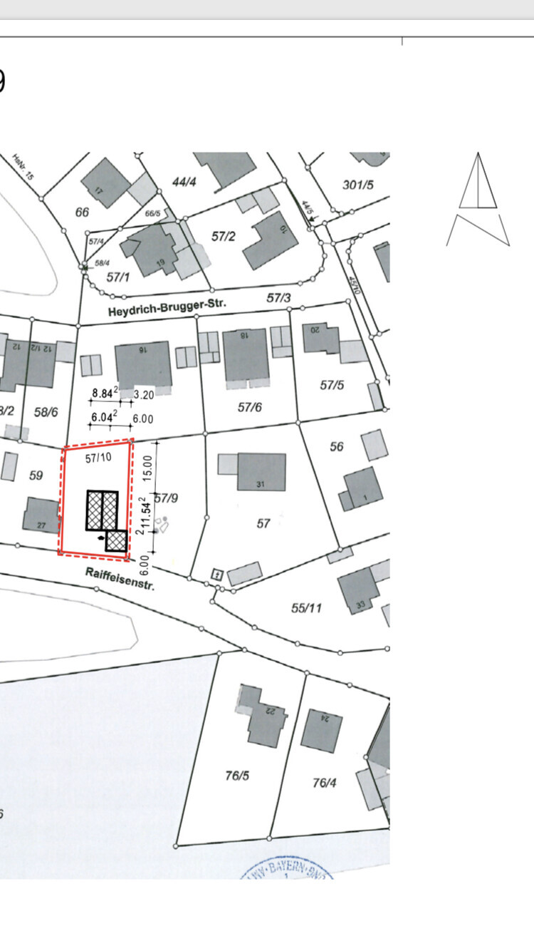

ManClaLen12 Apr 2019 15:50Yes, it’s difficult to combine everything.
Straight staircase, large utility room, no living spaces facing the street, kitchen/dining area facing the garden.
And the house must be located toward the lower part of the plot.
We have looked at many ideas; do you have any spontaneous suggestions?
ManClaLen schrieb:
Yes, it's difficult to combine everything. Especially the staircase, Get rid of the straight flight staircase, and suddenly even a narrow house works just fine.
ManClaLen schrieb:
We have looked at many ideas, do you have a spontaneous idea?Yes, entrance on the east side, with the open-plan living area along the entire west side, for example. Children's rooms at the front, unless there is a main road there. Further details will develop.
