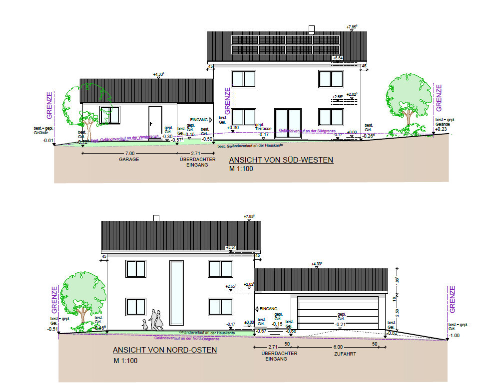

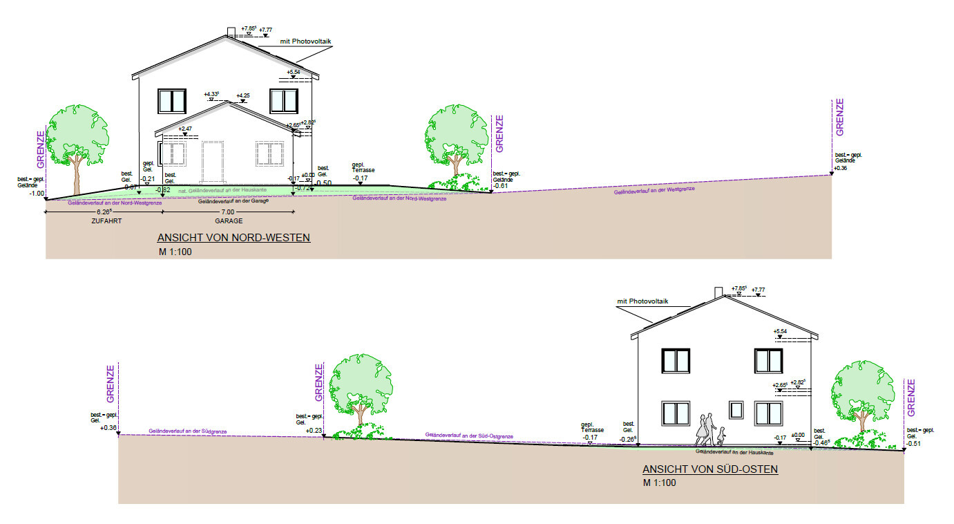

Here are the elevations
That could become quite tight if the double bed is placed against the stairwell wall. It’s best to try arranging the furniture first. Usually, you need at least about 3.40 m (11 feet) of width for the bed area. The door often gets in the way and can’t easily be moved, or else there won’t be enough space for the wardrobe.
The windows on the upper plan (northeast side) could still be optimized. However, with a gable roof, this is not very critical. The bathroom window on the ground floor interrupts the perfect layout—but maybe that’s not such a big issue. For those feeling bold, painting the frame bright pink is an option.

Yes, the windows on the northeast side are different sizes and unevenly spaced, but that was necessary inside because of the shower on the upper floor. It doesn’t bother us, and I think once built, it won’t be very noticeable. We definitely wanted a window in the bathroom. Let’s see if it ends up pink.
