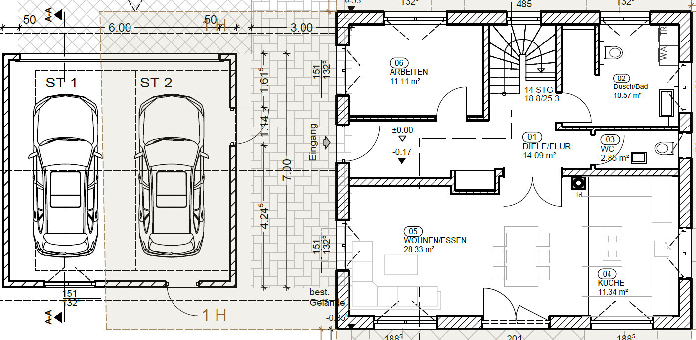

Although we already have our building permit (planning permission), I am still interested in how you would have done it and what you might have changed.
Development plan/restrictions
Plot size
: 1000m² (12,000 sq ft)
Peripheral development: only garage without windows allowed
Number of floors: two full stories
Roof type: gable roof
Architectural style: modern
Orientation: northeast, so the garden is in the southwest
Client requirements
We wanted space but no wasted rooms, like some houses with, for example, a gallery. A large living-dining area, since that is where we spend most of our time. The office must be on the ground floor, and we also wanted two bathrooms downstairs because when we are older, we want to live only on the ground floor. A basement is within the budget and needed to accommodate the pellet heating system and pellet storage. We are a family planning for two children. The family planning is complete with the second child.
Style, roof type, building type: modern, gable roof
Basement, floors: basement, two full stories
Number of people, ages: 2 adults, later 2 children: 27, 31 years old
Space requirements on ground floor, upper floor: about 75 m² (800 sq ft) each
Office: home office
Guests per year: 2–4
Open or closed architecture: rather open
Conventional or modern construction: modern
Open kitchen, kitchen island: open kitchen with island
Number of dining seats: 6
Fireplace: no
Music/stereo wall: no
Balcony, roof terrace: no balcony, possibly a covered terrace later
Garage, carport: garage
Utility garden, relaxation garden, snack garden
Other special features
Photovoltaic system
Who designed it
What do you especially like? Why?
We really like the floor plan.
What don’t you like? Why?
Maybe some space is wasted? Living-dining room could be too small?
Price estimate according to architect/planner: 450,000€
Personal price limit for the house, including equipment: 530,000€
Heating technology: pellet heating and underfloor heating, electric heater so the photovoltaic system can also heat water with electricity
can you not live without
Ground floor bathroom, office
Why is the design how it is now?
Individual planning
Requesting opinions on room layout and floor plan design
Lisa & Udo
The driveway is on the north side,
The living-dining-kitchen area is on the south side
Ground floor + garage with covered passage
Floor plan of a house: double garage on the left, entrance area, hallway, living/dining, kitchen, bathroom, toilet.

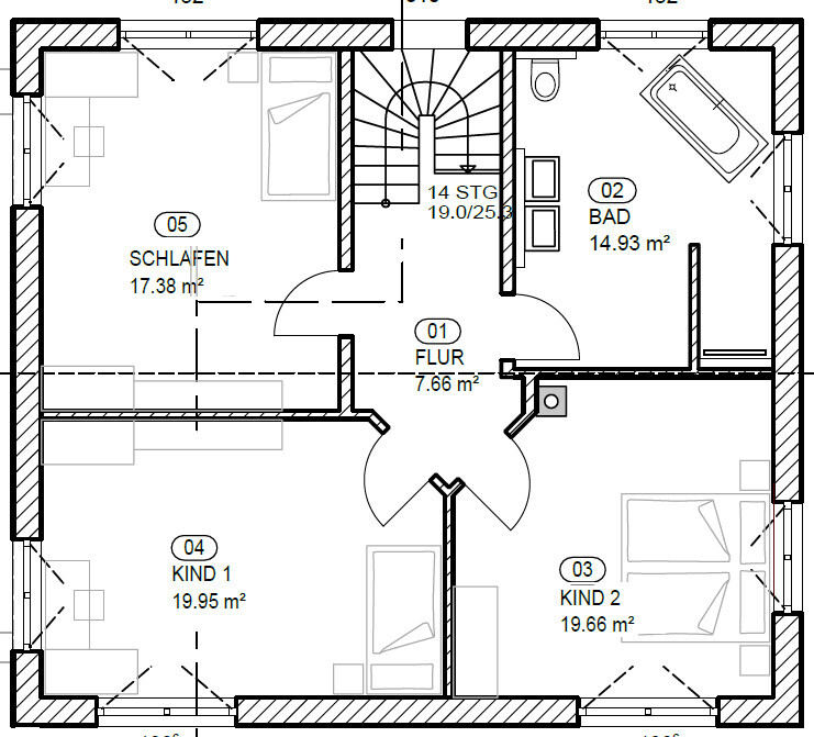

Upper floor
Floor plan of a house: central corridor with staircase, bedroom, bathroom and two children’s rooms.

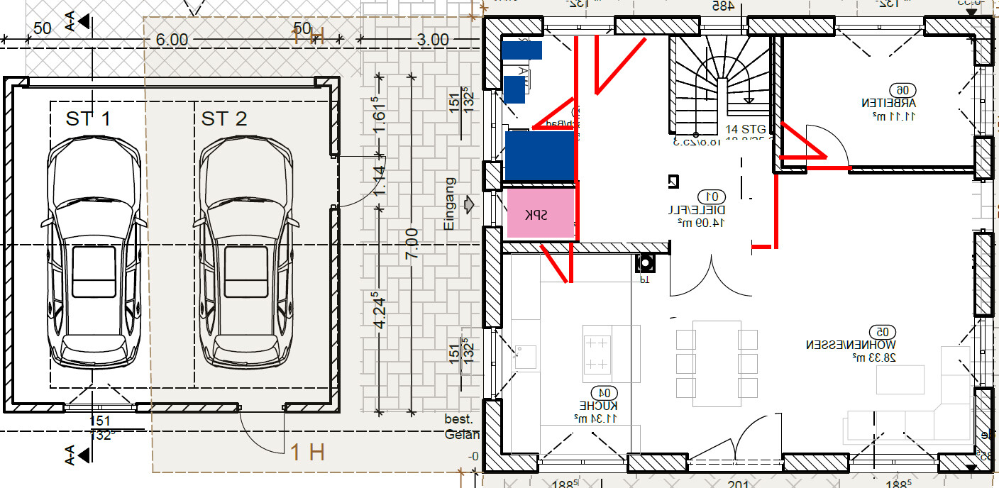

How large would the ground floor bathroom be then? What size would the wet room be? 2 sqm (22 sq ft)? Hmm... I’m a bit lost.
We need to see how it works out...
Just a very rough sketch to clarify what we mean:
Floor plan of a house with double garage on the left, entrance, stairs, open kitchen and living area on the right
The kitchen would likely be placed in the recess. I just wanted to show how much space would be created in the open living area.

kaho674 schrieb:
Just a very rough sketch to make clear what we mean:
[ATTACH alt="Beispiel.jpg"]45538[/ATTACH]
The kitchen would be placed more in the recess. I just wanted to show how much space would be created in the open-plan area.
Oh, thanks a lot for the effort, but we would prefer to keep the front door where it is.
We did move everything around quite a bit at the beginning as well.
