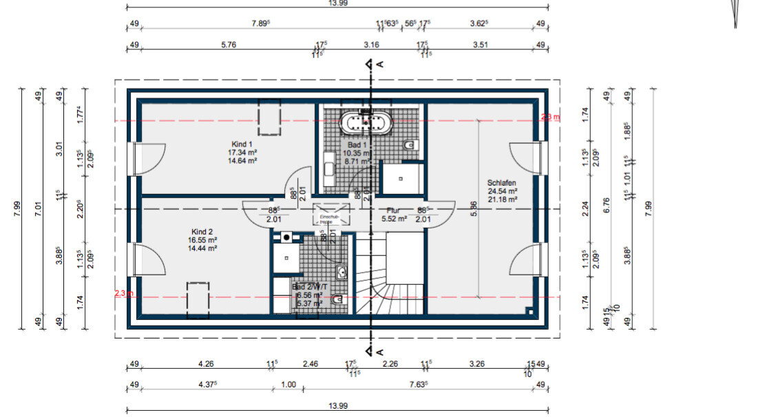

Hello dear forum members,
We are now a family of four and are finally ready to fulfill our dream of owning a home. We already have a plot of land and a general contractor who will build with us. Over the past few months, we have been tirelessly reviewing plans and gathering information. We have now reached the point where we have an approved building permit / planning permission. So, the basic parameters of the house are basically set. However, as we approach the final approval of the detailed planning, we are starting to doubt whether we have been too focused on our own ideas for too long.
The floor plan has caused us quite some headaches because the plot is only 14 meters (46 feet) wide, which means the maximum width of the house is 8 meters (26 feet). We also wanted a fireplace in a spacious, open living area. With large windows and hopefully plenty of natural light, we aim to create a friendly atmosphere. By the way, in the screenshots, the south side is shown at the top.
This resulted in the attached floor plan. One challenge is definitely having enough space for wardrobes and other furniture. According to our current visualizations, this seems to fit reasonably well. To improve this even more, we have already decided to slightly reduce the widths of the windows on the south side.
We are still unsure about the "corner" in the study. We could either place a desk or a bed there, but it would also be possible to close the wall and, with an entrance from the hallway, create a separate wardrobe. Another point is the rather large bedroom—which will not have a separate dressing room—but as a large room it is also somewhat difficult to furnish.
We would be very grateful if you could take a fresh and unbiased look at the floor plan and provide your comments.

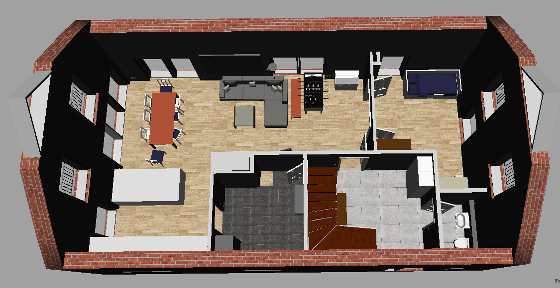

Obstlerbaum2 Nov 2018 16:34The living room corner with the passage to the study could be difficult to furnish. I also don't think giving the child a northeast-facing room is particularly ideal...

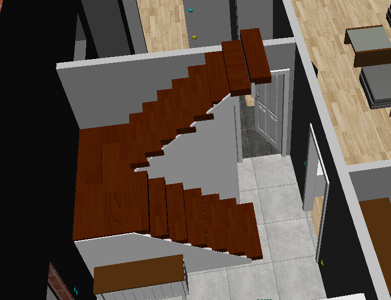

Stairs / Entrance Area: We had not considered the concept of a landing staircase for our house before. This could indeed help us avoid the “dirt zone” in front of the entrance door and maybe even allow for a wider door in the utility room (but see the point below). We might then replace the window currently planned right next to the door with a higher one above the landing. This could free up some space next to the door.

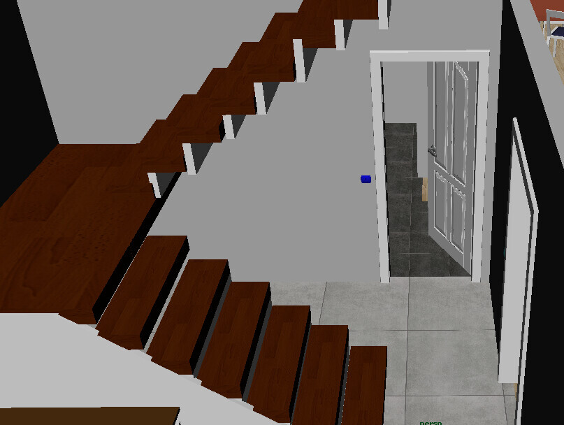

Landing Staircase: We just tried to visualize it. If we implemented it correctly, the space between the stairs and the living room becomes quite tight (80cm (31.5 inches) between the step and the wall to the living room). The landing at the top also needs the width of a normal step, right?

Door to the Utility Room: While visualizing the landing staircase, we realized that it could definitely be replaced with a wider door.

For me, there are 3 main issues that bother me.
1. The sofa placement is awkward. Why is there such a large door to the guest room? Couldn’t you use a regular-sized door and then place the sofa against the wall?

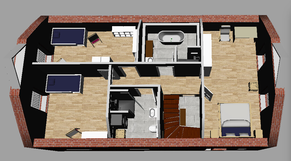

2. Why is there no walk-in closet? It seems like a great opportunity here to create one, which would help prevent the room from feeling overwhelming due to its size.
3. The upstairs hallway is only a few centimeters wider than a door, which I find way too narrow. The house can’t be any wider, but then I also don’t see an extra bathroom for the kids.

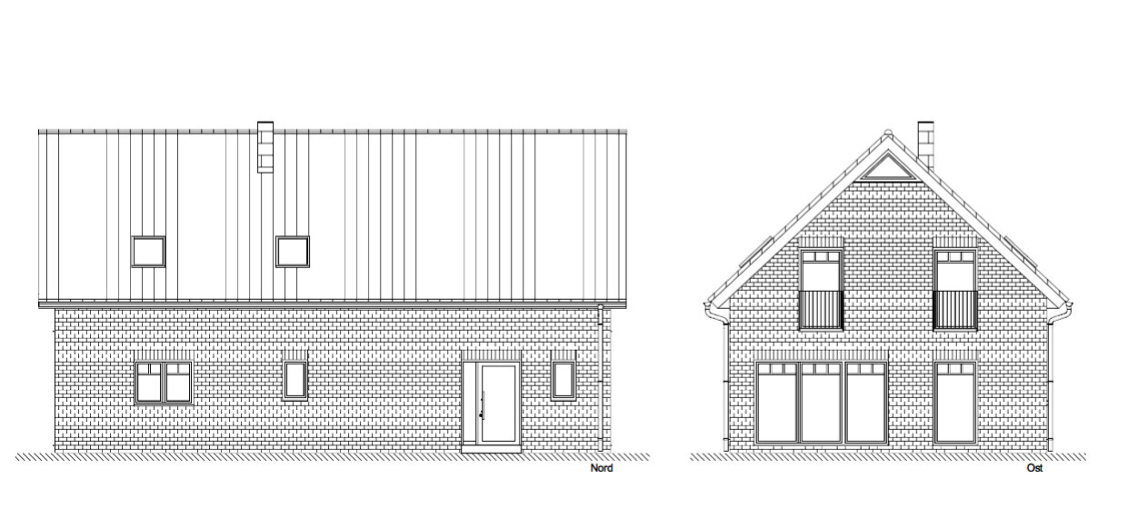

Do you really want standard doors that are 1.98 meters (6 feet 6 inches) tall? Nowadays, 2.11 meters (6 feet 11 inches) is more like the new standard.

If any of these changes appeal to you, you should quickly apply for a modification permit for other windows. This usually isn’t a problem and is faster than the standard application.
I would also equip the upper floor with a walk-in closet, as @kaho674 initially designed.
I would swap the rooms downstairs but keep the utility room as is. The mentioned corner becomes a cloakroom with a door. The office and kitchen would be exchanged, as well as the living room and dining area. This way, the private area is placed at the back, and the dining area functions as a walkthrough room.
