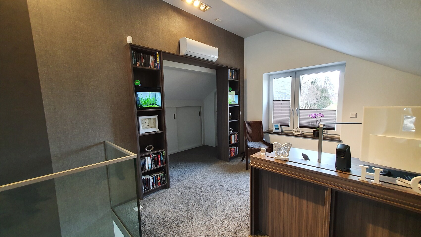

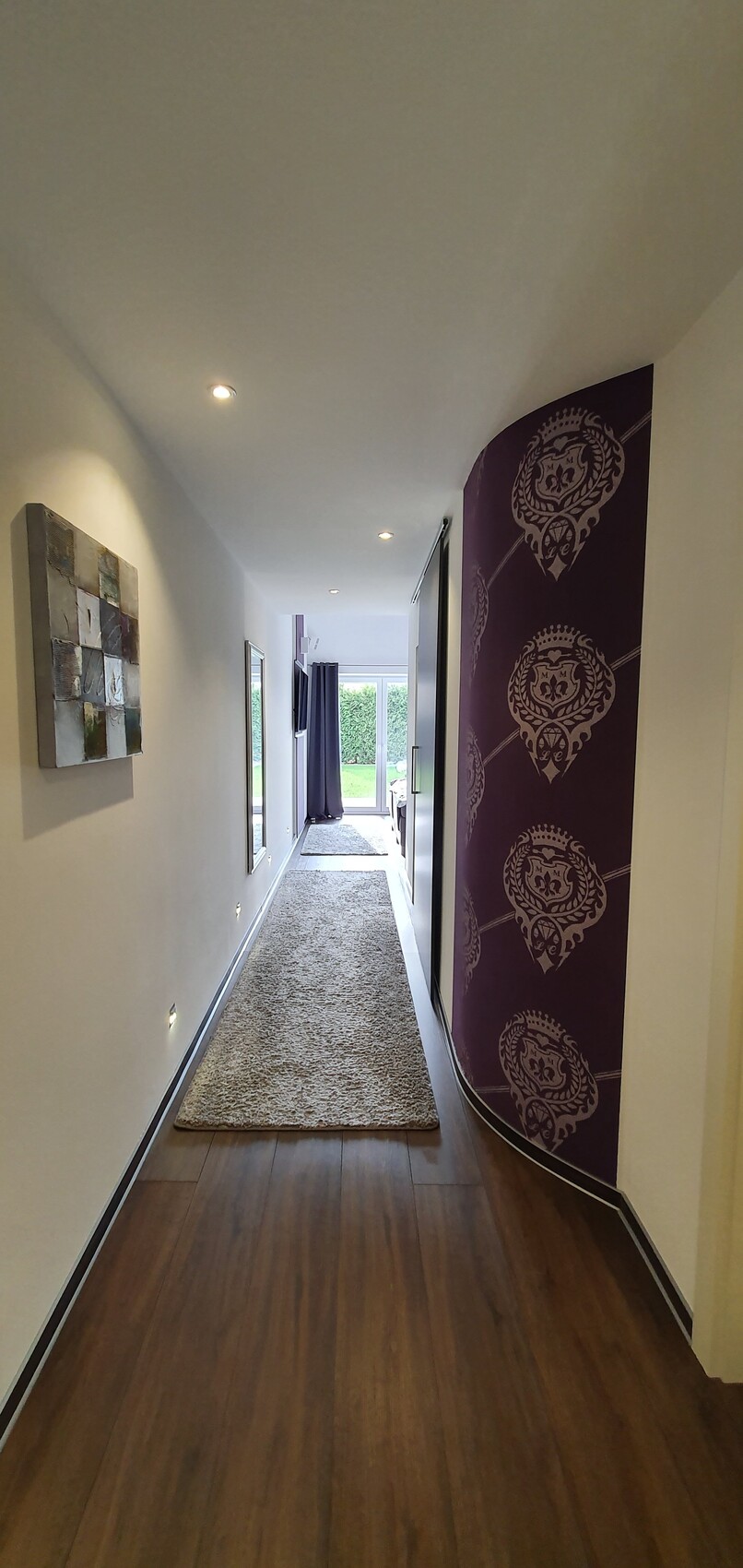

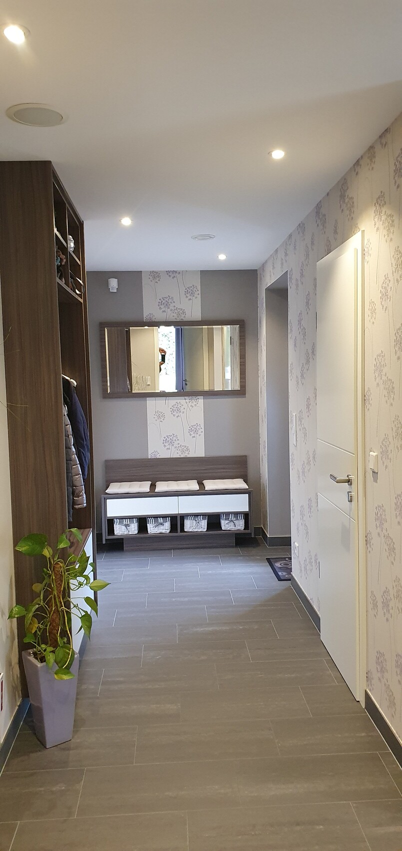

For anyone interested,
I added some more photos of the old house. All furniture is custom-made and built into the walls.
