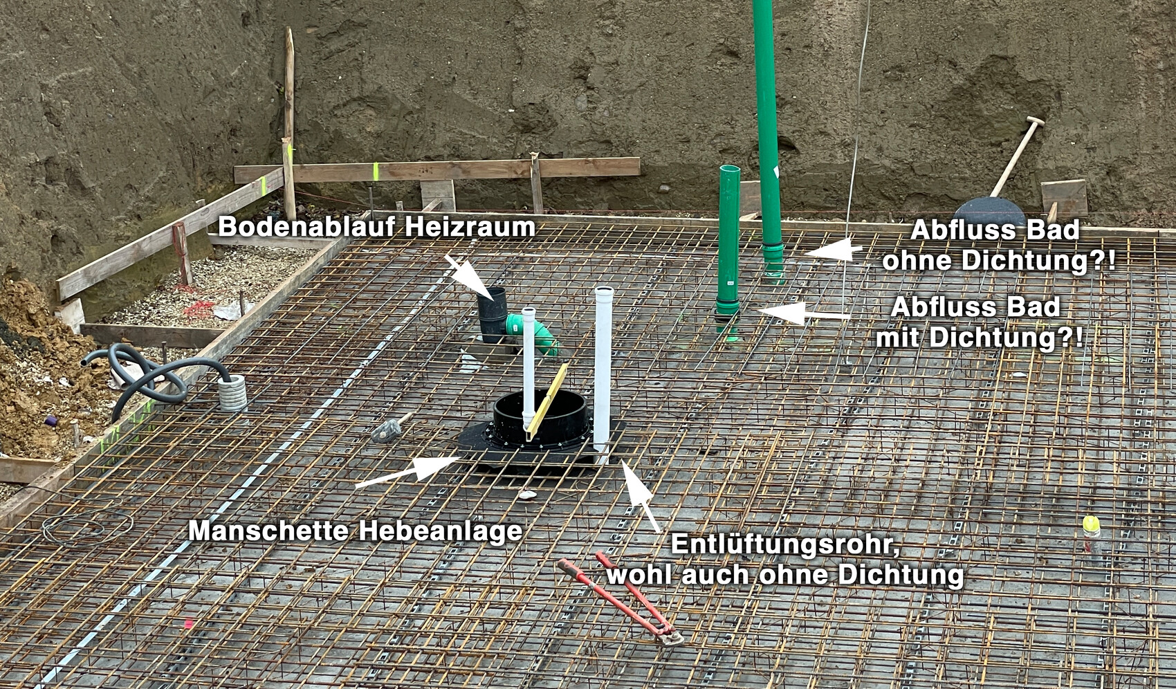

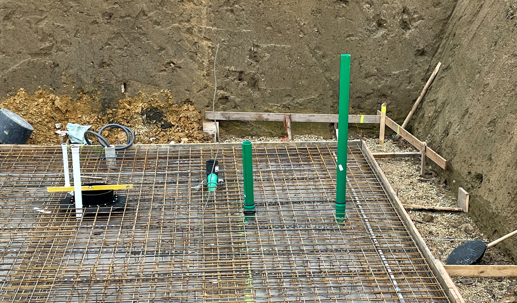

After reviewing some photos from the construction phase, we noticed that the pipes installed, except for one, apparently lack any seals. One pipe has some kind of black collar, but the other two do not show any sealing.
Do you think it is possible that water is pushing up past the pipes? And can this really cause such large amounts of water and spread across the entire slab? Since all walls are wet, the water must have reached everywhere.

After living in our new house for almost two years without any significant problems or defects, we unexpectedly discovered water damage in the basement the day before yesterday.

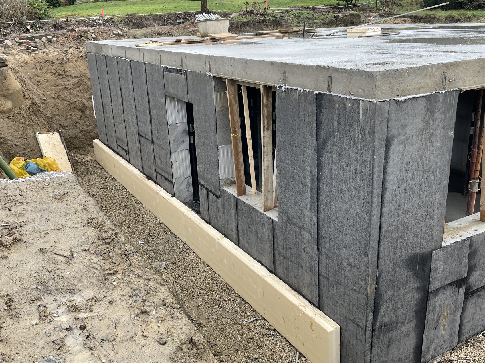

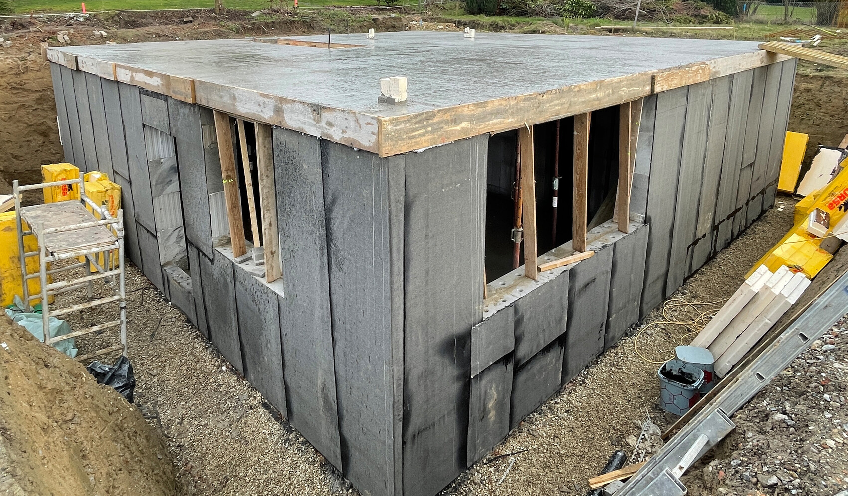

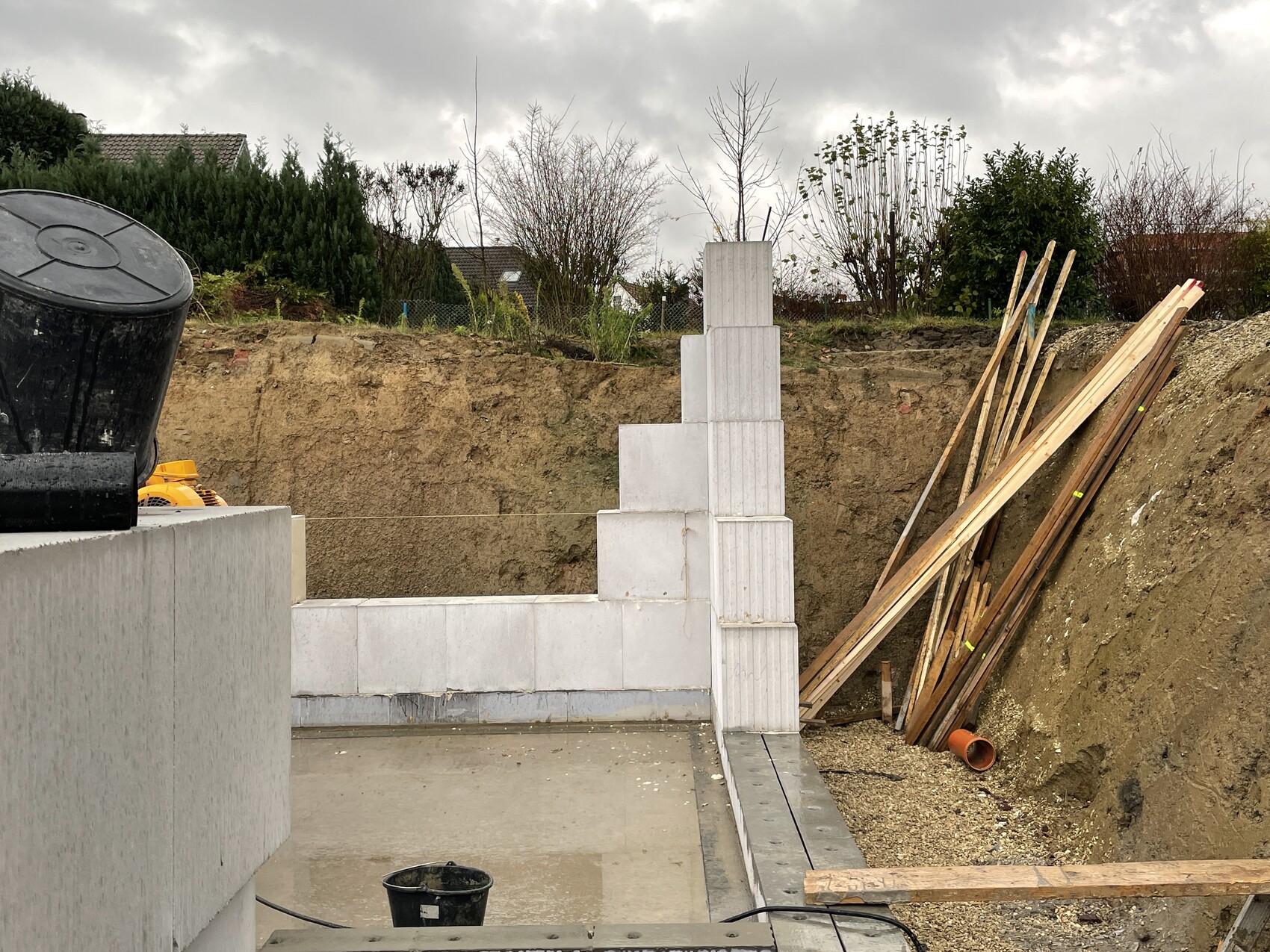

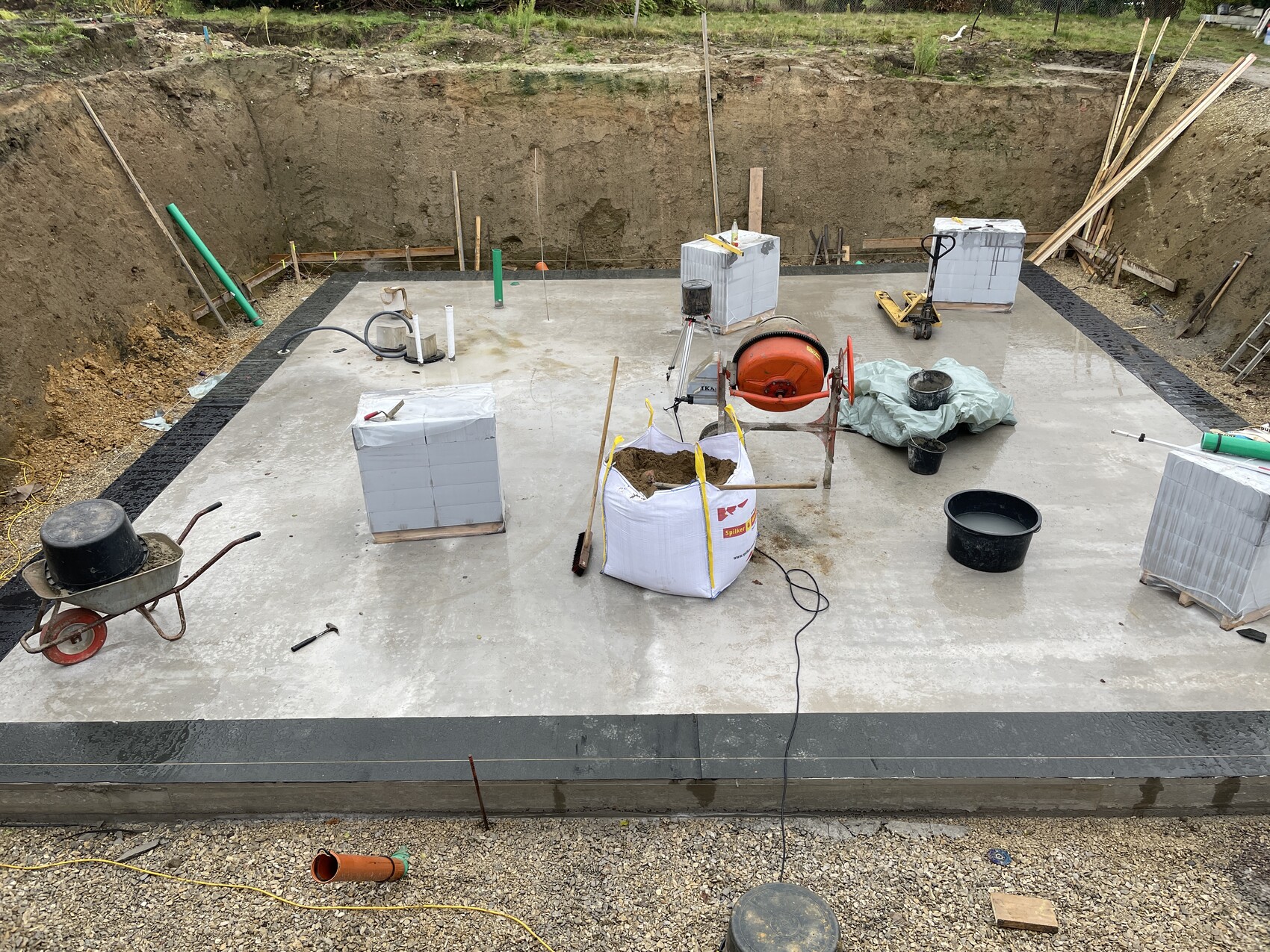

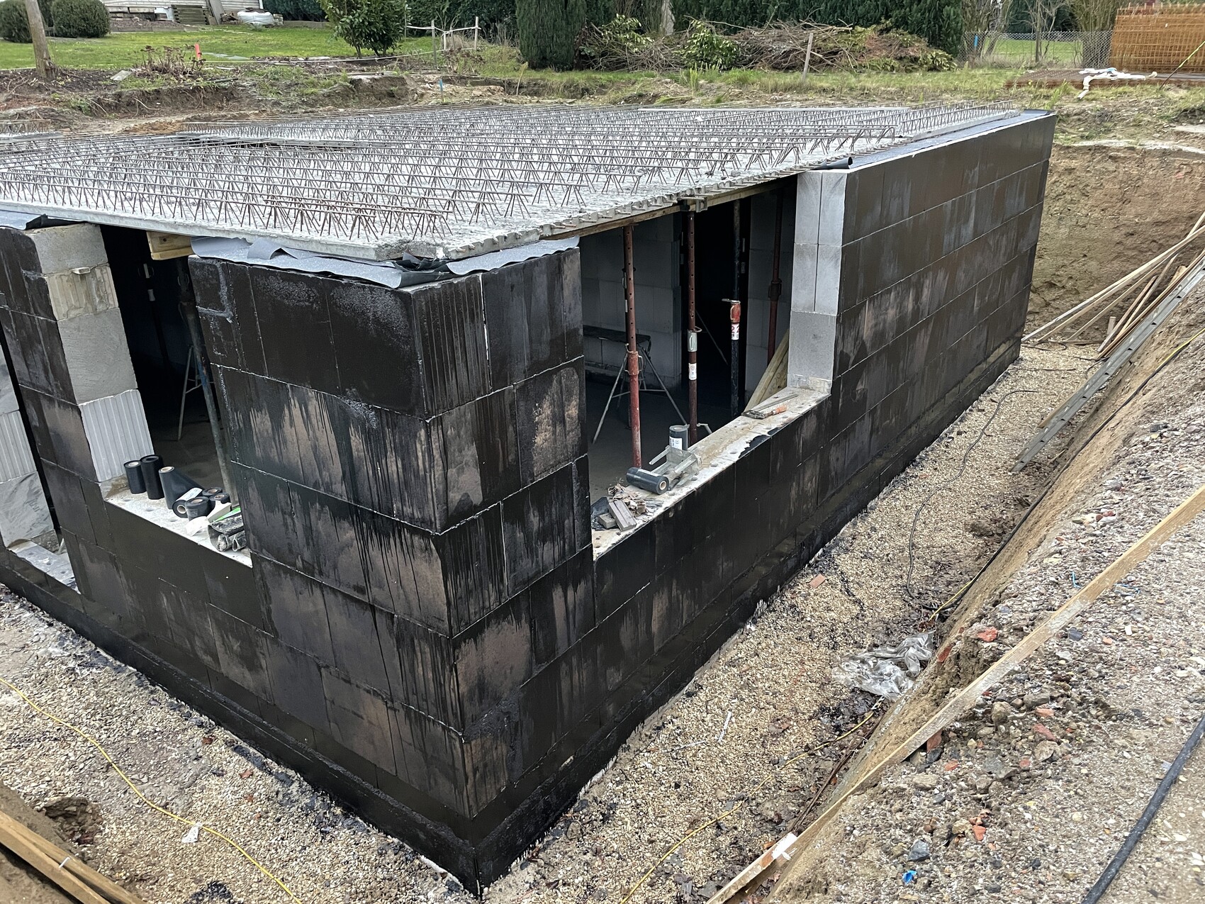

After soil tests showed that there is no groundwater pressure, it was decided to build a masonry basement. The reason was that, due to the basement apartment (commercial area), there is a lot of flush-mounted electrical installation in the exterior walls, which is somewhat more difficult to do in watertight concrete.
A strip of roofing felt (?) was placed under each wall on the slab. Additionally, after the first course of blocks ("damp-proof course"?), a waterproof slurry was applied as a barrier – this seems to be working well.
The entire basement was then coated twice from the outside with a black sealant and finally waterproofed with roofing felt. The felt was welded up to the bottom edge of the slab. Afterwards, the soil was insulated with EPS boards.
OWLer schrieb:
What do the basement walls look like? Are they also made of watertight concrete?
Are there any photos of the completed (poured) basement from the outside?

hanghaus20236 Jan 2024 14:27You live in the northwest—doesn’t that area also experience flooding due to heavy rain? Sometimes the groundwater level rises higher than expected there.
Well, that’s unfortunate now. If the bitumen layer was damaged somewhere during backfilling, it could potentially push through not only along the pipes but also through the walls.
A professional expert would definitely be the best option for a solution. It might also be worth talking to the building insurance company to see what can be done.

Even if the report states that there is no groundwater, the design water level for impermeable soils should be set at the level of the ground surface (GOK).
Impermeable soils have a hydraulic conductivity (Kf) value of less than 1 x 10⁻⁴ m/s.
So, if there is no clean sand or gravel, the soil is not permeable. Here, it looks like clay... by excavating the basement pit, a basin has been created that will fill up first during heavy rainfall and cause hydrostatic pressure.
Therefore, it is essential to have the soil report checked carefully.
You can also upload parts of it (layer descriptions and soil parameters, building waterproofing).
No additional drainage was installed, right?
