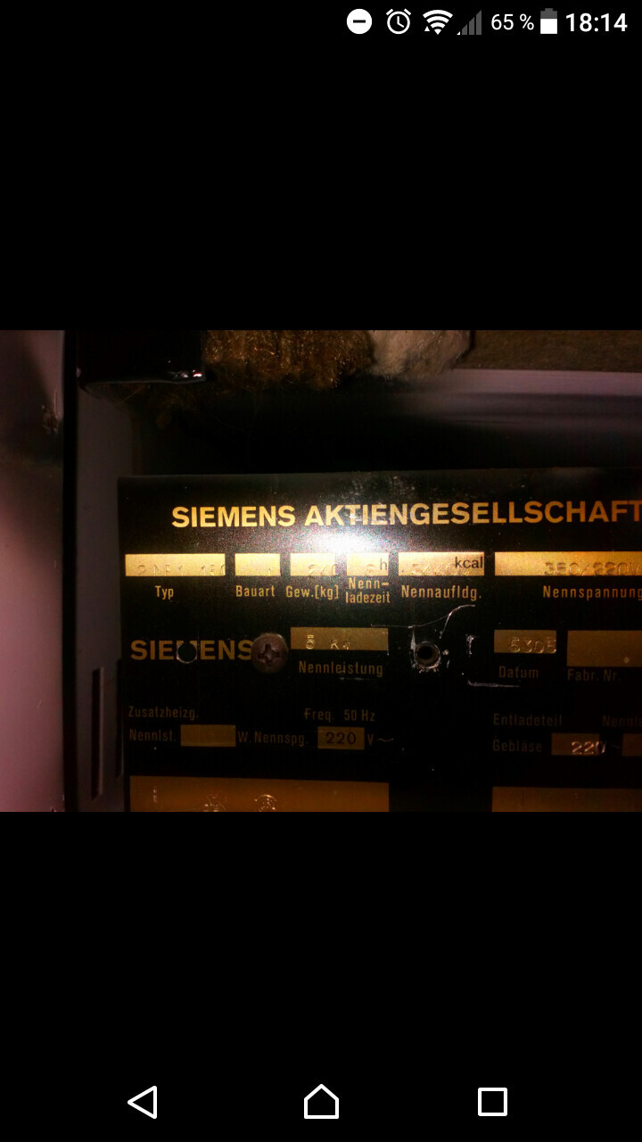

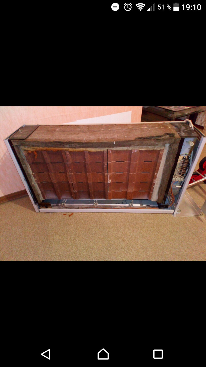

I have a question about the storage heater. We have a Siemens storage heater model 2NF1 150. The nameplate was located under the casing. Is this model asbestos-containing? I hope not.
Has anyone had any experience with this?
I have attached two pictures. This is how the heater looks now. Is it better to have a professional dispose of it?
Thank you very much & best regards

You can assume there is a significant amount of asbestos present.
