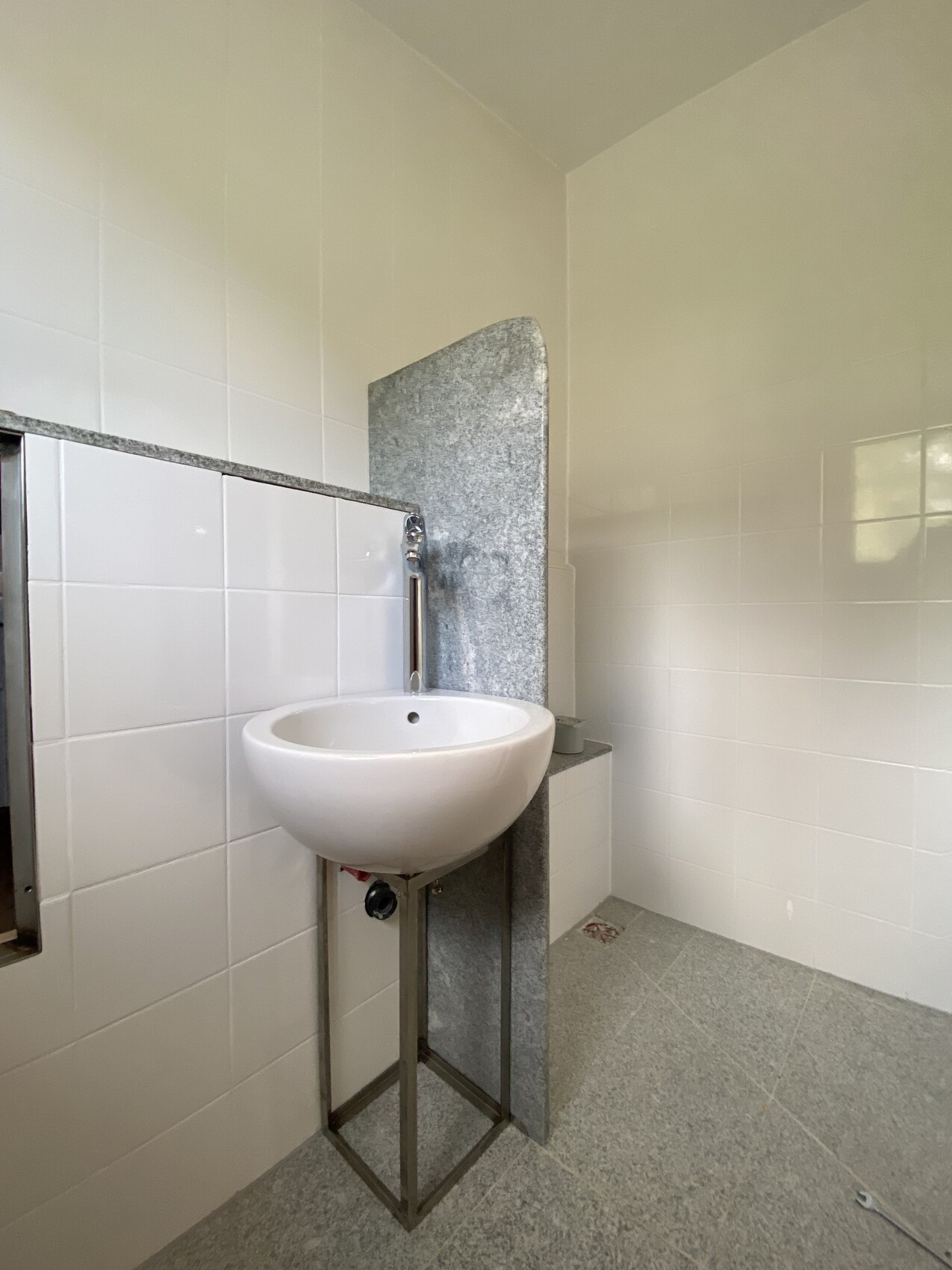

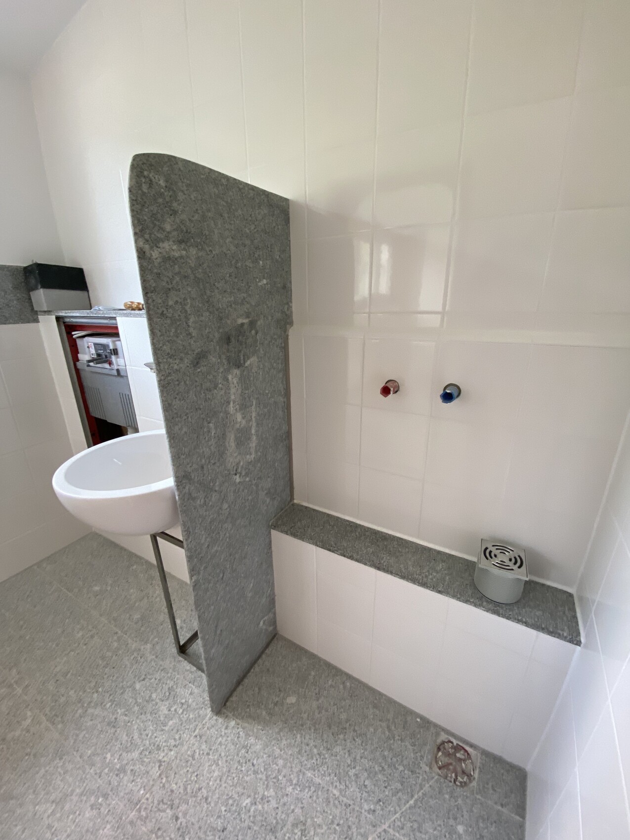

Progress has been slow due to the pandemic and it will still take some time until completion. (At the moment, I’m comfortably sitting on the sofa with a fractured foot bone. It doesn’t hurt, but it’s quite inconvenient. I’m practicing patience for old age (I’m still a young 71 years old). The mindset just has to cooperate… 😎
Here are some photos of the current stage.
I’m curious to see if it really keeps the water out. At least it looks good.

The good thing about natural stone like granite is that you can always restore the surface to look “new” again.
I prefer to do a proper job once every many years (in the worst case, sanding it down) and otherwise leave it alone (or take a break).
In any case, you will see the lime scale on granite much later than on glass.
Fermacell and tiles were considered because that might have been less labor-intensive.
The sanding work on the granite was no fun, and looking back, I didn’t do it very carefully either.
... but you can hardly see that at all ...

... but I cannot confirm it 😎
In another bathroom in the same house, there have been two granite slabs on the right and left sides of the shower for years. They are rarely "maintained" and still look flawless.
My experiences don’t have to convince anyone, but I’m happy to provide some inspiration 😉
