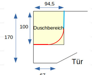

I would like to suggest two options. However, they might not be suitable since the bathroom layout is unknown.
Two floor plans of a shower area with a door; dimensions 94.5×100 cm (37×39 inches) and 67 cm (26 inches); red cross on the right.
This also works well with a wall and a shower curtain.
Please try to sketch to scale more accurately in the future.

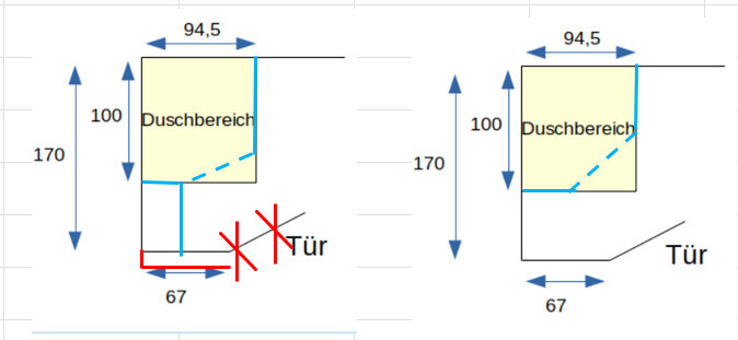

A corner shower might also be an option.
Two floor plans of a bathroom with shower area; left door removed, right door open.
There are five standard models of corner shower enclosures.

A sliding door option is also possible, but it is quite an expensive solution.
In my opinion, the most effective and practical solution is a partition wall of 81cm (32 inches) or shorter made of frosted glass, combined with a shower curtain if a quarter-circle shape is desired.

Floor plan of a bathroom with shower area and door
Red shower curtain. It goes into the washing machine when needed. On the satin shower wall, you can’t see any drops or limescale residue from the outside. So, it’s quite easy to maintain. The door also doesn’t affect the shower curtain.
