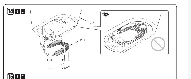

See the picture from Toto:
nordanney schrieb:
Electricity and water come through the wall and are routed to the toilet from behind/below. You don’t see anything.
In the form of an outlet and a valve? Or does a flexible hose need to come out of the wall? Water connection. Unfortunately, the drawing doesn’t show this.
nordanney29 May 2024 18:26In der Ruine schrieb:
In the form of a socket and a valve? Or does a flexible cable have to come out of the wall? Water coupling. Unfortunately, the drawing doesn’t show that.Check online for all the Toto products. They always have installation diagrams. It actually comes out of the wall via a hose and coupling or an electrical cable.Thanks for the tip. Toto is out of my price range at €2,000. Also, I’m wary of using a flexible hose inside the wall, as I’ve seen broken hoses quite often. I would prefer to have a pipe running all the way up to the top edge of the tile.
