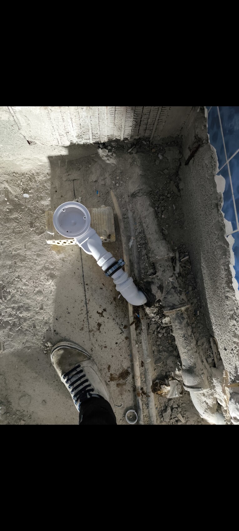

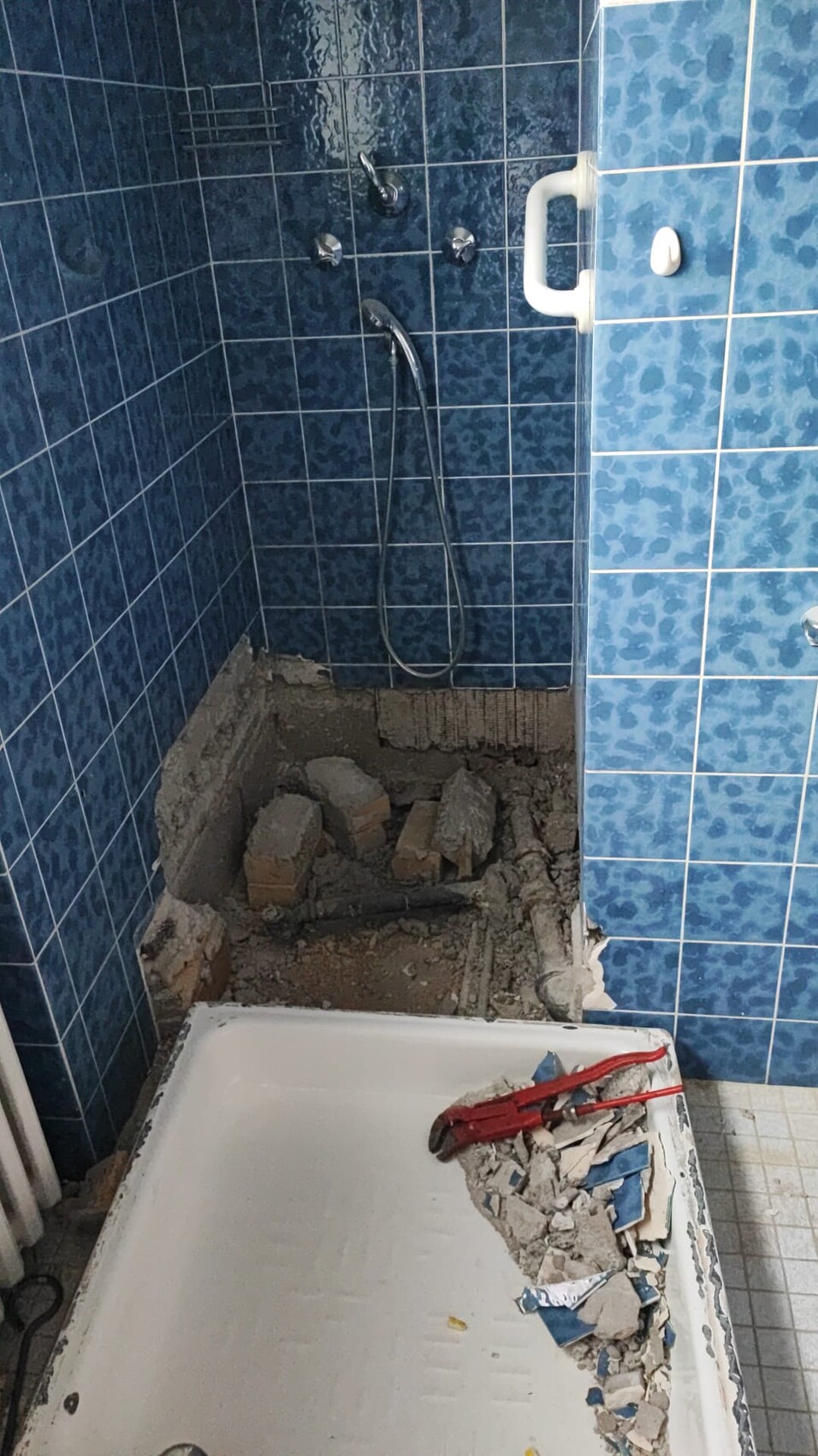

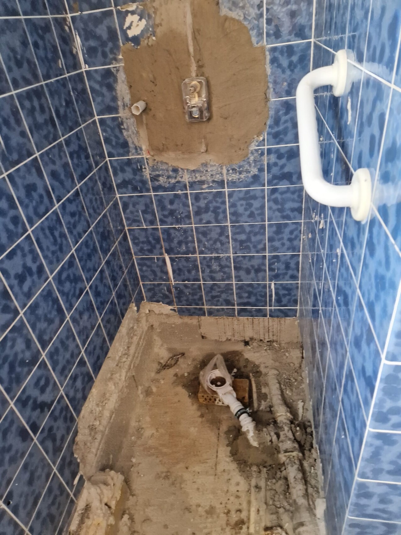

We have an older building from 1964.
We want to install a walk-in shower. The problem is that we have to build on top of the existing pipes (drainage, supply), meaning it needs to be elevated.
I could simply lay everything with bricks and fill it with screed, but I prefer not to, because if something leaks or breaks, or if we need to renovate the water pipes, I would have to break everything up again. The walk-in shower will be tiled, so a linear drain needs to be integrated.
Do you have any ideas on how to best build everything higher with minimal effort for future access, while integrating the shower drain? The walk-in shower should be 130cm (51 inches) long and be accessed by a step. The current dimensions are 75 x 75cm (30 x 30 inches).
So far, I have done all the work in the house myself and can handle most tasks well. For this, though, I need your tips and experience.
