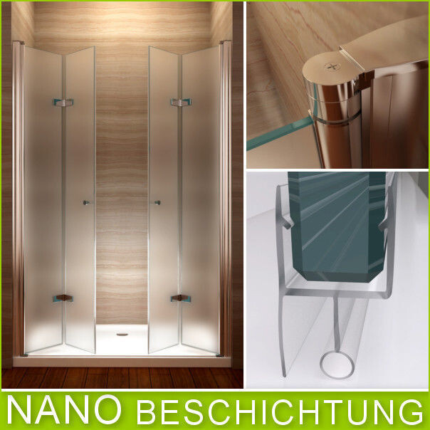

As outlined by kaho in #13, this is already a good starting point for the design. Move the door slightly further to the left. Position the shower fitting on the right side according to the plan and install a drain there. Normally, I would leave it open and, if necessary (for showering!), use a shower curtain. Just kidding.
Even better: install a double folding glass door running from the top of the plan all the way down. That is, two sections folding from the top and two from the bottom. When not in use, they can be folded against the wall at the top and bottom, and when in use, you get a relatively spacious shower area of about 75–80 cm (30–31.5 inches) by 140 cm (55 inches). I’m thinking of something like this
The trick is that the shower fitting must not obstruct when folded away, so it must definitely be on the right side!
