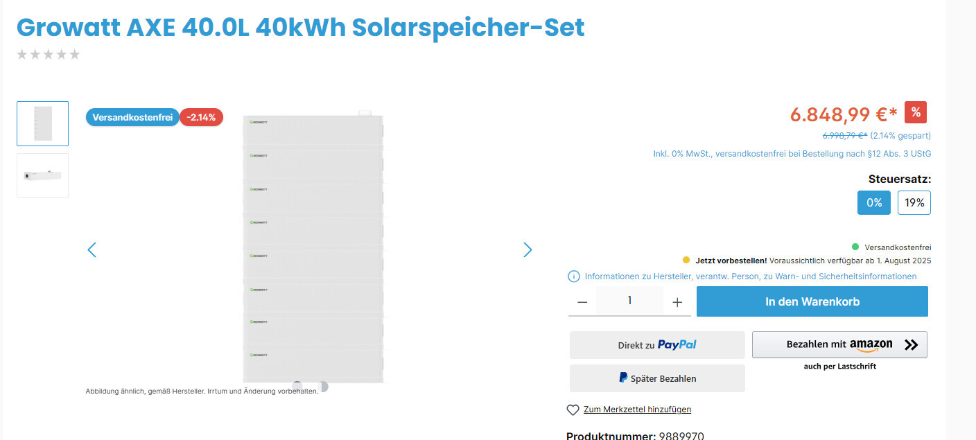

nordanney4 Jun 2025 23:23Bierwächter schrieb:
I have never really read about systems that large before, usually only up to about 11 kWh, so I never considered bigger storage. I was also assuming around $500–600 per kWh, and unfortunately, we have to watch our budget when building the house. Just to show what is possible...
That’s why I mentioned a large storage system. You shouldn’t spend more than 10k for 25 kWh.
Or as a low-voltage option (which is generally less preferred due to some disadvantages).
