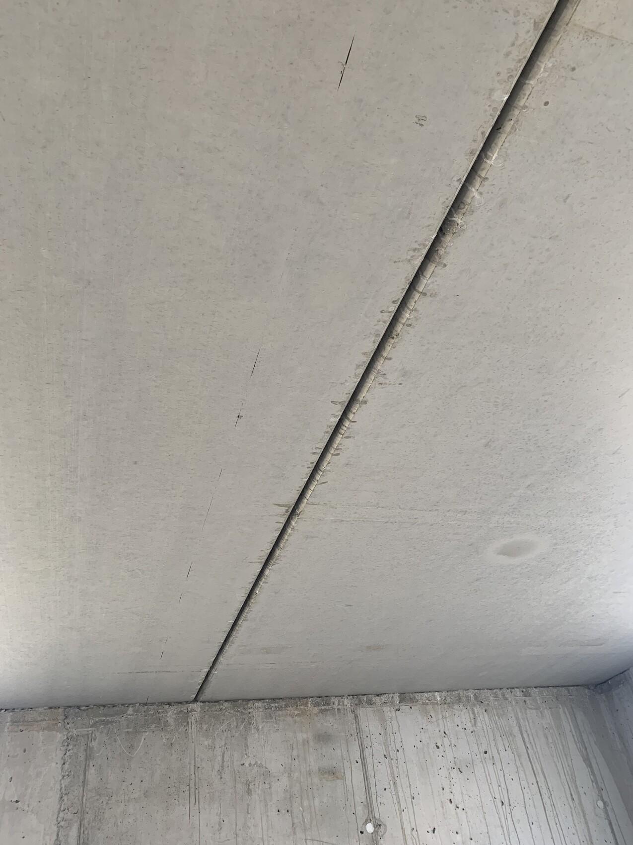

clausen7710 May 2022 11:42I have to say, @la.schute’s work looks really excellent! I’m also curious about the ceiling height.
Here are a few pictures of our main basement room. I think we’ll play it safe and paint the ceiling white after all. With a ceiling height of 265 cm (105 inches) [285 cm (112 inches) minus 20 cm (8 inches) floor construction], it feels too risky otherwise. The black spotlights and switches will still be installed though :-)

clausen7710 May 2022 16:06Tolentino schrieb:
It looks very clean and smooth for you. For me, it all looked much patchier and definitely like a rough construction stage.
Or have you already gone over it once with a sanding tool?No, nothing has been done to it yet.F

The question should rather be how it looks in the combination of (smooth wall and untreated concrete ceiling)?Like a basement: (with filled joints) provisional and unfinished.11ant schrieb:
Where do you see visible joints there?About every 2 meters (6.5 feet), see @Tolentino Tolentino schrieb:
This room is about 2.75 meters (9 feet) wide...

It looked like this for us as well. We then painted the ceiling white. The result is okay. bowbow91 schrieb:
We are currently planning to leave the ceiling in our living area as exposed concrete.Exposed concrete is definitely different from normal precast concrete ceilings. It looks quite untidy, more like something attempted but not mastered.Unfortunately. I would have liked that too. But you really need the height of about one or two more course of blocks (brick layers) for that.
