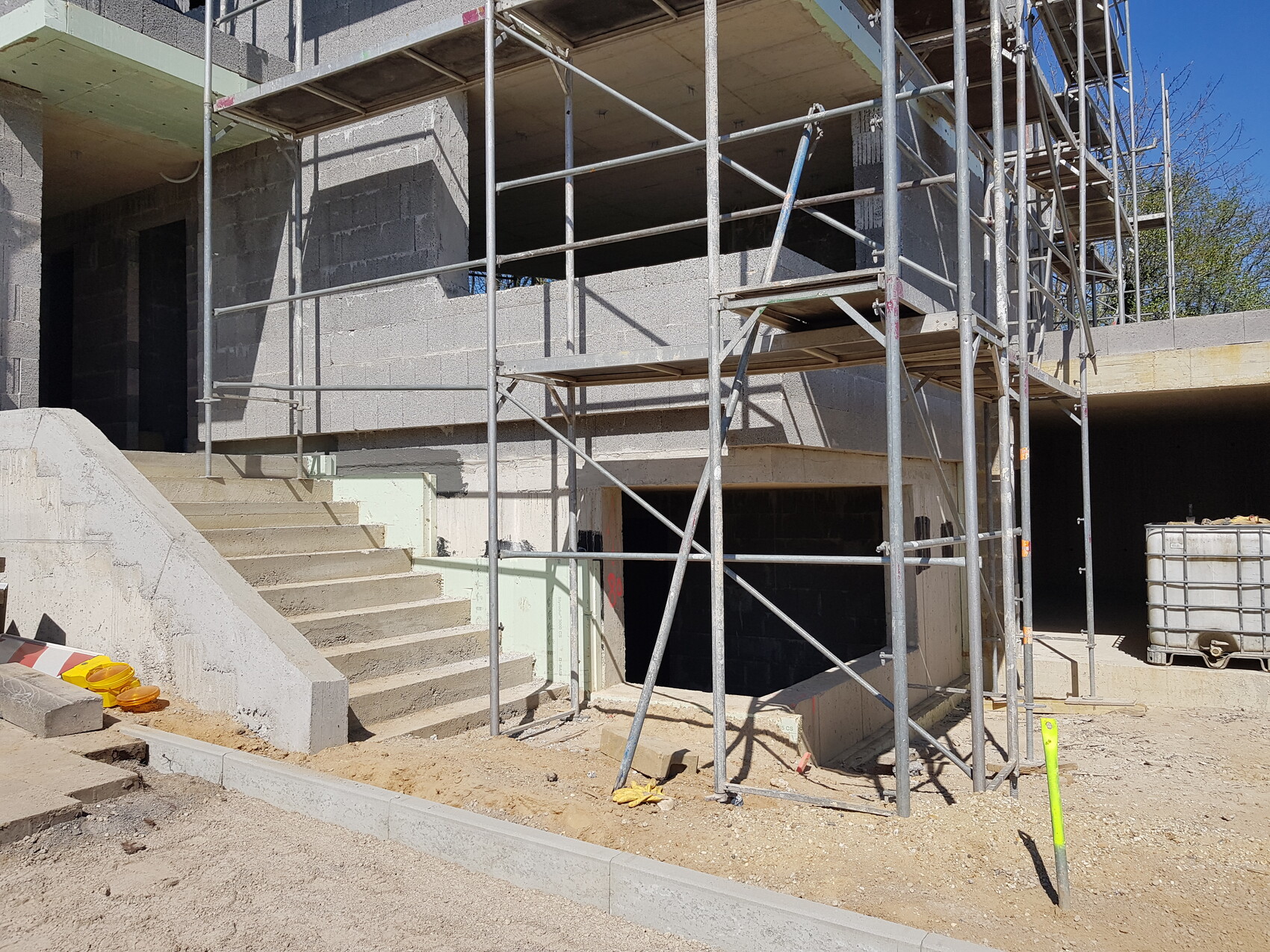

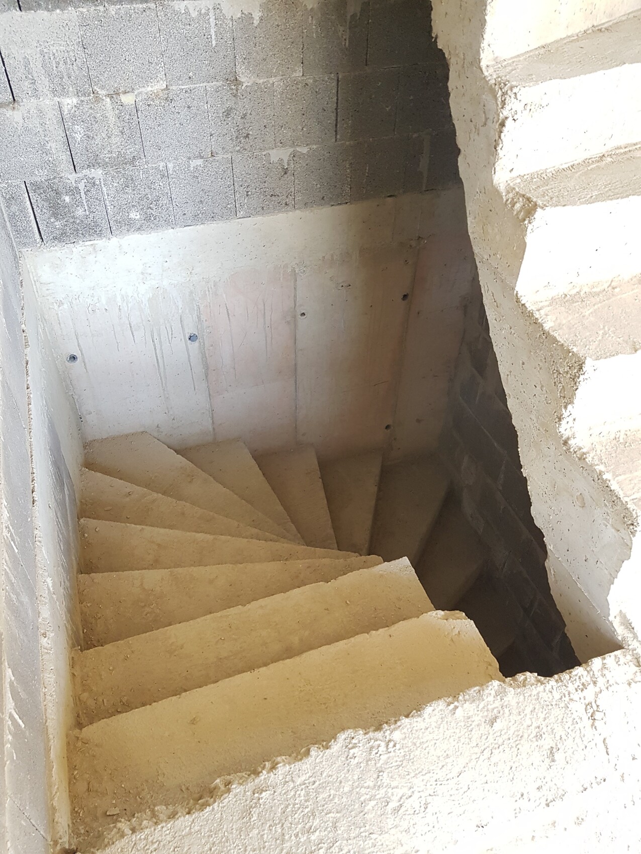

And what about the exterior window sills? The same rule probably applies to natural stone sills, right?
And what about the stairwell and the exterior stairs made of natural stone? Are they all placed before the plaster?
Photos to follow...

As announced...
Construction site with scaffolding around an unfinished concrete building, stair steps and construction containers
Raw concrete stairs in the basement, incomplete walls, construction site condition.
