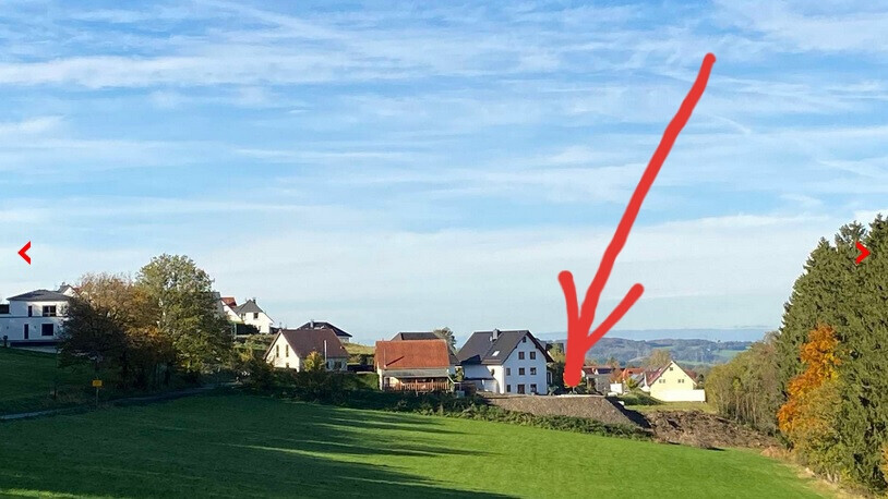

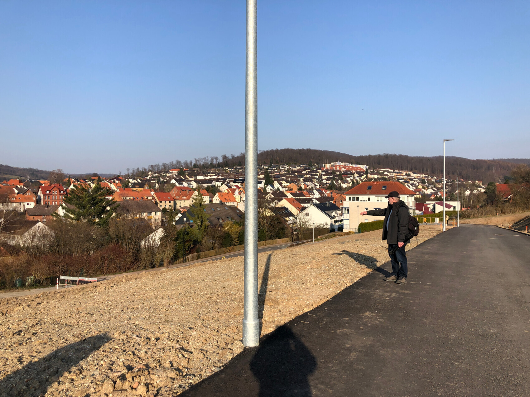

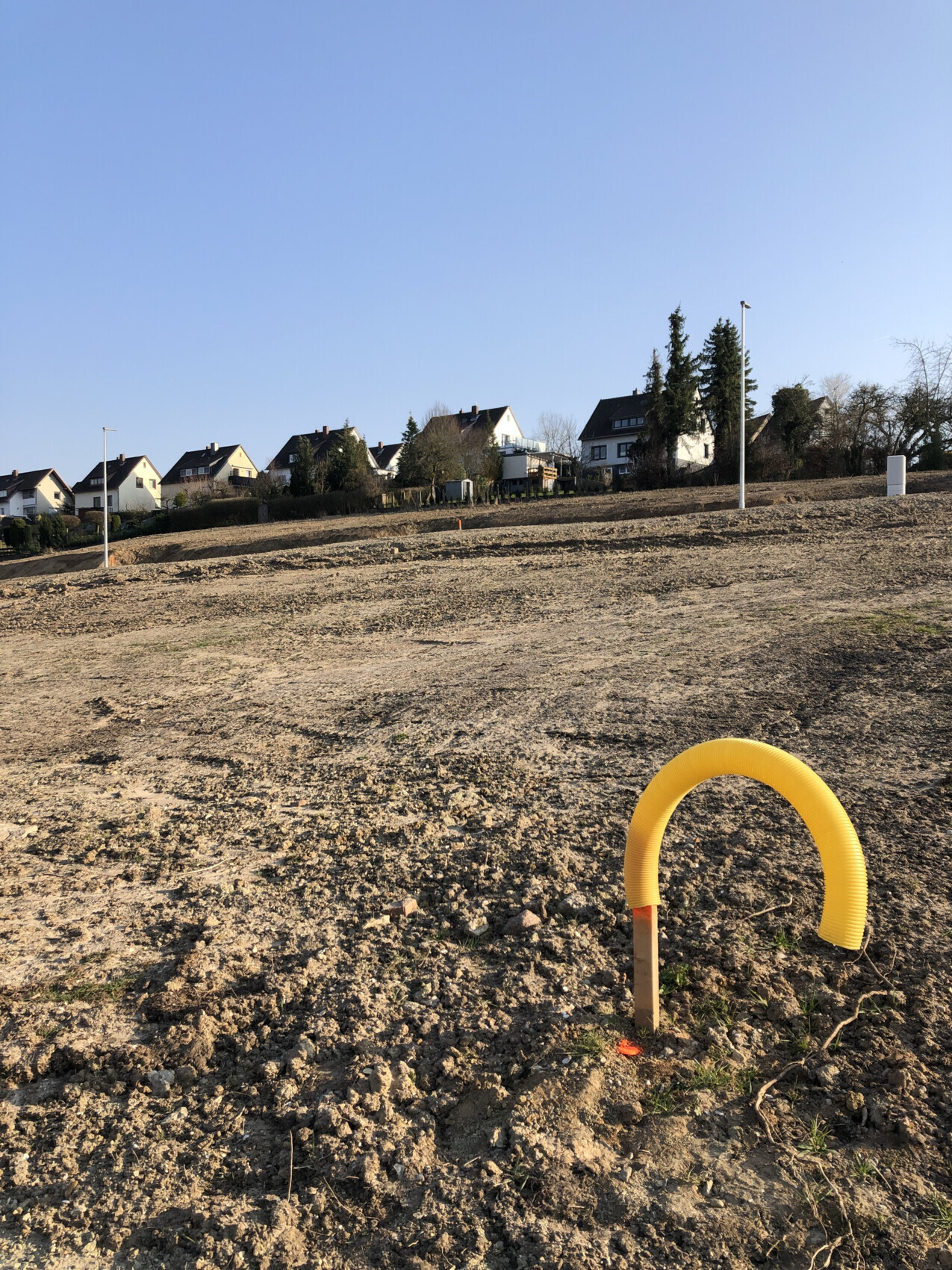

sergutsch26 Apr 2022 22:58Our building area is located on a hill, and all plots are more or less on a slope—I know what I’m talking about. I feel sorry for Clarussa, but I believe the decision for or against a basement should fairly be left up to each individual. For my part, I just want to point out that it can work without one.
Also, I think the slope on the site of @sergutsch is somewhat gentler than that of the original poster @HalloClarissa… see also another thread, for example post 48 by @gutentag… which mentions 19% slope, exactly 5.7 m (19 feet) over 30 m (98 feet).

Photo from @sergutsch… what gradient do you have?

If it’s not real yet, then surely the plans exist. I would be interested in this "structure" as well. I wanted to see the plans (natural terrain/planned terrain), not shots from 500 m (550 yards) away.
