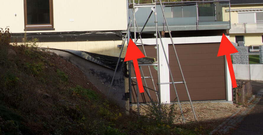

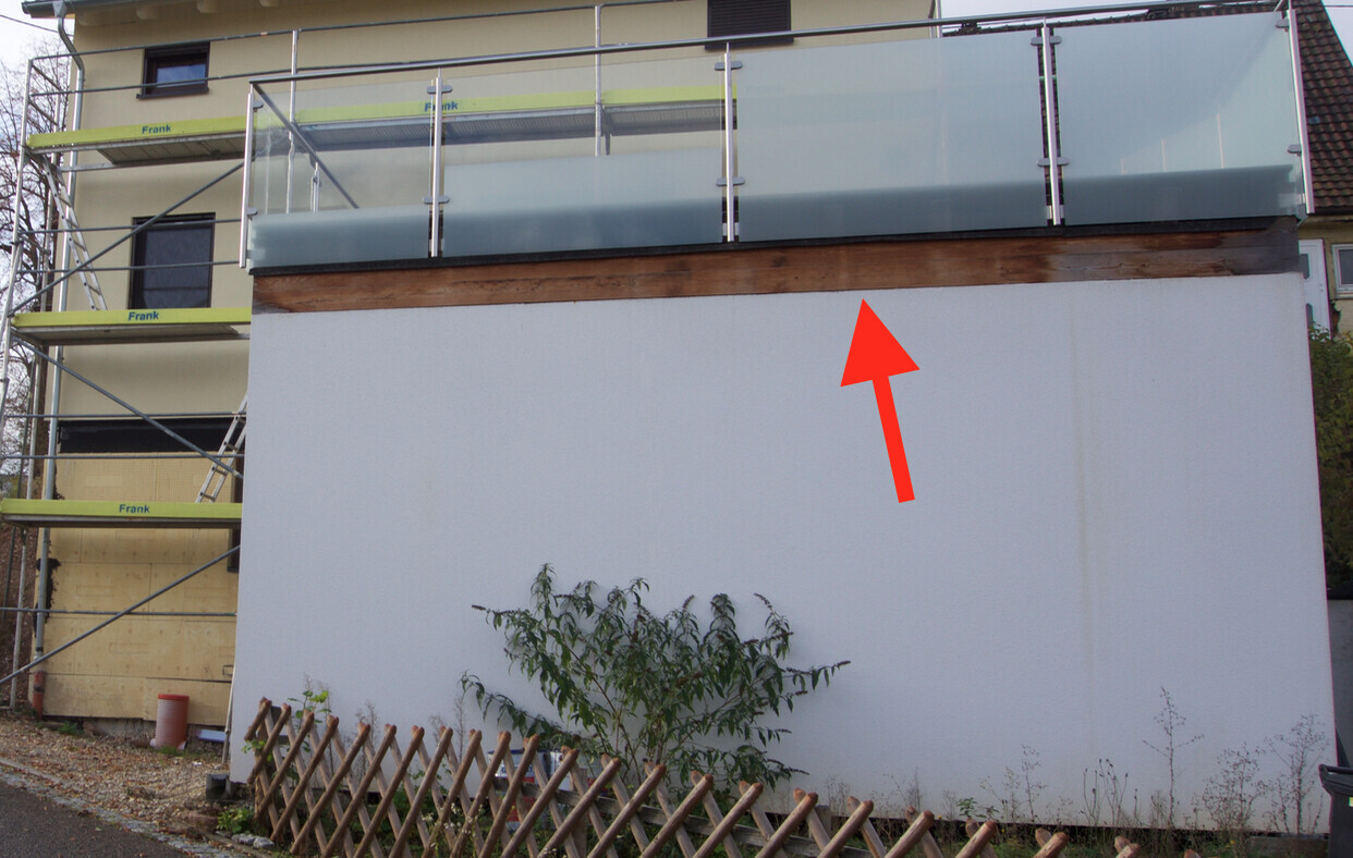

Does anyone have experience with suitable cladding for the wooden beams supporting our terrace? Would you recommend metal or wood? Is there anything specific I should consider when cladding?
Thank you very much and best regards, morey

I would install a vapor barrier there first, followed by an HC Plan strip.

So, I installed Deltamax foil as a protective layer, or you can apply a bituminous roofing felt strip, for example R500. I used it all around the house.

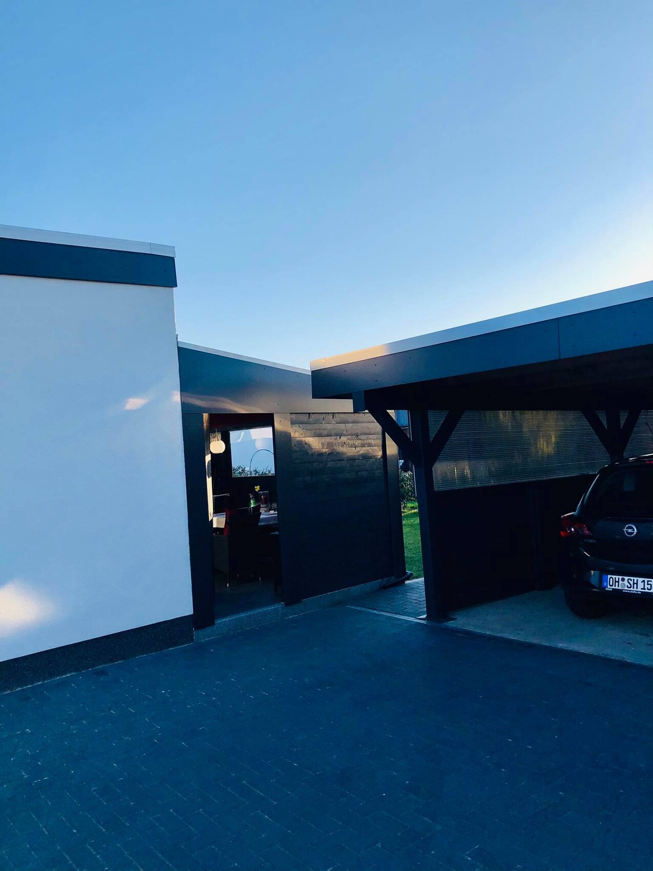

Nail the foil or the felt strip with roofing nails, and drill the HC plan strips with a 6mm (1/4 inch) iron drill bit in advance. Then attach the strips using facade screws. Alternatively, you can do it as shown in the last picture.
