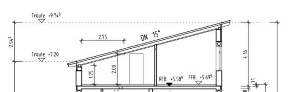

We are planning a semi-detached house in a new development area. The requirements are two full floors (attic optional) and a 20-degree pitched shed roof.
The developer has not been decided yet, but in initial discussions, they mostly suggested either an attic or an additional attic floor. Unfortunately, the attic floor is beyond our budget, and we actually find an attic unnecessary.
We had imagined leaving the space open upwards, but we were told that with a 20-degree pitch, the ceilings would end up being extremely high.
Now we are also unsure how good this will look in the end. So the question is: Does anyone have such a roof pitch and still keep the roof space open without an attic?

hampshire20 Aug 2021 10:34I have over 4 meters (13 feet) of headroom above the bed. It’s great. Roof pitch is 27 degrees.
