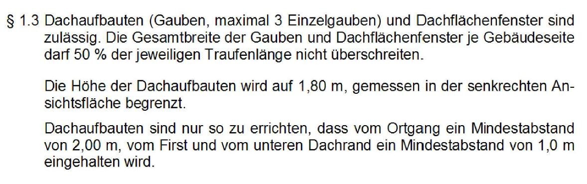

A shed dormer is not visually appealing.
The development plan specifies the following for roof structures:
