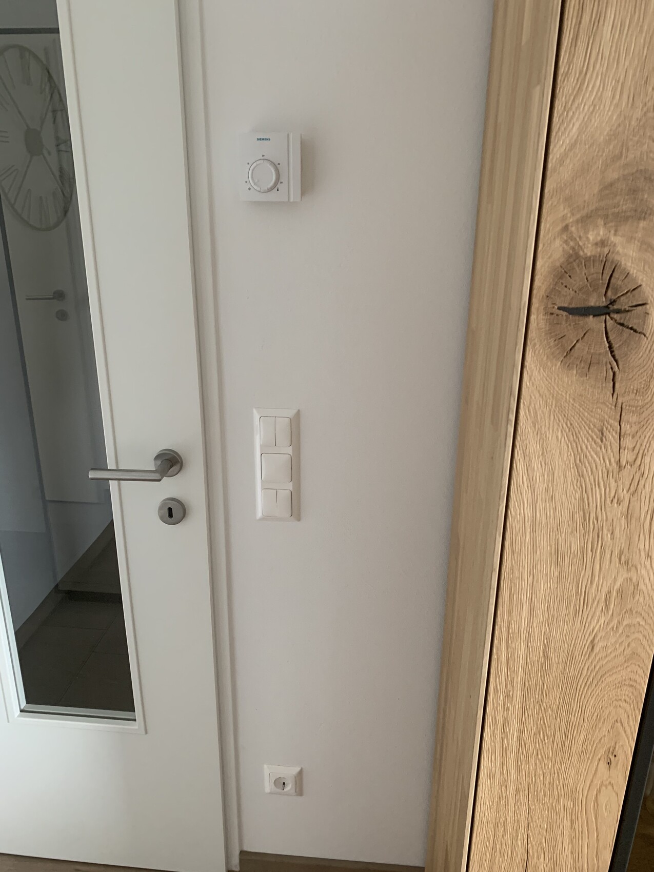

I live in a condominium where several light switches do not work.
Top left – kitchen
Top right – dining area
Center – no function
Bottom left – living area
Bottom right – no function
Is it possible that more light switches were installed than necessary?
Perhaps one of the switches controls a lamp at a wall outlet?
I find it strange that the main switch, which is quite large, is not working.

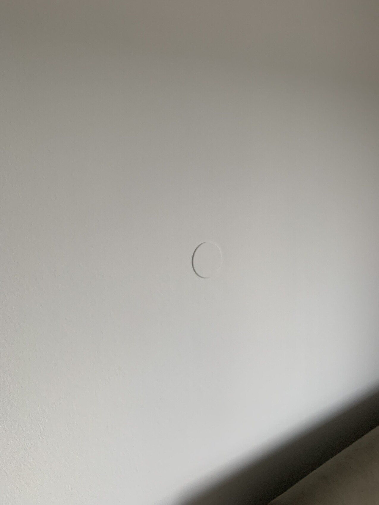

Small round indentation on a light gray wall, barely noticeable.

In our home, a ceiling light outlet was covered with a mounting box because the previous tenants (and we as well) did not need a third light fixture in that spot. Do you have something similar?
borderpuschl
1 Jun 2021 23:29
I assume these are 5-core lighting cables, where currently only one “channel” is switched. However, you need to check this carefully to be sure; at the moment, everything is just speculation.

The second picture shows an additional wall/ceiling outlet, right?
That is exactly what it is there for.
