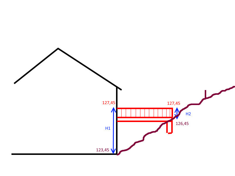

I would like to build a large projecting balcony on the north wall, with a balcony door installed in the wall so that the balcony would be accessible from the first floor (1st floor). The balcony should be about 5 meters (16 feet) deep and 5 to 7 meters (16 to 23 feet) long. After about 5 meters (16 feet) in depth, the balcony would meet the slope. Would this be allowed?
The property boundary would still be about 3 meters (10 feet) from the balcony edge, and regarding the natural ground level, the balcony at its outer end would be practically at ground level, like a terrace.
How would the required setback distances / building distances be calculated in this kind of situation?

Anne1234 schrieb:
Would that be allowed? The question is a bit too general. However, with a 3m (10 feet) setback from the property line, I don’t see any issues with setback regulations or neighbor-related laws.
Anne1234 schrieb:
How are the setback distances calculated in such a case? For North Rhine-Westphalia (NRW):
(H1 + H2) / 2 * 0.4 = (Parapet height1 – Ground height1 + Parapet height2 – Ground height2) / 2 * 0.4 = (127.45 – 123.45 + 127.45 – 126.45) * 0.2 = 1.0, minimum 3m (10 feet)
