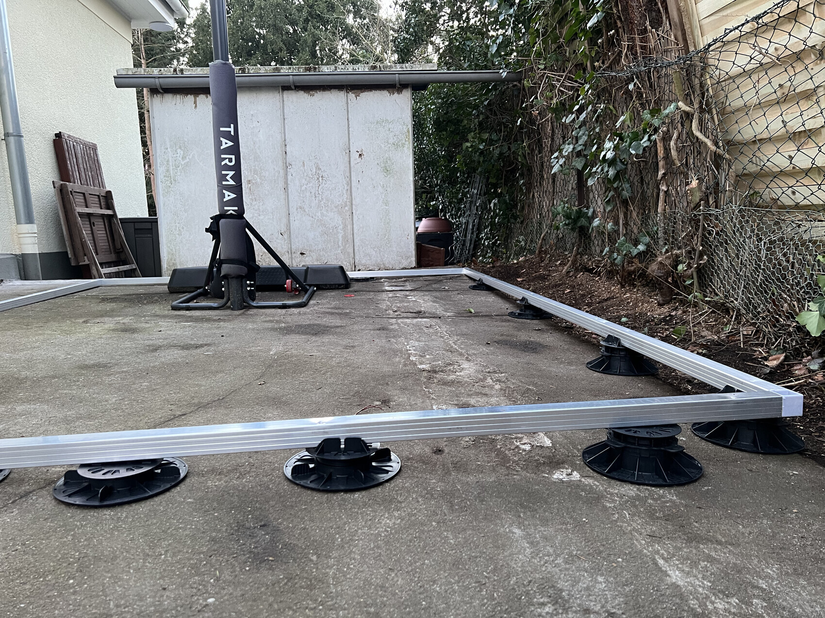

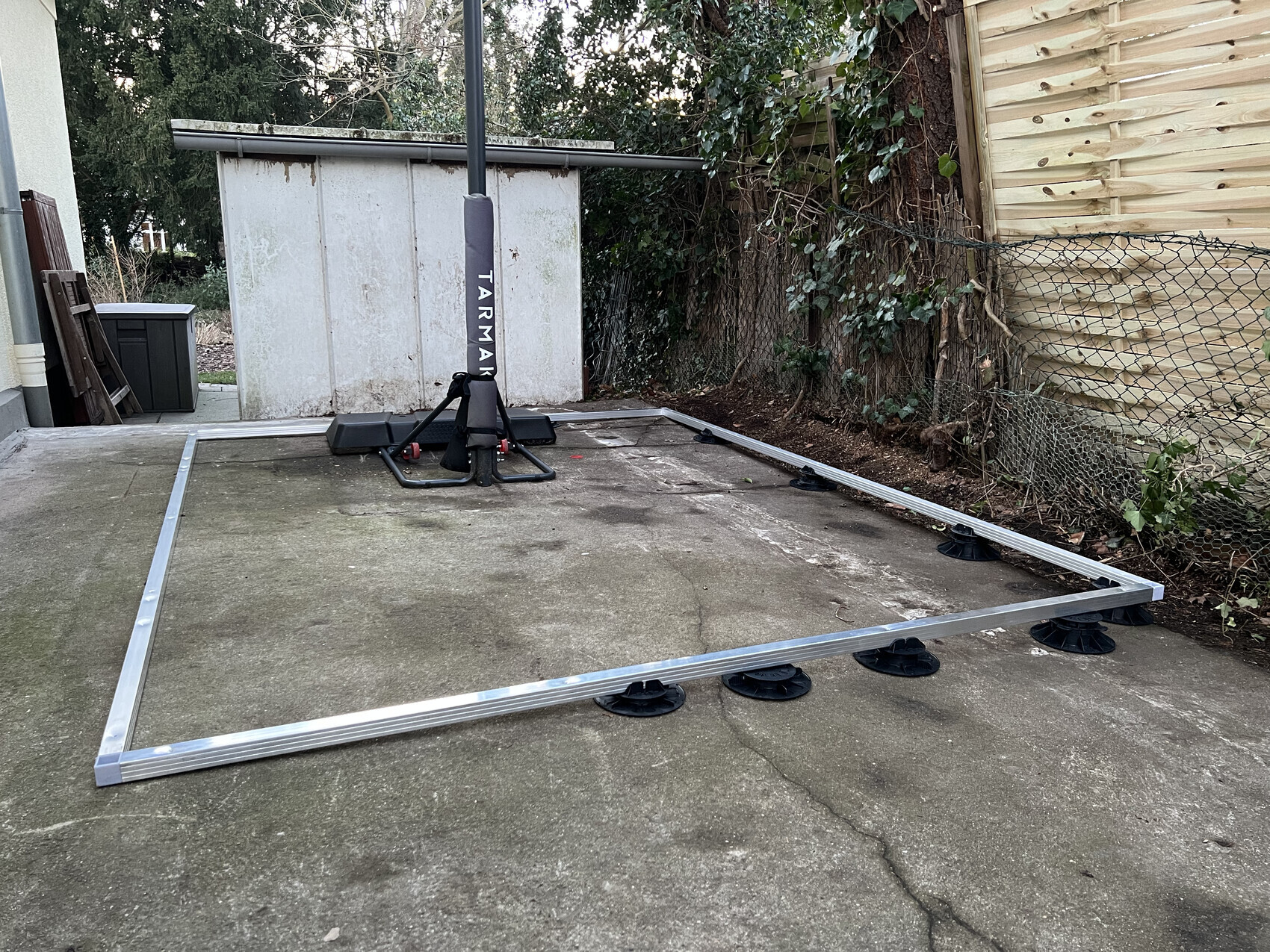

kuefra_ber28 Jan 2024 21:40Hello. Thank you for the feedback so far. I have now ordered the floor frame to try out some solutions and to see how big the height difference actually is. It is 7 cm (2.8 inches). After consulting with the home improvement store, we have decided against using leveling compounds and similar methods due to the effort and cost involved. A solution using adjustable deck supports from the terrace sector seems to be the most suitable. The frame would be secured to the concrete with anchor bolts to ensure wind resistance.
Do you see any problems with this solution?
