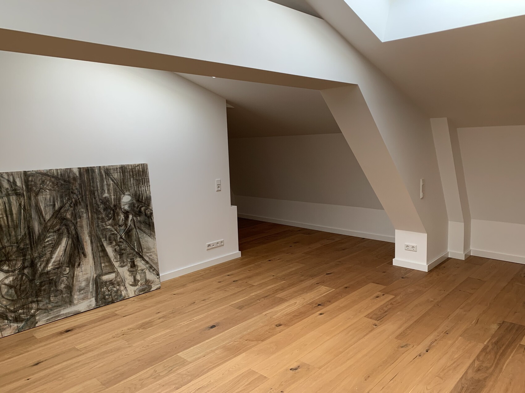

How many rooms and square meters are we talking about that need Wi-Fi coverage? Thanks for the detailed answer. So of course not Wi-Fi in every room but only over two floors plus LAN for TV, about 180m2 (about 1900 sq ft), very open floor plan. If I understand correctly, this means I need a Unitymedia technician to install a splitter and amplifier for my Connect Box connection? Then patch switch and access point and it's done.

//Edit: Okay, I understand now that it is a condominium. Yes, it is an open-plan loft in a former factory! Newly renovated!
