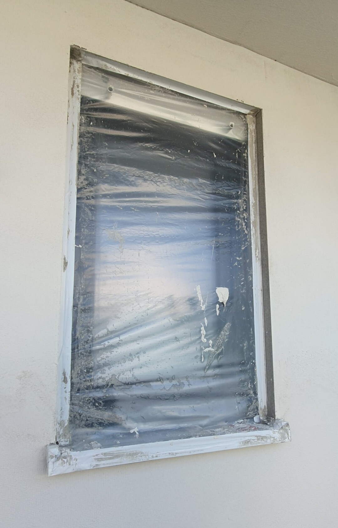

I visited a construction site yesterday, and by chance, the plasterers were working on the exterior plaster.
The roller shutter tracks were plastered over.
I am wondering how it will be possible to replace or repair the roller shutters later if the tracks are embedded in the plaster.

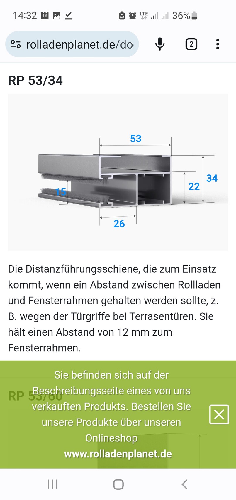

I also found a guide profile with a spacer, but I am still unsure whether the roller shutter tracks should be installed before or after the exterior plaster.

In our case, the guides were also integrated into the plaster. But who knows, maybe there are different designs. However, this should be explained by the window installer, not the plasterer...

In our case, the guide rails were plastered over too. But who knows, maybe there are different designs. This should be clarified by the window installer, not the plasterer... There are also boxes with an external access panel. I have considered this option because of the thermal bridge issue despite insulation in the lintel box. This might be practical for bungalows, but it is absolutely impractical for upper floors—unless you don’t mind setting up scaffolding to access it for maintenance.
Embedding the rails in plaster makes sense to me, as internal access for maintenance is possible. If there is an issue with the shutter curtain, you usually have to completely unthread it to replace individual slats. I also think it looks better that way.
