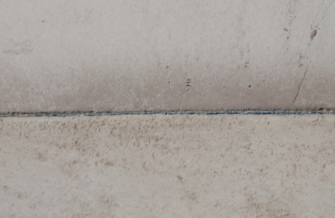

Teimo198826 Jul 2025 09:47If the plaster now connects to the screed, you have a sound bridge. This is a disaster. It should be separated at this point. I consider the other issues not to be serious.
Teimo198827 Jul 2025 19:33MST2025 schrieb:
Thanks for the feedback!
It mostly looks like in the attached photo. So even with the edge insulation strip cut off, there would still be a separation between the screed and the plaster, and no sound bridge should occur, right?Yes, that looks fine. The flooring installer would have cut the edge strip off anyway....Hello,
