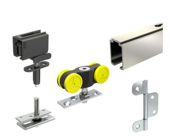

Picture 1 shows an image from eBay (the fittings can be purchased there, but the panels need to be sourced separately).

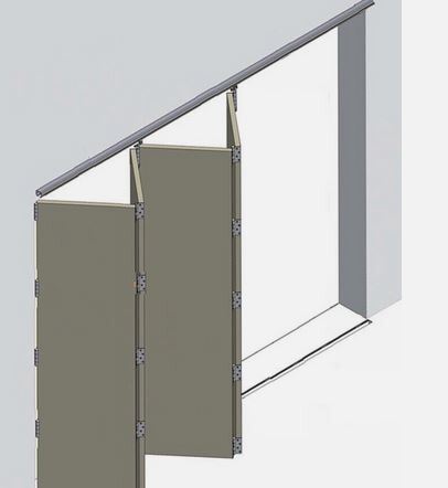

Picture 3 shows a supplier selling the fittings but unfortunately does not show a picture of the finished version.

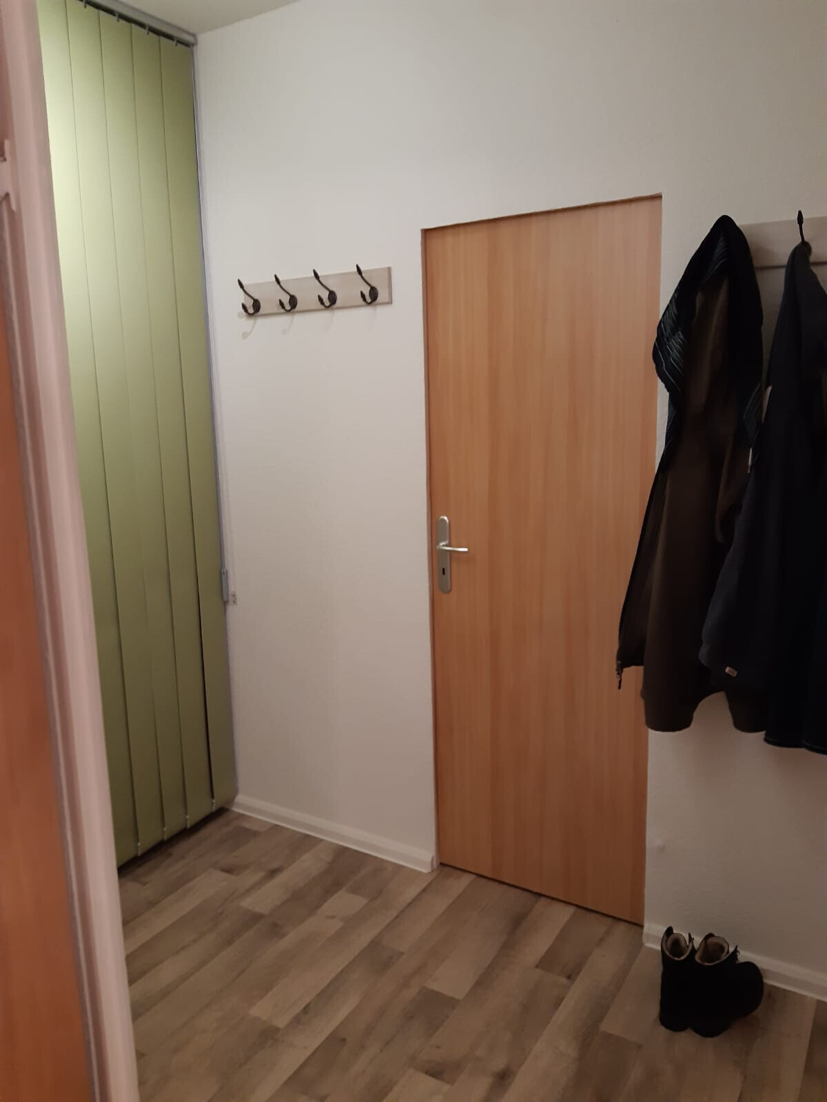

Picture 4 I just found while searching for examples and it is probably in the style that @ypg mentioned.

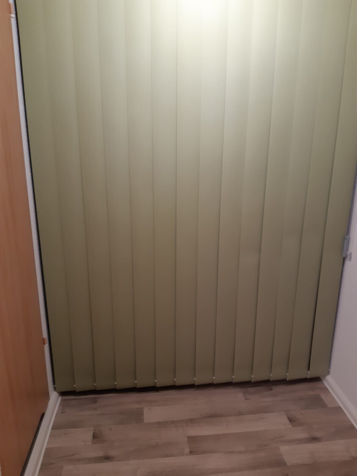

Is the niche opening in your case full ceiling height or only about door height?
To show you the vertical slats, which have the advantage that when open (unfortunately I don’t have a picture of that), they do not protrude into the room:

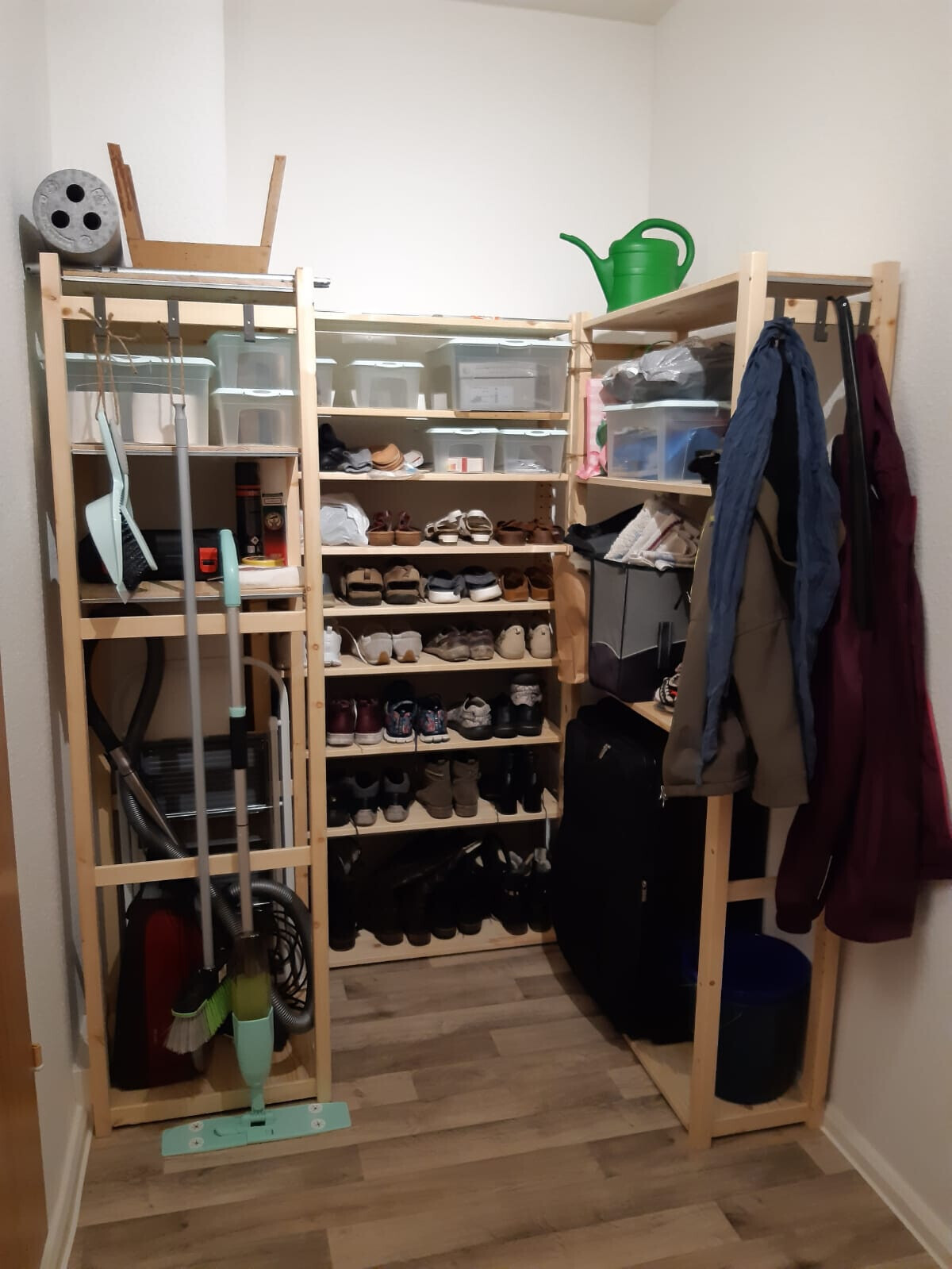

This is the niche before the vertical slats were installed:
And here you can see the slatted curtain at full height, unfortunately not at full width because the hallway is too small, so this is just a second section

Sonnenseite1221 Jul 2025 21:05kbt09 schrieb:
Is the niche opening in your case from floor to ceiling or just about door height?
Floor to ceiling… I like that. And it doesn’t flap around so much that it becomes annoying?
