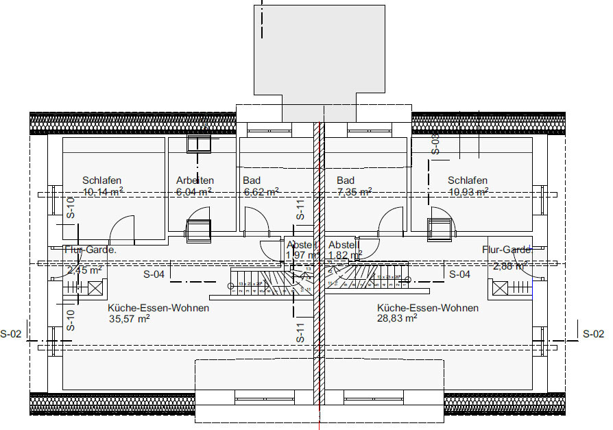

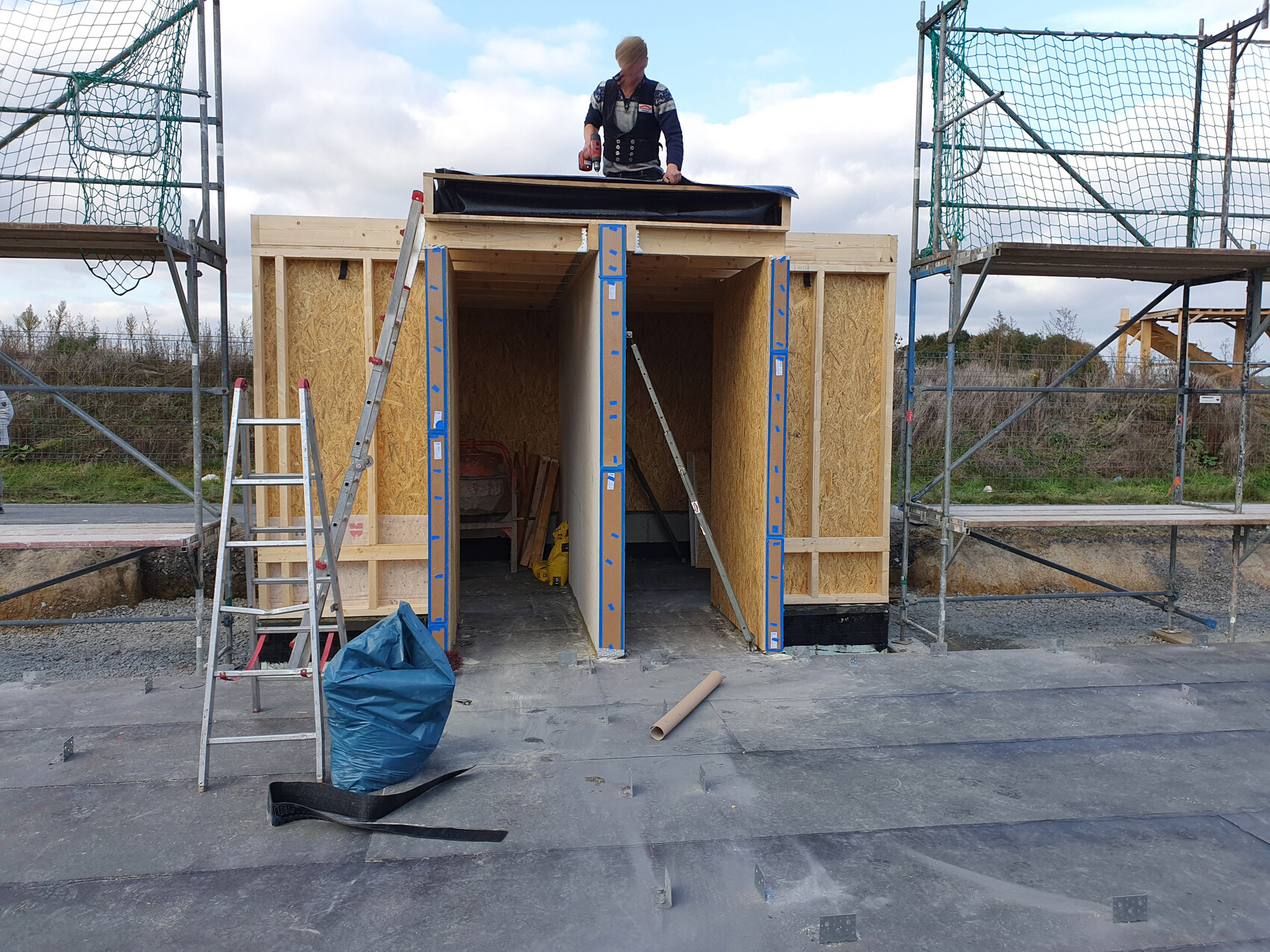

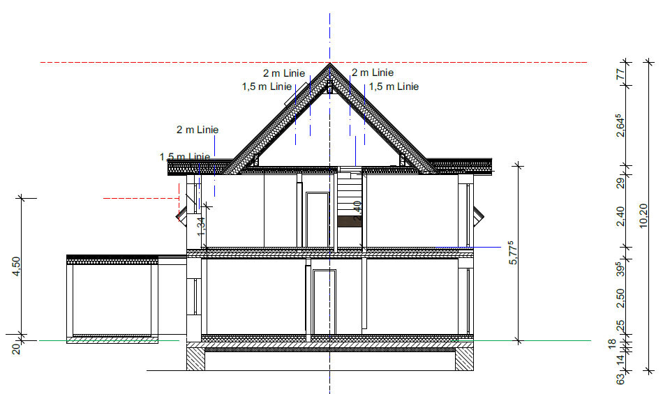

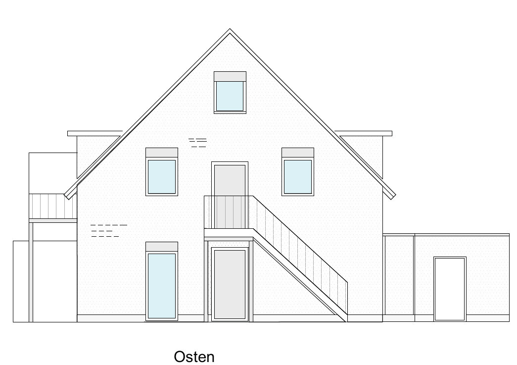

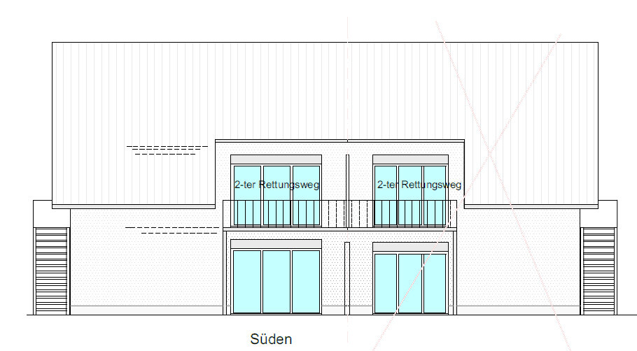

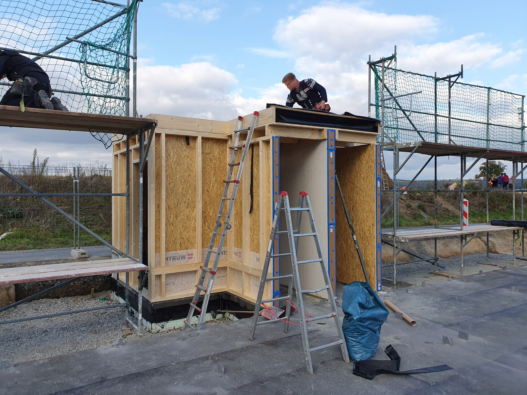

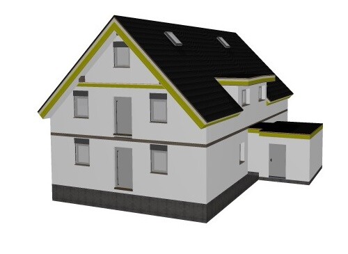

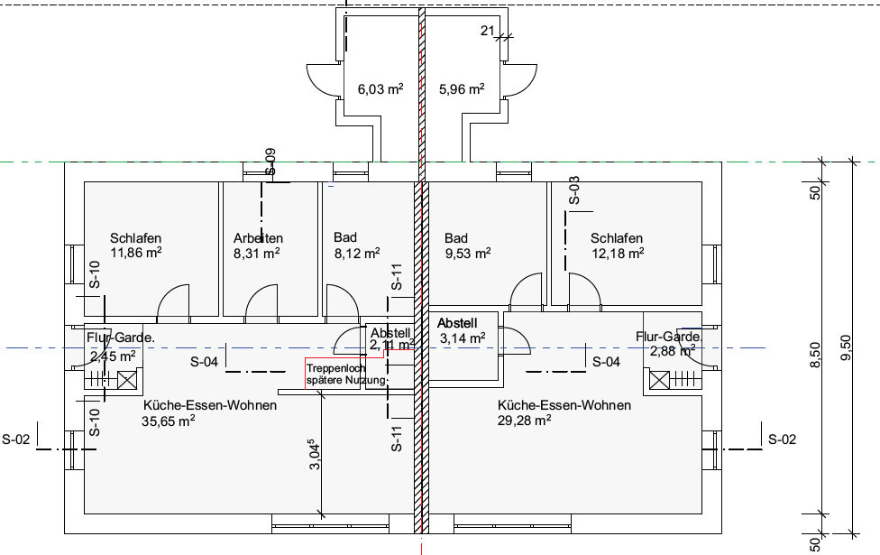

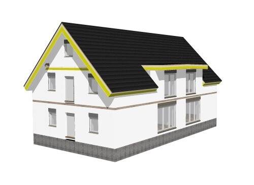

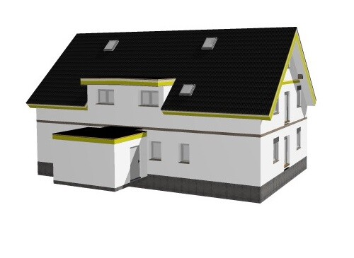

Here you go – I have left out the attic. You can see into the utility rooms from the concrete slab of the main house, which has not yet been erected:
Depiction of a two-story house with a pitched roof, external staircase, and several windows (east view).
South elevation of a two-story building with central entrance and ‘2nd emergency exit’ sign
Floor plan of a semi-detached house: two residential units with bedrooms, kitchen-dining-living area, bathroom, storage.
Mirror-image residential units in the floor plan, central staircase, kitchen-dining-living area, bedroom/bathroom.
Section through a two-story house with roof structure, interior space, dimension lines.
Construction site: wooden structure under assembly, one person standing at the roof edge, ladders and scaffolding around.
Construction site: timber frame construction, worker on the roof, ladders and scaffolding nearby.
Two-story house with black pitched roof, yellow trim, and extension.
Two-story white house model with black pitched roof, gray foundation, and yellow trim.
Two-story house with black pitched roof, garage, white walls, and yellow trim.
Sunshine387
6 Sep 2023 19:57
Very well executed. Many well-designed rooms created in a small space. Respect. The zoning plan was fully utilized. That’s something investors also do in my area’s development zone. This results in what appears to be a four-story building nearly 12 meters (39 feet) high on a multi-family plot with only two actual floors. No eave height was specified, so the ground floor is essentially a garage and stairwell (less than 2.2 meters (7 feet) high), with two full floors above and a recessed penthouse level on one side. The neighbors in their single-family homes are thrilled. But smart planning pays off. On a 680 square meter (7,325 square feet) lot, they managed to build 5 apartments ranging from 70 to 130 square meters (750 to 1,400 square feet).
