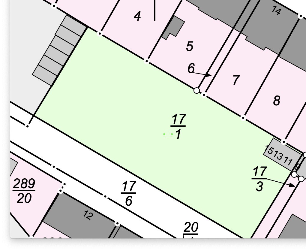

nordanney4 Mar 2020 11:00Vitalio schrieb:
Criticism and suggestions are welcomeSite plan?kaho674 schrieb:
Site plan?The plot measures 65 x 28 meters (213 x 92 feet).
The plan is to build three semi-detached houses.
