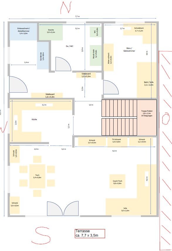

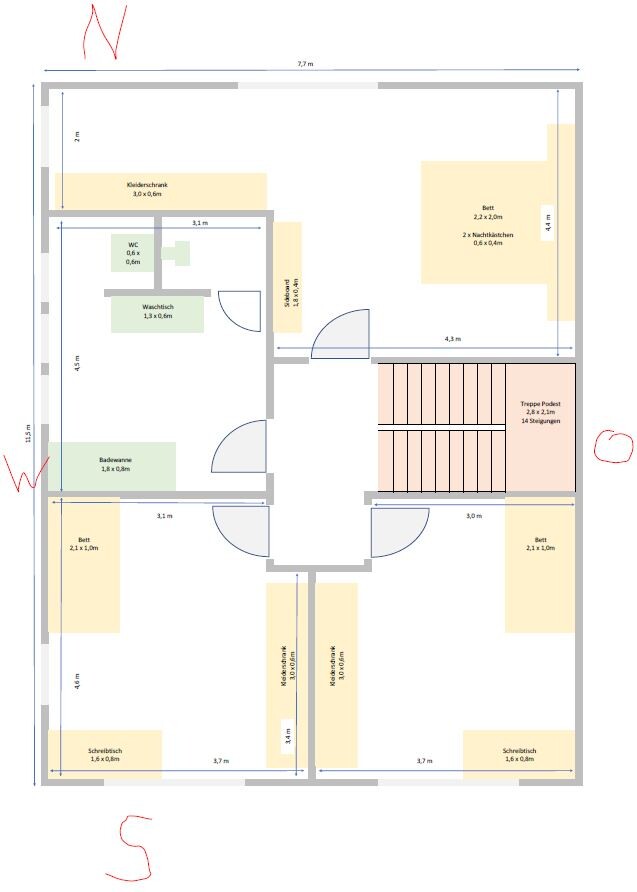

For our upcoming building project, I am mainly looking for ideas and support regarding the optimal use of our site conditions.
The floor plans for this semi-detached house were initially created by myself. However, I have since incorporated a lot of input from architects, building planners, online resources, and example floor plans. The plot measures 11 x 28 meters (36 x 92 feet). To the east, an adjacent plot is zoned for another semi-detached house. This house needs to be shifted about 2.5 meters (8 feet) south because the northern property line runs diagonally. Both semi-detached houses will be built by the same construction company at the same time.
The kitchen should have an open feel but also be closable when needed. I imagine glass sliding doors running along the outer walls. We are not fans of fully open-plan kitchens, so a completely open living-dining-cooking area is ruled out.
I find the access to the living room through the kitchen to be problematic. It feels too convoluted to me. However, a door from the hallway directly into the living room would reduce the necessary usable space in the living area.
The staircase, as currently planned, would theoretically comply with DIN standards (calculations only, not yet discussed with a staircase specialist). Whether that is desirable is another matter. Perhaps there is a better solution here?

Sebastian202127 Jan 2021 16:59Hello 11ant,
Thank you for your response. That is correct, the walls are only meant to be symbolic. At this scale, every 10cm (5 inches) represents the walls. I will adjust the wall thicknesses as you suggested, which I have already done with other designs.
This sketch should primarily serve as a basis to evaluate the floor plan regarding practicality.
We are in discussions with the neighbors, and we will agree together on a company, planner, and building supervision. Anything else would not make sense.
Attached is the questionnaire.

Sebastian2021 schrieb:
This sketch should primarily serve as a basis for evaluating the floor plan in terms of practicality.That’s why I made my earlier comment – especially since you’re already planning with real furniture instead of the model furniture from the house providers. As mentioned, you will need to consider tolerances anyway, but even moving symbolic sample walls can noticeably affect the calculations.https://www.instagram.com/11antgmxde/
Yes, I agree ... it already doesn’t work with a ground floor width of 770 cm (25 ft 3 in).
A site plan would also be helpful, ideally showing the planned house.

I find a platform staircase with only 14 risers to be risky:
What width are the indicated interior doors, especially on the upper floor? 80 cm (31.5 inches)? It’s better to plan for 90 to 100 cm (35 to 39 inches).

Sebastian202127 Jan 2021 20:36Hello kbt09,
the parking spaces are located outside the property, so I don’t need to worry about that for now. I can still adjust the plot and the house location.
All doors are planned to be 90cm (35 inches) wide. The front door is 110cm (43 inches).
The overall external dimension is indeed 770cm (8 yards). This makes it extremely tight. It is only possible with a reduced tread depth of about 25cm (10 inches), or by reducing the landing depth to 80cm (31 inches). Of course, I don’t want a staircase that you use every day and get annoyed with every day. I would appreciate further experiences and suggestions from you.
Therefore, I think planning a half-turn staircase would at least be simpler.
