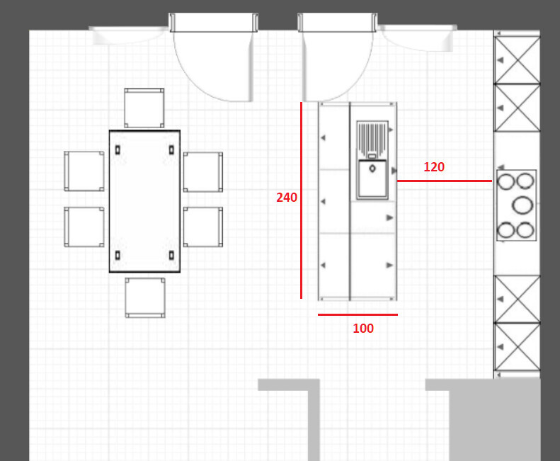

I really like the ground floor as it is—I wouldn’t change anything. The argument that you have to carry groceries farther isn’t really an issue. You’re not hauling large amounts of groceries into the house multiple times a day. Besides, there is also a door from the dining area to the left side of the plan.
In the dining area, I would suggest a single panoramic window, 201cm (79 inches) wide, and use the 101cm (40 inches) wide window as a door instead. Panoramic windows tend to create more of a “wow” effect than divided windows.
The kitchen fits perfectly, as does the dining table. In the example, the table measures 90 x 180cm (36 x 71 inches), but a larger table would also fit.
Only the garage, I would move further down towards the bottom of the plan, because it’s not very pleasant to always stare at a long wall while dining. Adding some greenery could help with that.
I also really like the upper floor and would keep it as is. Having the parents’ bedroom next to the child’s room isn’t ideal, but a suitable partition wall should solve that problem.
My daughter has a shower in her 250m2 (2,690 sq ft) house that is only 80cm (31 inches) wide and 120cm (47 inches) long. However, there is also another, larger shower.
