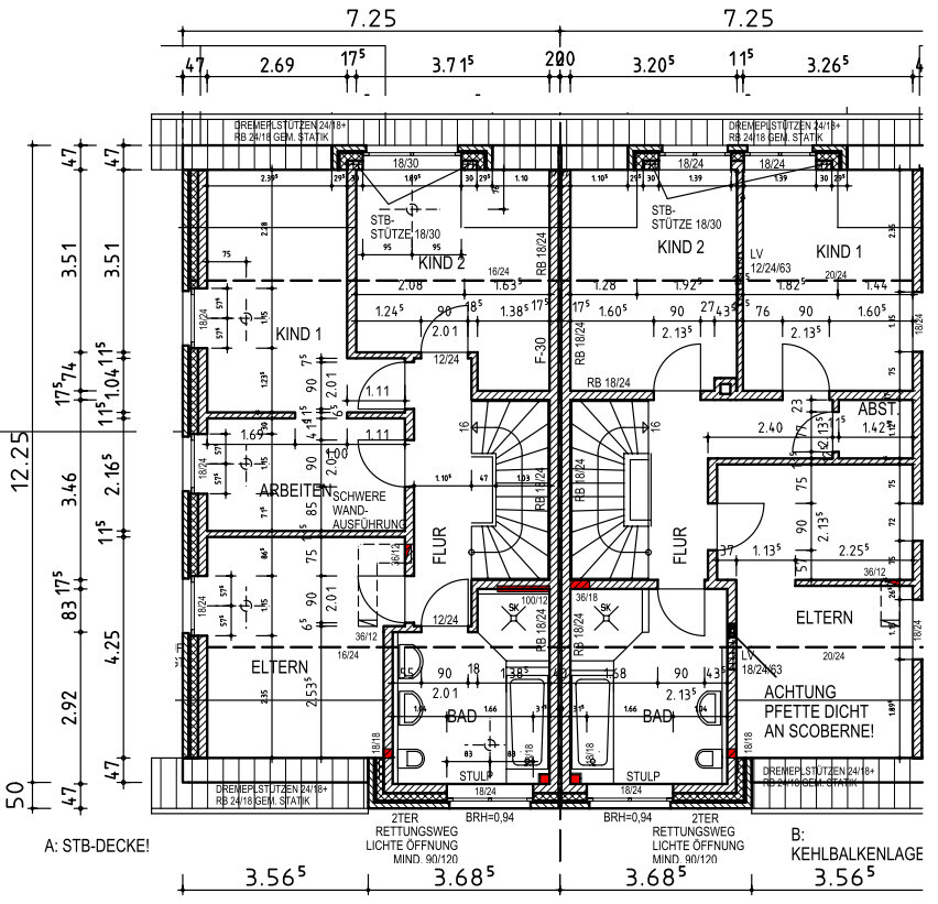

hm... we also have a semi-detached house with about 145 sqm (1,560 sq ft), but we don’t have a basement and there are three of us living here. That’s why on the ground floor we have a utility room and the heating and ventilation systems are located in the attic.
Here for comparison are our upper floor and our neighbors’ upper floor; they have two children.
Floor plan of a house with CHILD 1, CHILD 2, PARENTS, BATHROOM, HALLWAY, stairs
I have to say, I find your price quite ambitious...
kaho67430 Mar 2020 07:55
Müllerin schrieb:
Here for comparison, our upper floor and the neighbor's upper floor—they have two children
What is your knee wall height, and how is the bed positioned? How much space is there next to it?
