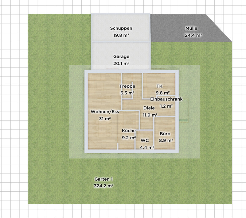

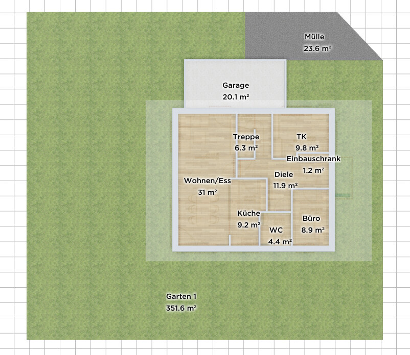

We like the following about the floor plan:
- Home office on the ground floor
- 3 children's rooms, similarly sized (which doesn’t seem very common in standard floor plans under 150sqm (1600 sq ft)
- Overall fairly compact, without the living area being disproportionately small
- Shower bathroom on the ground floor
- With the option of larger doors in the dining area, quite a lot of light from the south and west
- Entrance hall about 18sqm (190 sq ft), adequately sized in my opinion, storage under the closed staircase
- Utility room sufficiently large, assuming the heating system is not inside the house (district heating via the central heat pump)
We would close off the area between the entrance hall – living room – entrance hall – kitchen.
Cons:
- Despite a knee wall height of 1.20m (4 feet), quite a lot of sloping roof (the houses further east in the development have a ridge height of 6.5m (21 feet), ours is only 4.5m (15 feet))
- No converted attic – overall relatively little storage and usable space
I was thinking about having the seller handle the backfilling.

I think the 35-165 is quite good: with some modifications, it could become a nice house for 5 people.

Most enclosed parking spaces are not permitted. On very small plots, they usually are allowed after all.
Meanwhile, the driveways are regulated very strictly.
Mangolicious schrieb:
There is a floor plan with a utility room; I would rotate (and mirror) the house so that the entrance faces east, remove the then northern window in the study, and add a small carport next to the bin storage. The nice living-dining area would still face southwest. I wouldn’t mirror anything. Everything is already where it should be. Just swap the utility room with the office. Kitchen by the terrace, TV/sofa can be placed facing north.
With three children, I wouldn’t neglect the yard, at least for the vehicles and such. My shed is enclosed, but it could also act as a windbreak to the east at the bottom of the plan… or put the carport and shed further to the left on the plan.
