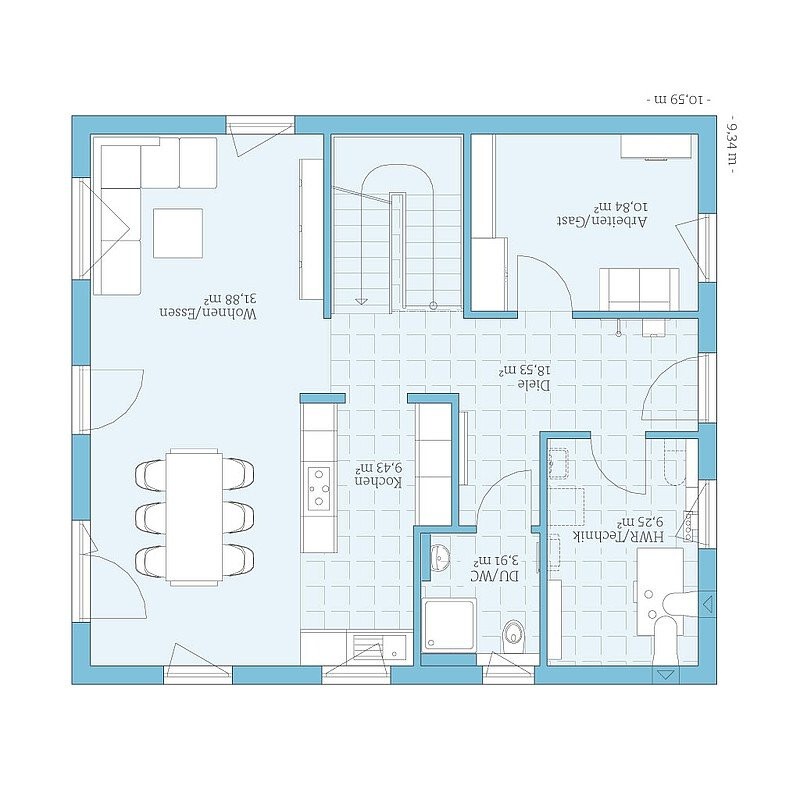

There is no utility room planned. Then with a basement?

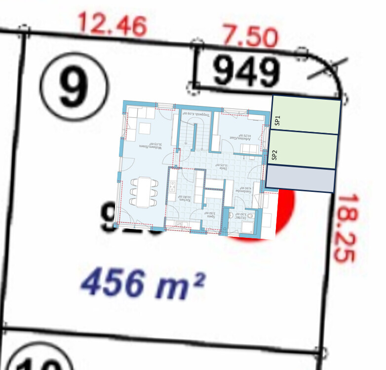

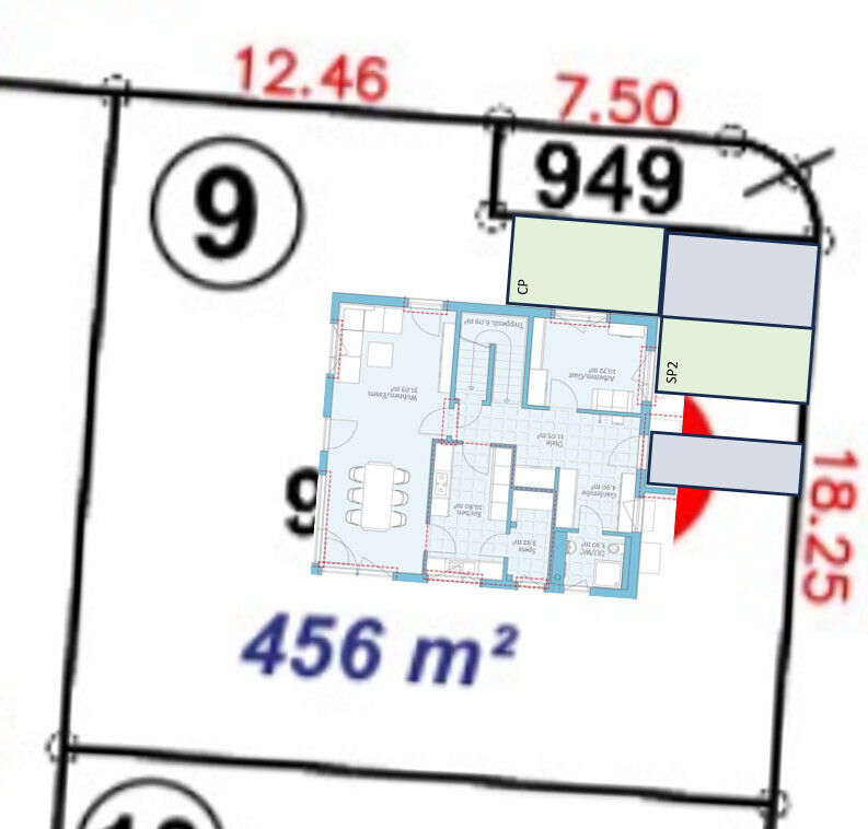

There is a floor plan with a utility room; I would rotate (and mirror) the house so that the entrance faces east. The northern window in the study would be omitted, and a smaller carport placed next to the bin storage area. The nice living-dining area would still have a south-west orientation.

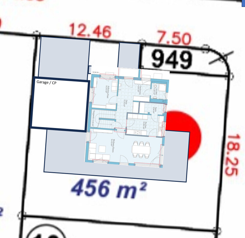

Mangolicious2 Oct 2024 14:29Attached is the corresponding floor plan.
The idea was to position the main entrance slightly more towards the east, with a small carport ending just before the living room window. In front of it is the parking space, so that not too many square meters of the front garden are lost (meaning no parking space directly in front of the house).
I am not sure what the legal requirements are regarding parking spaces.
This layout allows for some garden area on the sunny, window-rich south and west sides, with the boundary to the bin storage area marked by the carport.
